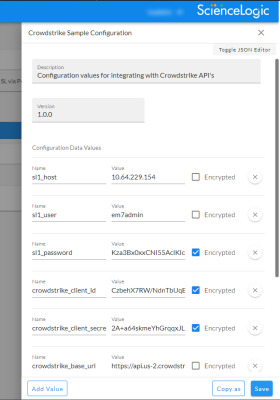

For this SyncPack, you should make a copy of the "CrowdStrike Sample Configuration" configuration object, which is the sample configuration file that was installed with the CrowdStrike Falcon Automation SyncPack.
The "CrowdStrike Sample Configuration" configuration object contains all of the required variables. Simply update the variables from that object to match your SL1 and CrowdStrike settings.
To create a configuration object based on the "CrowdStrike Sample Configuration" configuration object:
  1. In the PowerFlow user interface, go to the Configurations page ().
  2. Click the Actions button () for the "CrowdStrike Sample Configuration" configuration object and select Edit. The Configuration pane appears:

  1. In the Configuration Data field, update the default variable definitions to match your PowerFlow configuration:
  • sl1_host. Type the hostname or IP address of the SL1 system the alerts will synchronize with.
  • sl1_password. Type the password for your SL1 system.
  • sl1_user. Type the username for your SL1 system.
  • crowdstrike_url. Enter the URL for your CrowdStrike system.
  • crowdstrike_username. Type the username for your CrowdStrike system.
  • crowdstrike_password. Type the password for your CrowdStrike system.
  • job_name. Type the name for your CrowdStrike job.
  • receiver_mail. Type the email address that you want to receive updates on SL1 events and your CrowdStrike jobs.
  • sender_mail. Type the email address that you want updates on SL1 events and your CrowdStrike jobs to send from.
  • sender_mail_password. Type the password for the sender email address that you entered.
  • mailserver. Type the server for your sender email.
  • mailserverport. Type the port for your sender email.

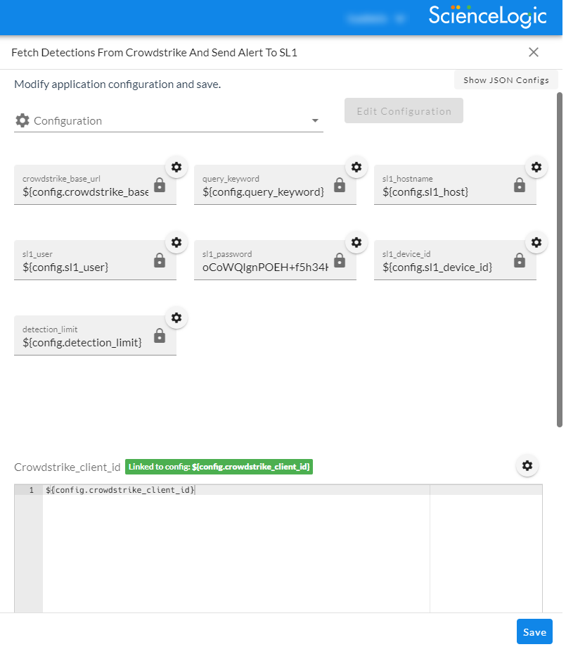

Aligning a Configuration Object and Configuring PowerFlow Applications
With this SyncPack, you can create SL1 events based on CrowdStrike jobs. You will need to align the CrowdStrike Falcon Automationapplications with the relevant configuration object in PowerFlow, and, if needed, update any other fields on the Configuration pane for the applications.
To align the configuration object with the relevant PowerFlow applications:
  1. On the Applications page of the PowerFlow user interface, open one of the PowerFlow applications listed above and click Configure (). The Configurations pane for that application appears:
An image of the Configure Application page.
  1. From the Configurations drop-down, select the configuration object you want to use.
    The values for sl1_hostname and the other parameters that appear in the Configuration pane with a padlock icon () are populated by the configuration object you aligned with the application. Do not modify these values. If you encounter an error, make sure your configuration object is configured properly.
  1. Click Save to align that configuration with the application.
