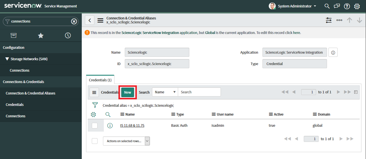

  1. Navigate to Connections & Credentials > Credentials. The Credentials page appears.
  2. Click New.
  3. Select Basic Auth Credentials. A new Basic Auth Credentials record appears.
  4. Complete the following fields on the new record:
  • Name. Type a unique name for the credential. Required.
  • User name. Type the ServiceNow user name.
  • Password: Type the ServiceNow password.
  1. Click Submit to save the new record.
  2. After the record is saved, open it again and check the Active field on the record.
  3. Click Update.

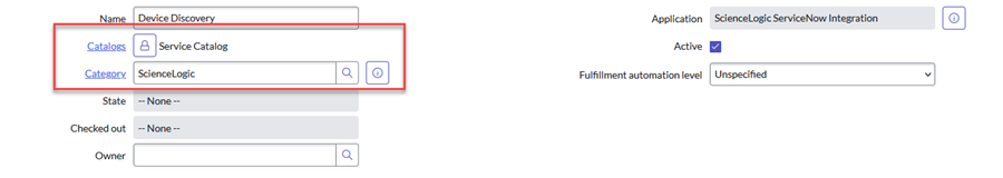

Configuring a ServiceNow Service Request for Discovery Sync
Before you can run a Discovery Sync, you need to configure the catalog and category values in the ServiceNow service request forms. You also need to activate the "Device Discovery" service request in ServiceNow.
NOTE: Because some of the fields in the service request form will only populate if you have completed the previous fields in the form, you need to complete the fields in the service request form in sequential order.
To configure the ServiceNow service requests for Discovery Sync:
  1. In ServiceNow, go to the Catalog Items page (Service Catalog > Catalog Definitions > Maintain Items).
  2. Type "ScienceLogic" in the Category column. The Device Discovery and Monitoring Removal service requests appear in the search results.
  3. Open the Device Discovery service request and ensure that the Catalogs and Category fields are accurate. For example:
    Do not set the Category to a Change Request.
  1. If you need to update these fields, click the Edit in Catalog Builder button at the top of the detail page.
  2. Update the fields and click the Update button to save your changes.
  3. From the Catalog Items page, click the check box for the Device Discovery service request and click the Activate button at the bottom of the Catalog Items window.
    This service request is instance-specific, which means that the service request will appear in the same location as the catalogs you specified for that request. In the example above, the Catalog was set to Service Catalog.

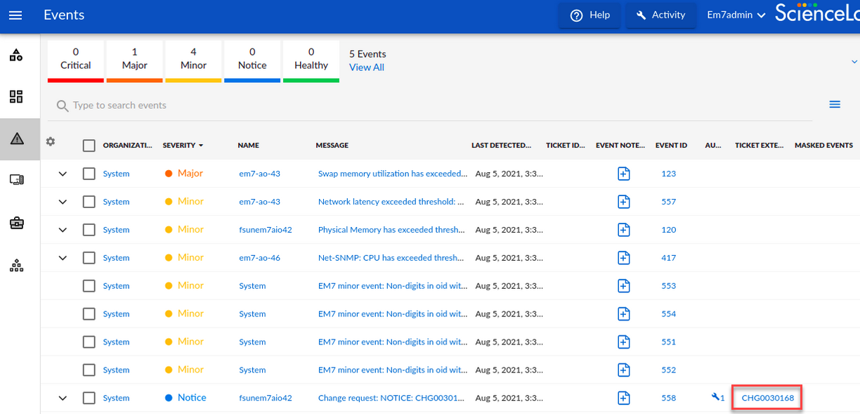

    Viewing SL1 Events for Change Requests
    When the "Create or Update Maintenance Schedule from ServiceNow Trigger" application is triggered, the application gathers data about the change request in ServiceNow and generates an SL1 Event with a severity of Notice.
    For an SL1 Event that was generated by an update to a change request in ServiceNow, you can click the link for the ticket number in the Ticket External Reference column on the Events page (or click the life-ring icon () in the classic user interface) to go back to the change request in ServiceNow:
    For more information about SL1 events, see the Events section.

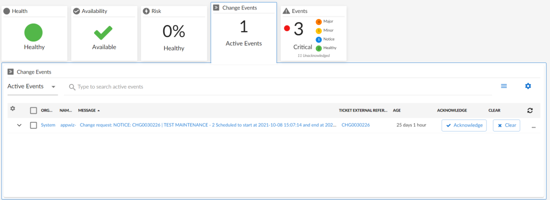

    Viewing Change Events for SL1 Business Services
    If you are using SL1 version 11.1.0 or later with the Change Events feature enabled, and the device aligned with the event is in an SL1 Business Service, the event will display on the Change Events tab for that Business Service in SL1:
    The Change Events tab displays a list of events that are created when PowerFlow pulls change data from ServiceNow, including both active and cleared change events.

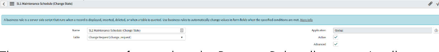

    Scheduling Device Maintenance (No MID Server)
    You can create a change request in ServiceNow to perform scheduled maintenance through a maintenance window in ServiceNow. You use the "Sync Maintenance Schedules from ServiceNow to SL1" PowerFlow application to sync maintenance windows from ServiceNow change requests (CHG)s to SL1 devices to place the synced devices into maintenance mode for the scheduled change window.
    This process does not require the use of a ServiceNow MID Server.
    PowerFlow only syncs maintenance schedules that are aligned with devices that are already synced with ServiceNow. Before setting up maintenance schedule sync, you must first sync devices between SL1 and ServiceNow using the ServiceNow CMDB  SyncPack.
    When you create a change request (CHG) in ServiceNow and sync it to SL1, the scheduled maintenance that SL1 creates has collections disabled by default. This is not configurable.
    The SL1 Scheduler supports maintenance windows of at least one minute or more.
    If you update the scheduled times in a ServiceNow change request, you will need to cancel the change request, which also cancels the maintenance window in SL1. You will then need to create a new change request with the new time window and sync that change request to SL1.

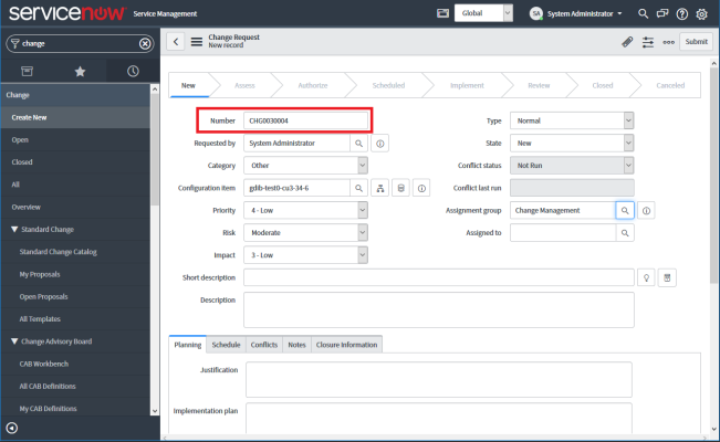

    1. In ServiceNow, type "change" in the filter navigator and navigate to Change > Create New.
    2. Click New to create a new change request of type "Normal". A new Change Request record appears:
    1. Make a note of the change request number in the Number field. You will use this later to verify that the maintenance sync was created. In this example, the value is CHG0030004.
    2. Update the following fields in the record:
    • Configuration Item. Select the CI you want to configure for maintenance sync.
    • Assignment group. Select the group for the CI.
      The aligned CI must have the SL1 Monitored field selected before the PowerFlow can use the maintenance schedule for that CI.
    1. Click the Submit button. The change request is saved, and you are returned to the Change Requests page.

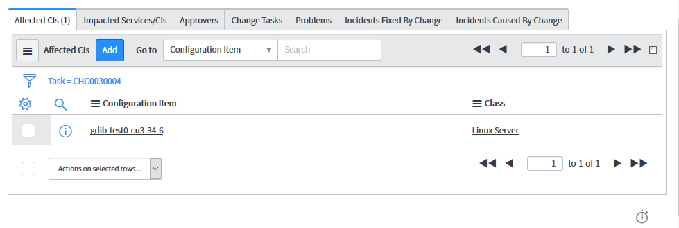

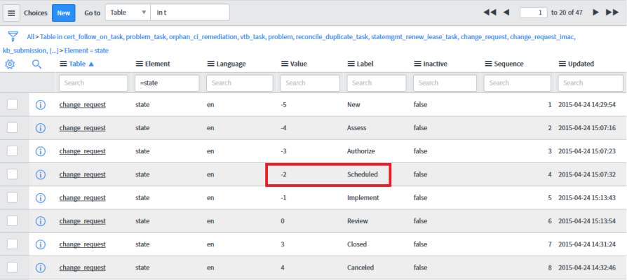

    2. Select the change request you just created, and in the change request record, right-click the State label and select Show Choice List. The Choices list displays a list of the configurable choices and values:
      You need Administrator privileges to access this list.
    1. Make a note of the values in the Value and Label fields. These values map to the New_Change_Request_State and Canceled_Change_Request_State fields in the "Sync Maintenance Schedules from ServiceNow to SL1" application.
    2. Return to your new change request and scroll down in the change request to the Affected CIs tab, where you can click the Add button to add additional synced CIs to the maintenance sync:

    4. While the "Sync Maintenance Schedules from ServiceNow to SL1" application runs, you can monitor the status of the maintenance process by clicking the branch icon () on the "Schedule Maintenance" step. Click the triggered application's run ID in the pop-up window, and then click the branch icon on the "Create SL Maintenance" or "Modify Maintenance" steps for more information.
    5. After the "Sync Maintenance from ServiceNow to SL1" application completes, navigate to the Schedule Manager (Registry > Schedules > Schedule Manager) in SL1 to view the change requests.
    1. Verify that the Schedule Summary field contains the same value from the ServiceNow Number field. In this example, the value in SL1 matches the value from ServiceNow: CHG0030004.
    2. You can also verify that the schedule was created for a device by navigating to the Device Manager (Registry > Devices), clicking the wrench icon for the device, and clicking the Schedule tab.
    3. If you want to cancel the scheduled time for the maintenance sync, open the change request in ServiceNow, click the Additional actions menu button (), and select Cancel Change. The next time the "Sync Maintenance from ServiceNow to SL1" application runs, the application cancels that maintenance sync.

    Creating a ServiceNow Credential and Credential Affinity
    Before you can set up maintenance sync with the MID Server in ServiceNow, you need to create a credential for the MID Server. You should have access to the "Integration Services" section of the Discovery Dependents page (x_sclo_scilogic_discovery_dependent) in ServiceNow, which is provided by the "Integration Services" import set.
    To create a credential to connect to PowerFlow:
    1. In ServiceNow, go to Connections & Credentials > Connection & Credential Aliases.
    2. From the Connection & Credential Aliases list, select ScienceLogic. The Connection & Credential Aliases page appears:
    1. Click New to create a new credential. The Credentials page appears.
    2. From the list of credentials, select Basic Auth Credentials. This is currently the only type of credential that is supported. The Basic Auth Credentials page appears.
    3. Complete the fields related to the PowerFlow on the Basic Auth Credentials page. Make sure that the Credential alias field is set to x_sclo_scilogic.Sciencelogic.
    1. Click Submit. The credential is added to the Connection & Credential Aliases page.
    2. Select the new credential. The Basic Auth Credentials page for that credential appears.
    3. Click New to create a Discovery IP Affinity record. A new Credential Affinity page appears.
    • MID server. The name of the MID Server you want to use.
    • IP address. Use the PowerFlow IP address that was listed in the IP field on the relevant record on the Discovery Dependents page in ServiceNow. To quickly find the relevant record on the Discovery Dependents page, right-click the Type column and select Group By Type, and then expand Type: Integration Services. Use the IP value from the record that matches the Region for the devices you want to use.
    • Credential ID. This field should be completed for you.
    1. Click Submit.

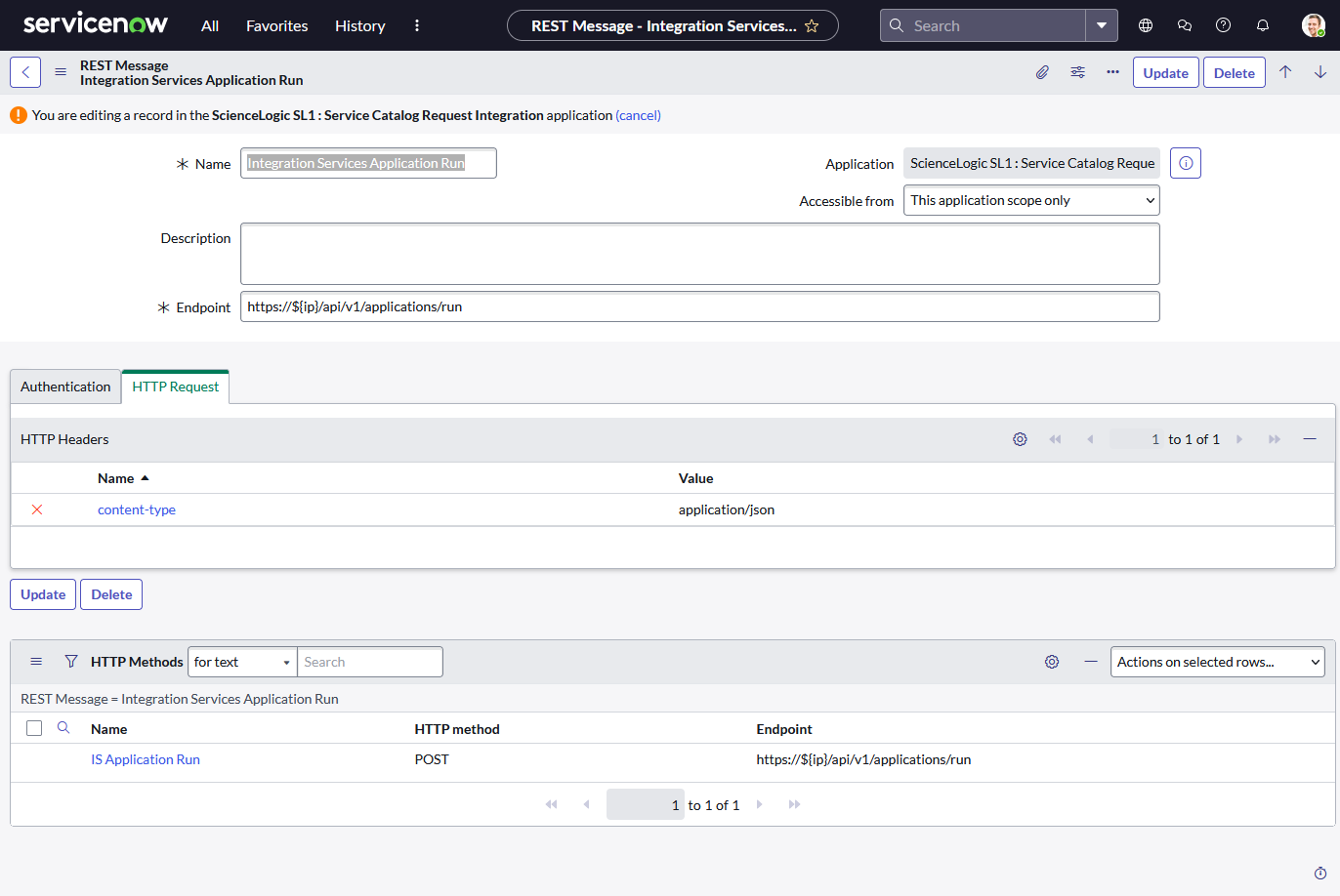

    Configuring ServiceNow to use an API Key for PowerFlow Authentication
    If you want to use an API key for authentication instead of using the default "isadmin" user, you will need to add an HTTP header to the Integration Services Application Run record in ServiceNow.
    1. In PowerFlow, create an API key on the API Keys page and save the key for step 9, below.
    2. In ServiceNow, go to System Web Services > Outbound > REST Message and search for Integration Services Application Run.
    3. Select the Integration Services Application Run record that is connected to the ScienceLogic SL1: Service Catalog Request Integration in the Application column. The Integration Services Application Run record appears:
    4. In the HTTP Methods section, click IS Application Run.
    5. Click the HTTP Request tab.
    6. If needed, click Insert from the Additional actions menu at the top left of the record.
    7. In the Use MID Server field, select the MID server you want to use.
    8. In the HTTP Headers section, type PF-APIKEY in the Name field.
    9. In the HTTP Headers section, paste the API key from step 1 in the Value field.
    10. Click the Update button in the lower left of the window.

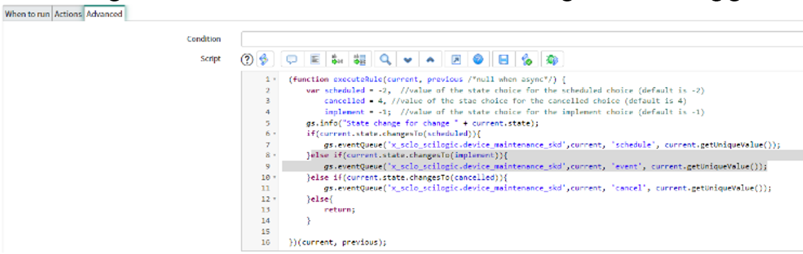

    Change Request Events Example
    There are many different ways to utilize the registered events that are supplied in the certified application. Below is on possible way of triggering by using business rule on the change request table.

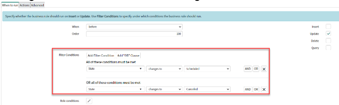

    1. Navigate to the change request table and create a business rule:
    2. Configure the Business Rule to trigger when the state of the change request changes to Scheduled or Canceled:
    3. Click the Advanced tab, where you can configure the trigger for the event queue:
      This script block is set up to trigger three different times, depending on the state change:
      (function executeRule(current, previous /*null when async*/) {
      	var scheduled = -2,  //value of the state choice for the scheduled choice (default is -2)
      		cancelled = 4, //value of the stae choice for the cancelled choice (default is 4)
      		implement = -1;  //value of the state choice for the implement choice (default is -1)
      	gs.info("State change for change " + current.state);
      	if(current.state.changesTo(scheduled)){
      		gs.eventQueue('x_sclo_scilogic.device_maintenance_skd',current, 'schedule', current.getUniqueValue());
      	}else if(current.state.changesTo(implement)){
      		gs.eventQueue('x_sclo_scilogic.device_maintenance_skd',current, 'event', current.getUniqueValue());
      	}else if(current.state.changesTo(cancelled)){
      		gs.eventQueue('x_sclo_scilogic.device_maintenance_skd',current, 'cancel', current.getUniqueValue());
      	}else{
      		return;
      })(current, previous);
