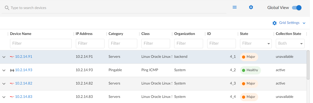

Viewing the Global List of Devices
The Devices page allows you to view all of your managed devices in SL1. This section explains how to gather more information about a device from this page.
To navigate to the Devices page, click the Devices icon ():
In a Global Manager system:
  • When the Global View button on the Devices page is toggled on, you can view a list of all of the devices discovered across all of the stacks in your Global Manager system.
  • When the Global View button on the Devices page is toggled off, you can view a list of devices discovered only on the Global Manager system itself.
You cannot add devices from the Devices page while in Global View mode. You can add devices on a particular stack only while on that stack in non-Global View mode.
If you are looking for a very specific set of devices, click the gear icon () to the right of the Search field and select Advanced. In this mode you can create an advanced search using "AND" or "OR" for multiple search criteria. For more information, see Performing an Advanced Search.
For each device, the Devices page displays the following information:
  • Device Name. Name of the device. For devices running SNMP or with DNS entries, the name is discovered automatically. For devices without SNMP or DNS entries, the device's IP address will appear in this field.
  • IP Address. The device's IP address.
  • Category. The category assigned to the device. Categories include servers, routers, switches, firewalls, and printers, among others. The category is assigned automatically during discovery. For more information about Device Categories, see the section on Managing Device Classes and Device Categories.
  • Class. The manufacturer and type of device. The Device Class is assigned automatically during discovery. For more information about Device Classes, see the section on Managing Device Classes and Device Categories.
  • Organization. The Organization to which the device is assigned.
  • ID. The device ID. This is a unique number that SL1 automatically assigns to the device during discovery. In a Global Manager system with Global View enabled, the device ID will be preceded by a number and an underscore, where the number preceding the underscore represents the stack on which the device was discovered.
  • State. The current condition of the device, based upon events generated by the device. The device can have one of the following States:
    • Critical. Device has a serious problem that requires immediate attention.
    • Major. Device has a problem that requires immediate attention.
    • Minor. Device has a less serious problem.
    • Notice. Device has an informational event associated with it.
    • Healthy. Device is running with no problems.
  • Collection State. The current condition of data collection for the device. The device can have one of the following Collection States:
  • Active. SL1 is collecting data from the device.
  • Unavailable. SL1 cannot connect to the device, and will not collect data from the device until the device becomes available. A physical device falls back to executing the availability ping every five minutes, unless you have critical ping enabled. Component devices get their availability calculated by the component discovery Dynamic Application of the parent device.
  • Disabled. SL1 is not currently collecting data from the device.
  • Component Vanished. The component device is not being reported currently by its root device. SL1 cannot collect data from the device at this time.
  • Hostname. The fully qualified hostname for the device, for devices that are discovered and managed by hostname (instead of by IP address).
  • Stack Name. The name of the stack on which the device was discovered.
  • Stack ID. The numeric ID of the stack on which the device was discovered.
To rearrange the columns in the list, click and drag the column name to a new location. You can adjust the width of a column by clicking and dragging the right edge of the column. For more information about editing and adding columns, see Editing the Settings for an Inventory Page.

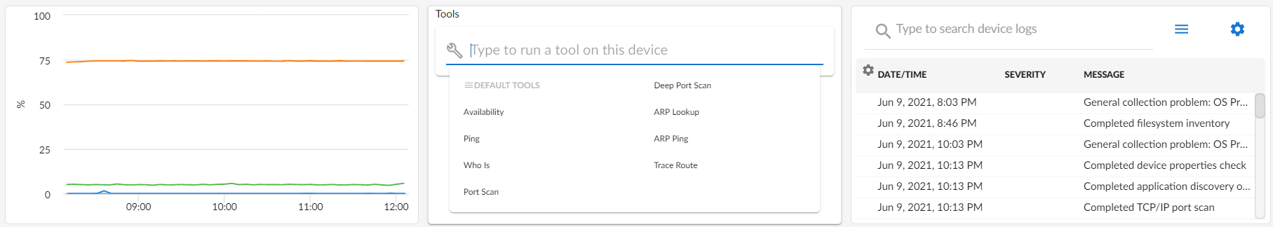

The Device Drawer contains the Vitals graph pane and the Logs pane.
  • The Vitals pane displays graph data for the past four hours of CPU usage, memory usage, and latency for that device, where relevant. You can zoom in on a shorter time frame in the Vitals graph by clicking and dragging your cursor over a timeframe, and you can go back to the original time span by clicking the Reset zoom button.
  • The Tools pane enables you to run a set of diagnostic tools or user-initiated actions in the Activity Center, or to click on custom links that will open in a separate browser window. Click the search bar to search for tools, actions, or custom links that are available for the device. For more information, see the section on Using the Activity Center.

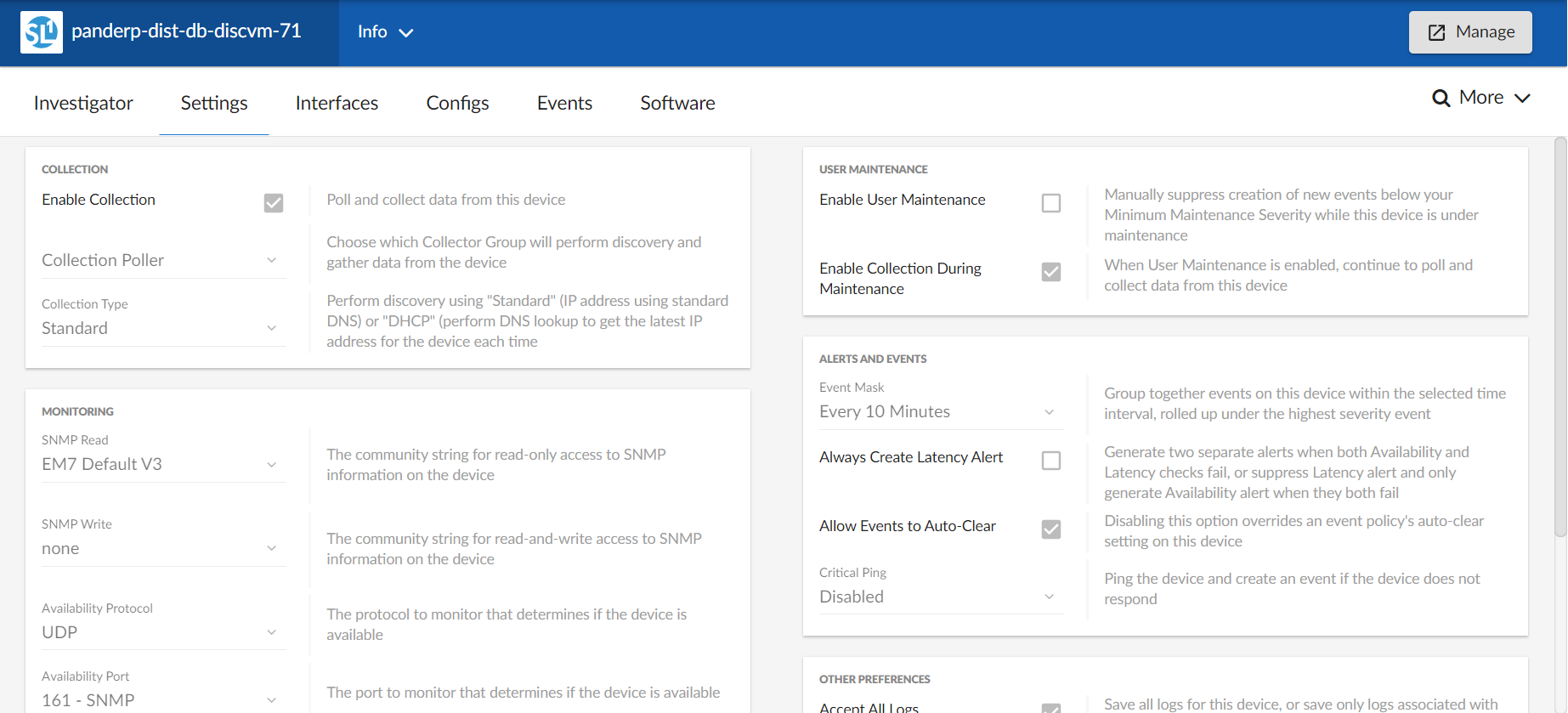

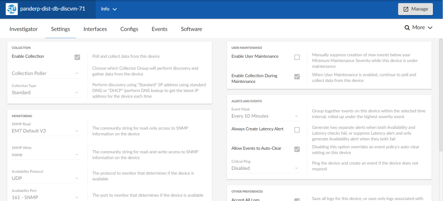

  • Settings. Enables you to manage your preferences for that device, such as whether to auto-clear events, accept all logs, run daily port scans, and more. You can also set user maintenance preferences and disable or enable collection on that device.

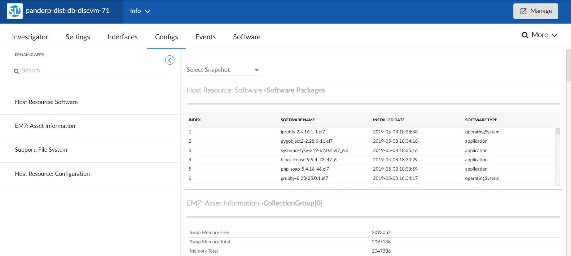

  • Configs. Displays configuration information collected from the device by Dynamic Applications. If the device does not have any configuration data, this tab does not appear.

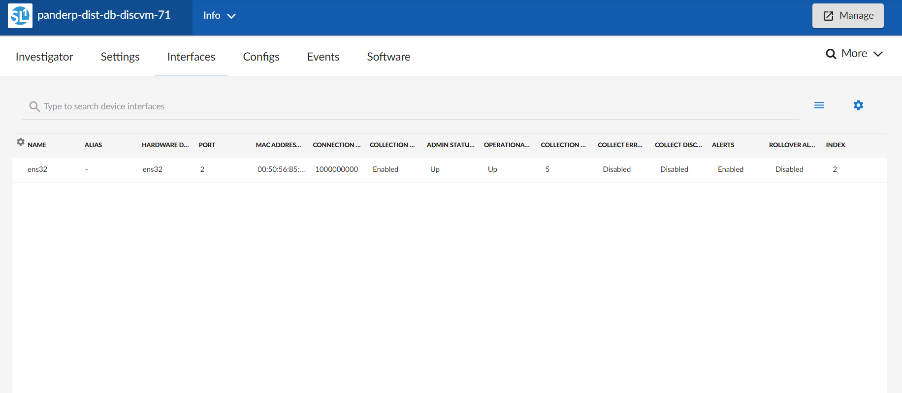

  • Interfaces. Displays information about the interfaces used by the device. If this device does not use interfaces, this tab does not appear.

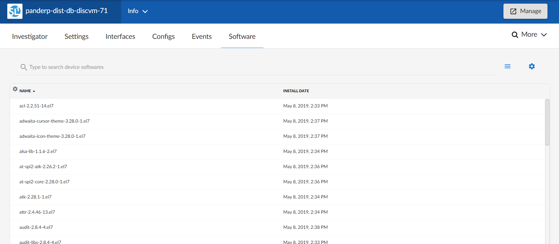

  • Software. Displays a list of all software installed on the device.
  • More. This drop-down list lets you select additional tabs to display on the Device Investigator page by clicking the star icon next to the tab name. You can search for specific items on a tab and the relevant tab will appear in the search results. You can also remove a tab by clicking the star icon again, turning it from blue to white. Your tab selections are saved and persist until you change them.

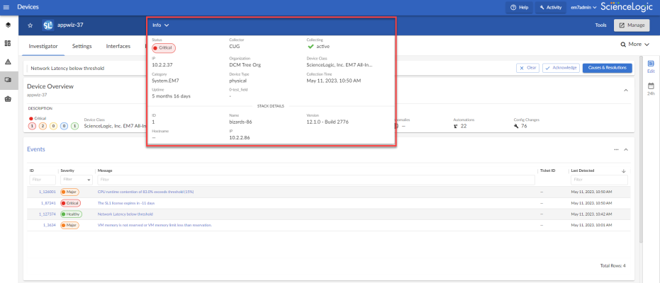

Using the Info Drawer on the Device Investigator Page
On the Device Investigator page, you can view read-only information about the device in the Info drawer:
The Info drawer displays the following information for the device:
  • Status. The status of the device.
  • Collector. The Collector Group that was last used to collect data from the device. For All-In-One Appliances, this field will contain the name of the default, built-in Collector Group.
  • Collecting. Indicates that the device collection is "Collecting" with a green check mark icon (), meaning SL1 is periodically collecting data from the device, or "Not Collecting" with a prohibition icon (), meaning the SL1 is not currently collecting data from the device.
  • IP. IP address of the device.
  • Organization. The organization to which this device belongs. Click the organization name to view a detail page for the organization.
  • Device Class. Device class for the device. A device class usually describes the manufacturer of the device.
  • Category. The device category associated with the device. The device category usually describes the primary function of the device, such as a "server", "switch", or "router".
  • Device Type. Specifies whether the device is a physical device or a virtual device.
  • Collection Time. Date and time of the most recent collection.
  • Uptime. The number of days and hours that the device has been continuously up and communicating with SL1.
  • More Attributes. This lower section lists any custom attributes that might be aligned with this device.
Additionally, the Info drawer also displays the following stack information for devices in Global Manager systems:
  • ID. The numeric ID of the stack on which the device was discovered.
  • Name. The name of the stack on which the device was discovered.
  • Version. The SL1 version running on the stack on which the device was discovered.
  • Hostname. The hostname of the stack on which the device was discovered.
  • IP. The IP address of the stack on which the device was discovered.
Using Device Tools in the Action Runner
On the Device Investigator page, you can click the Tools menu to display the Action Runner. The Action Runner enables you to run a set of diagnostic tools or user-initiated actions, or to click on custom links that will open in a separate browser window.
NOTE: The tools and actions that are available in the Action Runner are based on the device type and your user permissions, as determined by your organization assignment and access hooks. For example, if a device does not have an IP address, only the Availability tool will be available.
NOTE: For more information about user-initiated actions, see the section on User-Initiated Automations. For more information about custom links, see the section on Custom Links.
To use the Action Runner:
  1. Access the Action Runner for devices in one of the following ways:
  • On the Devices page, open the Device Drawer for a particular device. Click the search bar in the Tools pane.
  • On the Device Investigator page, click the Tools button in the top navigation bar.
  • Click Activity in the navigation bar at the top of any page in SL1. Click the search bar.
  1. When you click the search bar, a list appears of the default tools, actions, or custom links that are available for the selected device. Click one of these tools, actions, or custom links, or use the search bar to search for a tool or action that is not listed. The following default tools are available in the Action Runner:
  • Availability. Displays the results of an availability check of the device, using the port and protocol specified in the Availability Port and Availability Protocol fields on the Settings tab for this device.
  • Ping. Displays statistics returned by the ping tool. The ping tool sends a packet to the device's IP address (the one used by SL1 to communicate with the device) and waits for a reply. SL1 then displays the number of seconds it took to receive a reply from the device and the number of bytes returned from the device. If the device has an IPv6 address, SL1 uses the appropriate IPv6 ping command.
  • Who Is. Displays information about the device's IP, including the organization that registered the IP and contacts within that organization.
  • Port Scan. Displays a list of all open ports on the device at the time of the scan.
  • Deep Port Scan. Displays a list of all open ports and as much detail about each open port as the deep port scanner can retrieve.
  • ARP Lookup. Displays a list of IP addresses for the device and the resolved Ethernet physical address (MAC address) for each IP address.
  • ARP Ping. Displays the results from the ARP Ping tool. The ARP Ping tool is similar in function to ping, but it uses the ARP protocol instead of ICMP. The ARP Ping tool can be used only on the local network.
  • Trace Route. Displays the network route between SL1 and the device. The tool provides details on each hop to the endpoint. If the device has an IPv6 address, SL1 uses the appropriate IPv6 traceroute command.
The tools found in the Action Runner can also be found in the Device Toolbox in the classic SL1 user interface.
  1. If you clicked a custom link, the link opens in a new browser window. If you clicked on a tool or action, then as it runs, its progress and results appear in a log in the Activity Center.
  2. After the tool or action has run, if you want to run it again, click the Run Again button. This button appears only for activities completed during your current session.

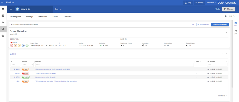

The Investigator Tab
The Investigator tab of the Device Investigator page displays a customizable set of metrics about the selected device:
The device type determines which metrics appear in the Investigator tab. For most devices, the following panels and metrics appear by default:
  • Overview. Displays a panel that includes basic information about the device, including its IP address, Device Class, organization, current state, event count, and collection status.
  • Events. Displays a panel with the list of events aligned with this device. In the right-hand pane, you can click the ID or Message field to view the Event Investigator page for that event. You can also click the Events panel heading to go to the Events tab for that device.
  • To open an event context panel where you can clear, acknowledge, or view causes and resolutions relating to an event, click the name of the device where the event has occurred on the Event Investigator or Service Investigator pages. You will be redirected to the Device Investigator page for that device, where the event context panel appears at the top of this page.
  • Availability. Displays a panel for the device's availability over time. Availability means a device's ability to accept connections and data from the network.
  • Latency. Displays a panel for latency for the device over time, in milliseconds. Latency means the amount of time it takes SL1 to communicate with the device.
  • Map. Displays a panel with a map of the device and all of the devices with which the device has relationships. You can also click the Map panel heading to go to the Map tab for that device. This panel is disabled by default, but can be enabled by clicking the Edit button, and then selecting the Map checkbox.
  • CPU Utilization, Physical Memory Utilization, and Swap Memory Utilization. Displays a combined chart panel with the percentage of CPU, physical memory, and swap memory used by the device over time.
  • Utilization In and Out. Displays a combined chart panel with the percentage of utilization in and out for the device's network interfaces.
  • Discards In and Out. Displays a combined chart panel with the number of discards in and out for the device's network interfaces over time.
  • Errors In and Out. Displays a combined chart panel with the number of errors in and out for the device's network interfaces over time.
  • Logs. Displays a panel with a list of the logs for the device, sorted from newest to oldest by default. You can use the Search field to search device logs for specific event messages, event IDs, date ranges, source types, and other relevant text for troubleshooting. You can also click on the column headers for Date/Time, Source, Event ID, Severity, and Message to sort by that column.

The Settings Tab
On the Settings tab of the Device Investigator page, you can manage your preferences for that device, such as whether to auto-clear events, accept all logs, run daily port scans, and more.
Click the Edit button to change your settings. When you are done making changes, click Save.
Image of the Settings tab in the Device Investigator
The Settings tab in the Device Investigator
The Agent section appears only for agent-type devices.
Set the following Agent data collection preferences:
  • Disk Space. Specify the amount of disk space in MB that the agent can use to store data. If the agent loses connectivity to SL1, this disk space will be used to store collected data until the connection to SL1 is restored. When connectivity is re-established, the agent uploads all of its stored data.
  • Excludes. Type a list of processes and directories, separated by semi-colons, that you do not want the agent to monitor.
  • Includes. Type a list of processes and directories, separated by semi-colons, that you want the agent to monitor. This field ensures that specific processes are monitored.
    If a process or directory is included in both the Excludes field and the Includes field, the item in the Includes field will override the item in the Excludes field.
  • Collect File Information. Select this option if you want the agent to report the names of files accessed by each monitored process.
  • Collect Named Pipe Information. Select this option if you want the agent to collect named pipe information.
  • Collect Socket Information. Select this option if you want the agent to collect socket information.
  • Collect Thread Information. Select this option if you want the agent to collect thread information.
  • Collect Non-Intercepted Processes. Select this option if you want the agent to collect limited information for processes that do not contain the agent library.
  • Processes Aggregation. Specify how you want the agent to collect limited information for processes that do not have the agent library in them, and how to aggregate short-lived processes. Your options include the following:
  • All: Aggregate every short-lived process into its parent.
  • None: Do not aggregate any short-lived process.
  • Without Sockets: Aggregate short-lived processes unless those processes have sockets.
  • Upload Interval. Specify how often the agent should upload data. Your options include the following:
  • 20 Seconds. Upload a data snapshot every 20 seconds.
  • 60 Seconds. Upload a data summary every 60 seconds. This is the default setting starting with SL1 version 11.1.0, and version 174 of the Linux agent and version 133 for the Windows agent. This option uses an improved data format that requires fewer SL1 resources. The SL1 agent continues to internally collect and poll data every 20 seconds, but the agent summarizes and uploads that data every 60 seconds. There is no data loss even though the data is uploaded less frequently.
    Starting with SL1 version 11.3.0, if you specify 60 seconds for the upload interval, the summary upload now will include "watched" or "monitored" files, just like the snapshot upload does.
Set the following Collection preferences:
  • Enable Collection. Select this option to enable collection using the collector group specified in the following field.
  • Collection Poller. Select the name of collector group you want to use for collection on this device.
  • Collection Type. Select the type of collection you want to use on this device. Your options include Standard or DHCP.
Set the following Monitoring preferences:
  • SNMP Read. Select the community string for read-only access to SNMP information on the device.
  • SNMP Write. Select the community string for read-and-write access to SNMP information on the device.
  • Availability Protocol. Select the protocol to monitor that determines if the device is available.
  • Availability Port. Select the port to monitor that determines if the device is available.
  • Latency Protocol. Select the protocol to monitor that determines latency for the device.
  • Latency Port. Select the port to monitor that determines latency for the device.
  • Auto-Update. This checkbox specifies whether or not you want SL1 to perform a nightly discovery of the device and update records with changes to the device. If this field is unchecked, SL1 will not perform nightly discovery. Changes to the device, including newly opened ports, will not be recorded by SL1.
  • Scan All IPs. If the device uses multiple IP Addresses, SL1 will scan for open ports on all IPs during initial discovery and nightly discovery.
Set the following User Maintenance preferences:
  • Enable User Maintenance. Specifies whether the device is in user maintenance mode. User maintenance is an option that allows a user to manually put a device in to "maintenance mode". During maintenance mode, for the selected devices, SL1 generate only events with a severity less than the system-wide Maintenance Minimum Severity setting. If you select Enabled, the device is put in user maintenance mode, and the device will remain in this state until you or another user disables user maintenance mode.
  • Enable Collection During Maintenance . Specifies whether SL1 will poll the device when user maintenance mode is enabled. If you select Enabled, SL1 will continue to poll and collect data from this device during user maintenance mode.
Set the following Alerts and Events preferences:
  • Event Mask. Specify the time frame for masking events. When a device uses the Event Mask setting, SL1 groups together events that occur on that device within the specified span of time.
  • Always Create Latency Alert. Select this option to generate two alerts when availability and latency checks fail. Deselect to generate only an availability alert and suppress latency alerts.
  • Allow Events to Auto-Clear. Deselect this option to override an event policy's auto-clear setting for this device.
  • Critical Ping. Pings the device and creates an event if the device does not respond. When enabled you can select between 5 and 120 seconds.
Set the following Other device preferences:
  • Accept All Logs. This checkbox specifies whether or not you want to keep and save all logs for this device. If you want to retain only logs associated with events, uncheck this field.
  • Daily Port Scans. This checkbox specifies whether or not you want SL1 to perform a daily scan of the device for open ports.
  • Preserve Device Name. If selected, the name of the device in SL1 will remain the same, even if the name of the actual device is changed. If unselected, the SL1 name for the device will be updated if the name of the actual device is changed.
  • Disable Asset Update. If selected, SL1 will not automatically create a new asset record for the device or update the existing asset record for the device. For the single device, this checkbox over-rides any settings defined in the Asset Automation page (System > Settings > Assets).
  • Bypass Interface Inventory. Specifies whether or not the discovery session should discover network interfaces. Your options include:
  • Selected. SL1 will not attempt to discover interfaces for this device during re-discovery and nightly auto-discovery.
  • Not Selected. SL1 will attempt to discover network interfaces for this device during re-discovery and nightly auto-discovery using the Interface Inventory Timeout value and Maximum Allowed Interfaces value specified in the Device Thresholds page.
  • Dynamic Discovery. If selected, SL1 will automatically assign the appropriate dynamic applications to the device during discovery.
The Configs Tab
On the Configs tab of the Device Investigator, you can view configuration information that has been collected from the device by Dynamic Applications.
Image of the Device Information tab on the Device Investigator page
All objects of type "config" are included on the Configs tab. Usually, "config" objects contain static information about hardware and configuration settings, such as serial numbers, version numbers, and hardware status.
For more information about this tab, see the section on Viewing Device Configuration Data.
The Events Tab
On the Events tab of the Device Investigator, you can view a list of events associated with the device.
The Events tab of the Device Investigator page
For each event, the Events tab displays the following information:
  • ID. The unique ID for the event, generated by SL1. The ID appears as a hyperlink. To view the Event Investigator page for the event, click the ID hyperlink. For more information about the Event Investigator page, see the section on Using the Event Investigator.
  • Severity. The severity of the event. Possible values are:
  • Critical
  • Major
  • Minor
  • Notice
  • Healthy
  • Message. The message generated for the event. The message appears as a hyperlink. To view the Event Investigator page for the event, click the Message hyperlink. For more information about the Event Investigator page, see the section on Using the Event Investigator.
  • Age. The amount of time (in days, hours, and minutes) since the event first occurred or since its last occurrence without having been cleared.
  • Ticket ID. If a ticket has been created for the event, this column displays the ticket ID of that ticket.
  • Count. The number of times this event has occurred, the number of child events associated with the event, or the number of masked events associated with the event.
  • Last Detected. The date and time at which the event last occurred on the device.
  • Ticket External Reference. The numeric ID associated with a ticket from an external ticketing system (that is, a ticket that was not created in SL1). If this field displays a value, you can click on that value to spawn a new window and view the external ticket.
    NOTE: To link an external ticket to an event, you must create a custom Run Book Automation policy and a custom Run Book Action or use the ScienceLogic APIs. For help with these tasks, contact ScienceLogic Customer Care.
  • Event Source. The system or application that generated this event. Possible values are:
  • Syslog. Event was generated from a system log generated by a device.
  • Email. Event was generated by an email from an external agent. For example, Microsoft Operations Manager (MOM).
  • Internal. Event was generated by SL1.
  • Trap. Event was generated by an SNMP trap.
  • Dynamic. Event was generated by a Dynamic Application collecting data from the device.
  • API. Event was generated by a snippet Run Book Action, a snippet Dynamic Application, a request to the ScienceLogic API, or by an external system.
  • SL1 agent. Message is generated by log file messages collected by the SL1 agent. For more information about creating Log File Monitoring Policies to monitor log file messages collected by the agent, see the section on Monitoring Device Logs Using an Agent.
  • Event Note. A user-defined note to accompany the event. To create or edit a note, click the Note icon (). The Edit Event Note window appears, where you can create or edit a note and save your changes.
  • Acknowledge. If the event has been acknowledged, this column displays a check mark and the username of the user who acknowledged the event. If the event has not yet been acknowledged, this column displays an Acknowledge button; click the Acknowledge button to acknowledge the event. When you acknowledge an event, you let other users know that you are aware of that event and are working on a response.
  • Clear. Click the Clear button to clear the event. When you clear an event, you let other users know that this event has been addressed. Clearing an event removes a single instance of the event from the Events tab. If the same event occurs again on the same device, it will reappear in the Events tab, even if you have previously cleared that event.
You can toggle between Active events and Cleared events by using the drop-down to the left of the Search field. On this tab, you can also acknowledge and clear an event if you have permission for those actions.
Clicking the Actions menu () next to an event gives you the following options, based on your permissions:
  • View Event. Navigates to the Event Investigator page for that event.
  • Edit Event Note. Lets you update the Note associated with this event.
  • Create Ticket. Opens a new ticket in the SL1 Ticket Editor, if you are using SL1 for your ticketing.
  • Edit Ticket. Opens an existing ticket in the SL1 Ticket Editor, if you are using SL1 for your ticketing.
  • Create External Ticket. Creates a new ticket for the event if you are using an external ticketing system instead of SL1.
  • View Event Policy. Opens the Event Policy page for the policy aligned with this event.
  • Suppress Event for this Device. Suppresses the current event on the current device. When you suppress an event, you are specifying that in the future, if this event occurs again on the same device, the event will not appear in
  • View Automation Actions. Displays a log of automations that have occurred for that event. This option is hidden if the event does not have any automation actions aligned to it.
The Interfaces Tab
On the Interfaces tab of the Device Investigator, you can view information about the various interfaces used by the device, including Port, Hardware Description, MAC Address, Connection Speed, and other details for each interface.
The Interfaces tab of the Device Investigator page
For more information about this tab, see the section on Viewing Interfaces for a Single Device.
The Software Tab
On the Software tab of the Device Investigator, you can view a list of all the software installed on the device.
The Software tab of the Device Investigator page
For each installed software title, the Software tab displays the following information:
  • Name. Name of the software.
  • Install Date. Date and time the software was installed on the device.
For more information about this tab, see the section on Monitoring Hardware and Software.
