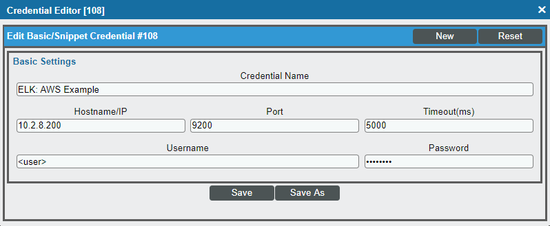

To use the Dynamic Applications in the ELK: AWS CloudTrail PowerPack, you must first define a credential in SL1. This credential enables the Dynamic Applications in the ELK: AWS CloudTrail PowerPack to monitor your AWS component devices in ELK stacks. The PowerPack includes a sample Basic/Snippet credential (ELK: AWS Example) that you can use as a template.
To define an AWS ELK credential:
  1. Click the wrench icon () for the ELK: AWS Example credential. The Credential Editor modal page appears:
  • Credential Name. Type a new name for your AWS ELK credential.
  • Hostname/IP. Type the IP address or hostname for the Logstash server that collects data for the AWS components in your ELK stack.
  • Port. Type "9200".
Use the default values for the remaining fields.
The Basic/Snippet credential requires values in the Username and Password fields, but the values themselves do not matter.

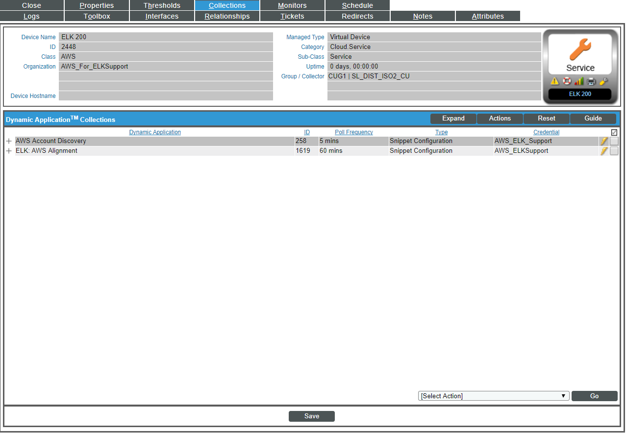

To monitor your AWS component devices in ELK stacks, you must manually align the "ELK: AWS Alignment" Dynamic Application with the AWS virtual device. When you do so, the remaining Dynamic Applications from the ELK: AWS CloudTrail PowerPack automatically align to the appropriate AWS component devices.
To manually align the "ELK: AWS Alignment" Dynamic Application to your virtual device:
  1. Locate your AWS virtual device and click its wrench icon ().
  1. In the Device Administration panel, click the Collections tab. The Dynamic Application Collections page appears.
  1. Click the Actions button, and then select Add Dynamic Application from the menu.
  2. In the Dynamic Application Alignment modal page, select ELK: AWS Alignment in the Dynamic Applications field.
  3. In the Credentials field, select the credential you created for your AWS ELK components.
  4. Click Save.
By default, the "ELK: AWS Alignment" Dynamic Application begins collecting data after 60 minutes. If you want to begin collecting data immediately, click the lightning bolt icon () for the "ELK: AWS Alignment" Dynamic Application on the Dynamic Application Collections page.

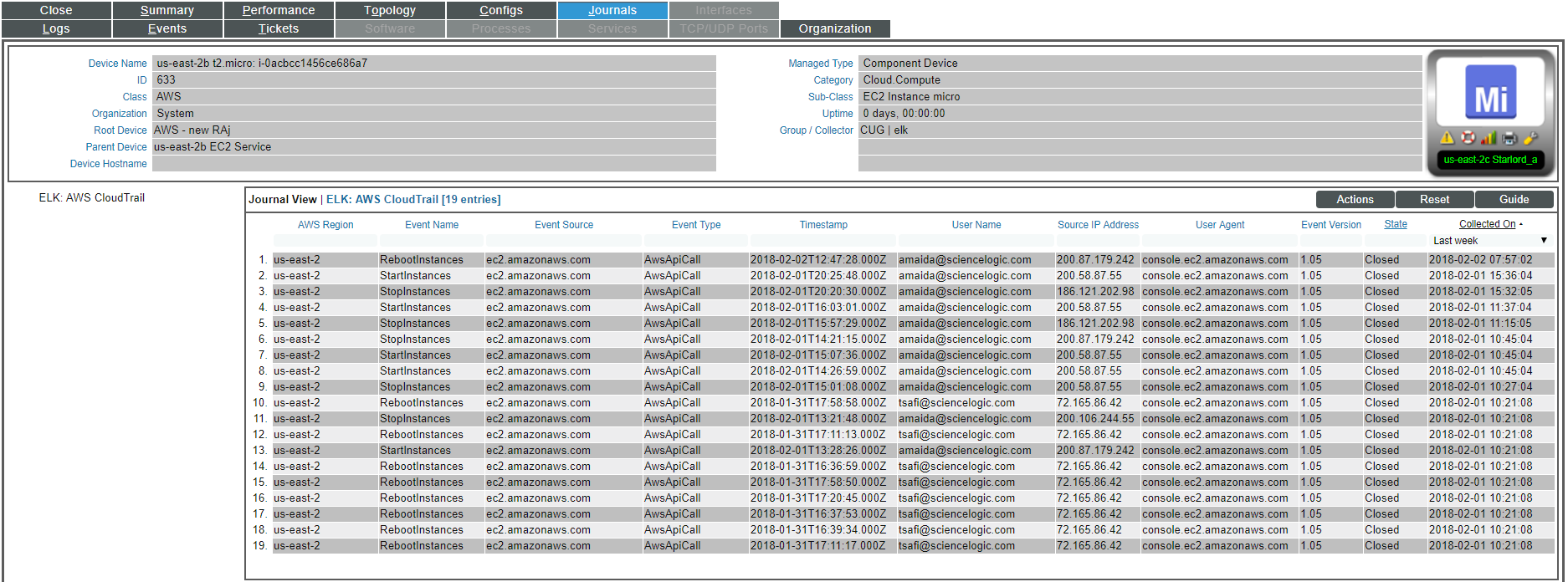

To view the data collected by the "ELK: AWS CloudTrail" Dynamic Application, navigate to the Journal View page (Registry > Devices > Device Manager > bar-graph icon > Journals) and click ELK: AWS CloudTrail on the left menu:

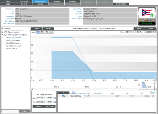

To view the data collected by the "ELK: AWS CloudTrail EC2 Stats" Dynamic Application, navigate to the Device Performance page (Registry > Devices > Device Manager > bar-graph icon > Performance) and click ELK: AWS CloudTrail on the left menu:
