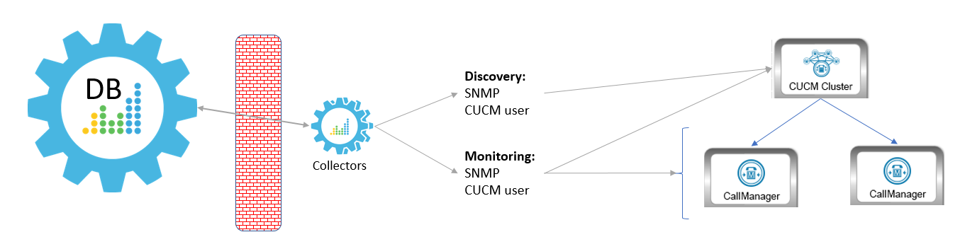

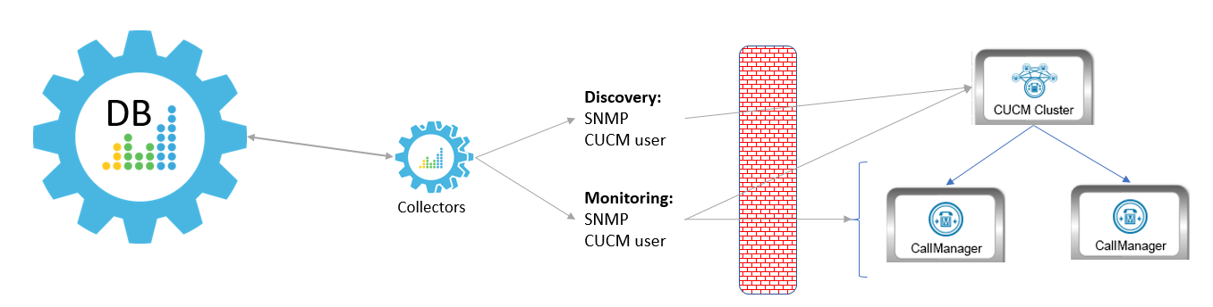

Method 1
In the first scenario, the Data Collector sits in front of the firewall and you define the CallManagers by hostname:
In this scenario, you must have the following ports open for the firewall:
Direction Port Protocol
ScienceLogic Database Server to the Data Collector 7707 TCP
PhoneHome Collector to the Database Server 7705 TCP

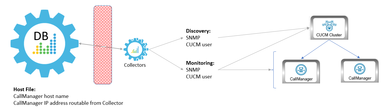

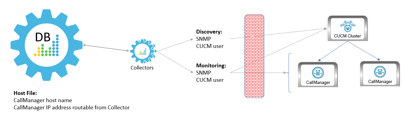

Method 2
In the second scenario, the Data Collector sits in front of the firewall and you define the CallManagers by IP address. This method requires you to create a host file that includes the CallManager hostname and IP address:

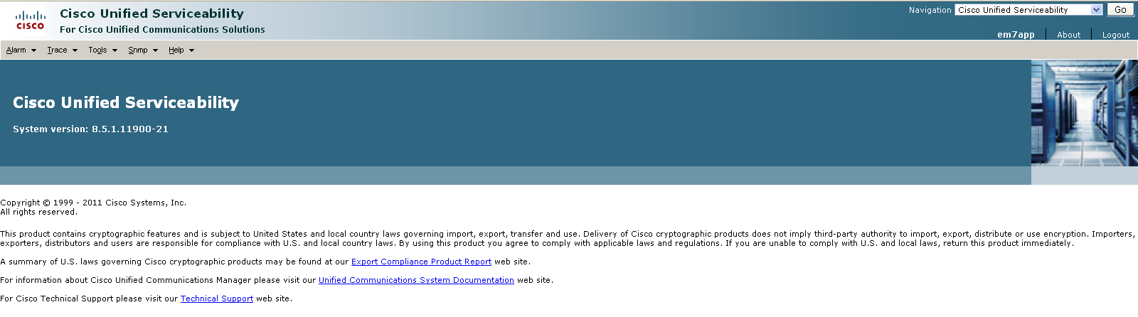

  1. In the Navigation drop-down list at the top-right corner of the page, select Cisco Unified Serviceability, and then click the Go button. The Cisco Unified Serviceability page appears:
Image of the Cisco Unified Serviceability page

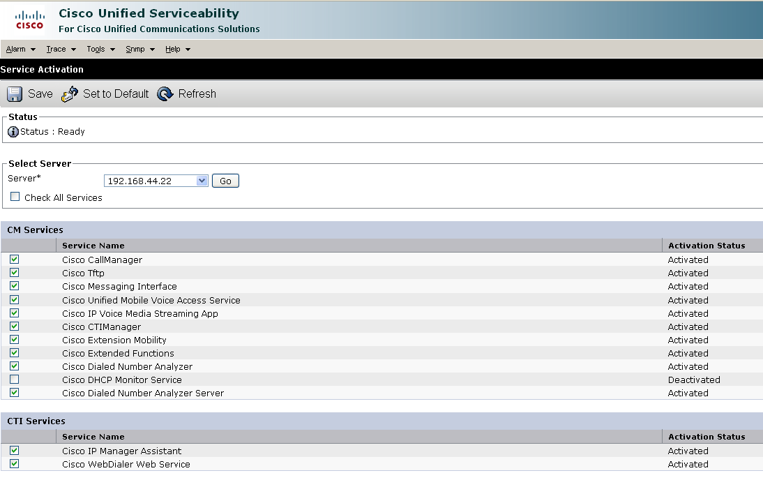

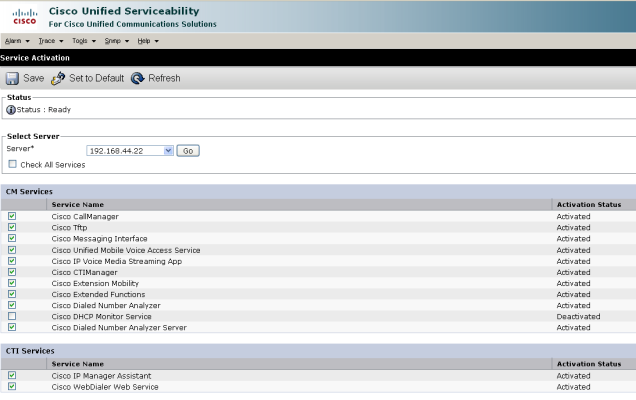

  1. In the navigation bar at the top-left of the page, hover over Tools, then select Service Activation. The Service Activation page appears:
Image of the Service Activation page
  1. In the Server drop-down list, select the Cisco Unified CM server for which you want to enable the AXL web service, and then click the Go button.
  2. In the list of services, locate the Database and Admin Services section. If the Activation Status of the Cisco AXL Web Service is "Activated", the AXL web service is already enabled.
  3. If the Activation Status of the Cisco AXL Web Service is not "Activated", select the checkbox for the Cisco AXL Web Service.
  4. Click the Save button at the bottom of the page to save your changes, and then click the OK button in the pop-up window that appears.

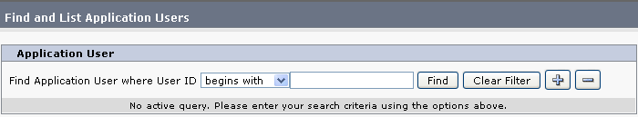

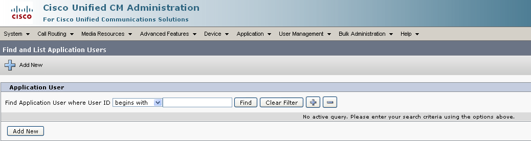

  1. In the navigation bar at the top-left of the page, hover over User Management, then select Application User. The Find and List Users page appears:
Image of the Find and List Users page

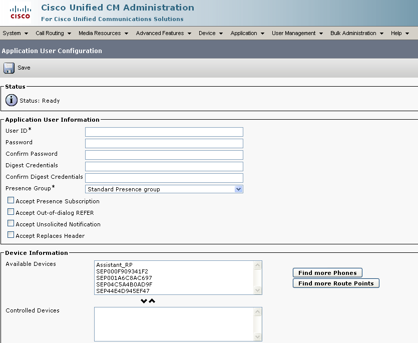

  1. Click the + Add New button. The Application User Configuration page appears:
Image of the Application User Configuration page
  • User ID. Type a username for the new user.
  • Password. Type a password for the new user.
  • Confirm Password. Type the password for the new user again.
  1. Click the Save button.

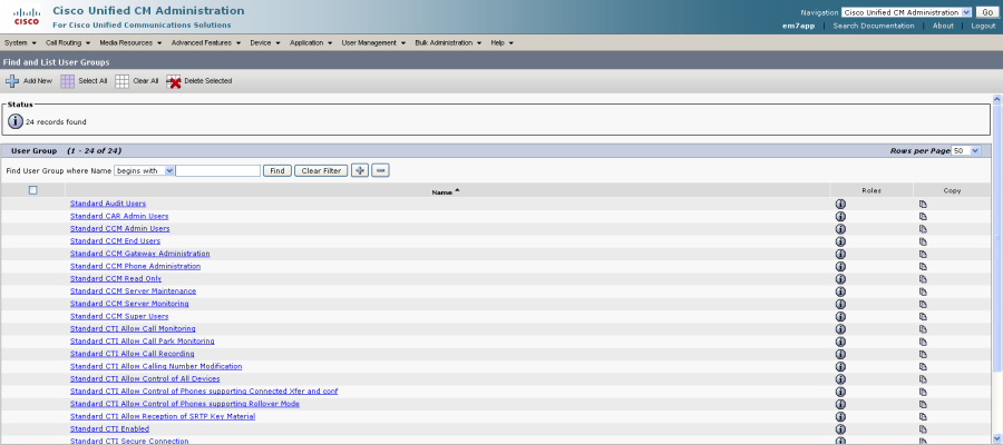

  1. In the navigation bar at the top-left of the page, hover over User Management, then select User Group. The Find and List User Groups page appears:
Image of the Find and List User Groups page

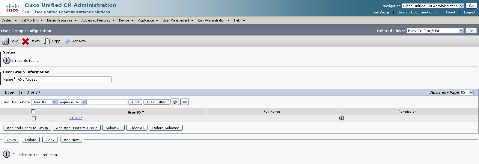

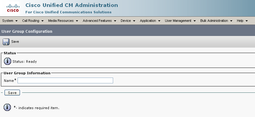

  1. Click the + Add New button. The User Group Configuration page appears:
  1. In the Name field, type a name for the user group. For example, you could call the user group "AXL Access".
  2. Click the Save button.
  1. Click the Add App Users to Group button. The Find and List Application Users window appears:
  1. Click the Find button. In the list of users, select the checkbox for the user account that you created, then click the Add Selected button at the bottom of the page.
  1. The Find and List Application Users window closes. In the User Group Configuration page, the user account is included in the list of users:
Image of the User Group Configuration page with a new user added

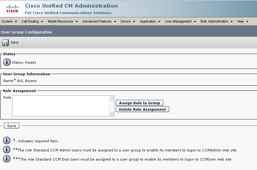

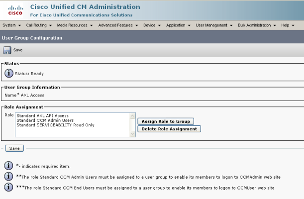

  1. In the Related Links drop-down list at the top-right hand corner of the page, select Assign Role to User Group, and then click the Go button. The User Group Configuration page appears:

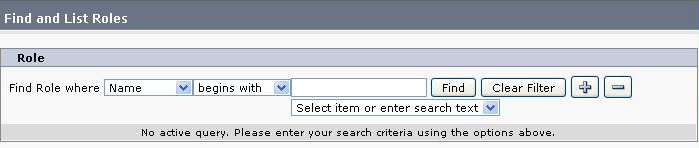

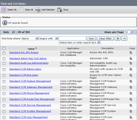

  1. Click the Assign Role to Group button. The Find and List Roles window appears:
Image of the Find and List Roles window
  1. Click the Find button. A list of roles appears:
Image of the Find and List Roles window with a list of roles
  1. Select the checkboxes for the following roles:
  • Standard AXL API Access
  • Standard CCM Admin Users
  • Standard SERVICEABILITY Read Only
  1. Click the Add Selected button at the bottom of the page.
  1. The Find and List Roles window closes. In the User Group Configuration page, the Roles field includes the Standard AXL API Access role:
Image of the User Group Configuration page, with the Standard AXL API Access role

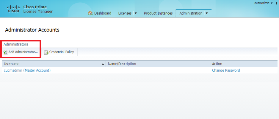

To create an administrator user in PLM:
  1. In a browser window, navigate to the following address:
https://ip-address-of-plm-server/elm-admin/
  1. Log in to the Cisco PLM site as an administrator.

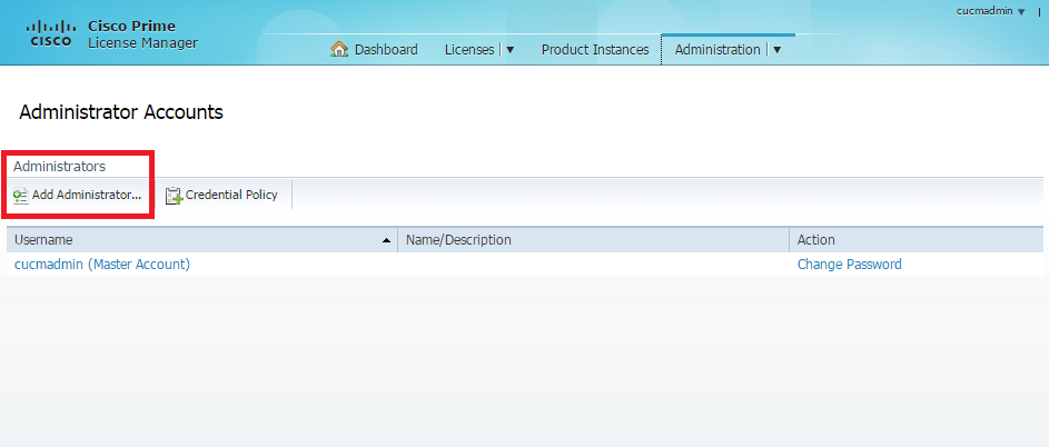

  2. In the Administration drop-down menu, select Administrator Accounts.

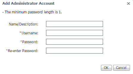

  1. Click the Add Administrator button.
Image of the Cisco PLM Administrator Accounts page
  1. In the Add Administrator Account modal page, make entries in the following fields:
Image of the Add Administrator Account dialog
  • Name/Description. Type a name or description for the account.
  • Username. Type the account username.
  • Password. Type the account password.
  • Re-enter Password. Type the account password again.
  1. Click OK.

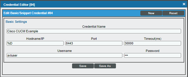

Creating a CUCM Credential
  • Timeout (ms). Type the timeout value of each request, in milliseconds. The default value is "30000".
To use the Dynamic Applications in the Cisco: CUCM Unified Communications Manager PowerPack, you must first define a Basic/Snippet Cisco Unified CM credential in SL1. This credential allows SL1 to communicate with the Cisco Unified CM cluster. The Cisco: CUCM Unified Communications Manager PowerPack includes a template you can use to create this Basic/Snippet credential.
To modify the Cisco Unified CM Basic/Snippet Credential template for use with your Cisco Unified CM cluster:
  1. Click the wrench icon () for the Cisco CUCM Example credential. The Credential Editor modal window appears:
Image of the Credential Editor modal window
  • Hostname/IP. Type the hostname or IP address, or you can type the variable "%D".
  • Port. Type the port number.
The example credential included in older versions of the Cisco: CUCM Unified Communications Manager PowerPack used "80" as the default Port number. If your Cisco Unified CM credential specifies port 80, SL1 will automatically override that value and use port 8443 instead. If your Cisco Unified CM credential specifies any port other than 80, SL1 will use that specified port.
  • Username. Type the username for the Cisco Unified CM user account that you created to access the AXL web service. For details, see the Configuring a Cisco Unified CM User Account section.
  • Password. Type the password for the username you entered in the Username field.
  1. Click the Save As button.

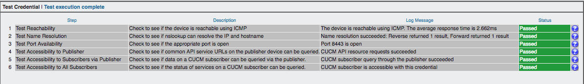

Testing the CUCM Credential
SL1 includes a Credential Test for Cisco Unified CM. Credential Tests define a series of steps that SL1 can execute on demand to validate whether a credential works as expected.
The CUCM Credential Test can be used to test a Basic/Snippet credential for monitoring Cisco Unified CM using the Dynamic Applications in the Cisco: CUCM Unified Communications Manager PowerPack. The CUCM Credential Test performs the following steps:
  • Test Reachability. Performs an ICMP ping request to see if the device is reachable.
  • Test Name Resolution. Checks to see if nslookup can resolve the IP address or hostname.
  • Test Port Availability. Performs an NMAP request to see if the appropriate port is open.
  • Test Accessibility to Publisher. Checks to see if the common API service URLs on the publisher device can be queried.
  • Test Accessibility to Subscribers via Publisher. Checks to see if data on a CUCM subscriber can be queried via the publisher.
  • Test Accessibility to All Subscribers. Checks to see if the status of services on a CUCM subscriber can be queried.

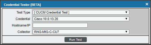

To test the CUCM credential:
  1. Locate the CUCM Credential Test and click its lightning bolt icon (). The Credential Tester modal page appears:
  • Hostname/IP. Enter the IP address or hostname for the device.
NOTE: The credential being tested cannot include more than 32 characters in the Hostname/IP field.
  1. Click the Run Test button to run the credential test. The Test Credential window appears:
  • Step. The name of the step.

  • Hostnames and Aliases. The hostname to align with the specified IP address. You can also include a space-delimited list of aliases for the host name.
  • Description. Description of the host entry. This field is not written to the host file. This field is for administrators to use when managing host file entries.
  • Organization. Organization associated with the host. You can select from a list of all existing organizations. This field is not written to the host file. This field is for administrators to use when managing host file entries. For example, a service provider could assign each customer its own organization and then use this field to manage host file entries for each customer.
  1. Click the Save button to save the new host entry.
