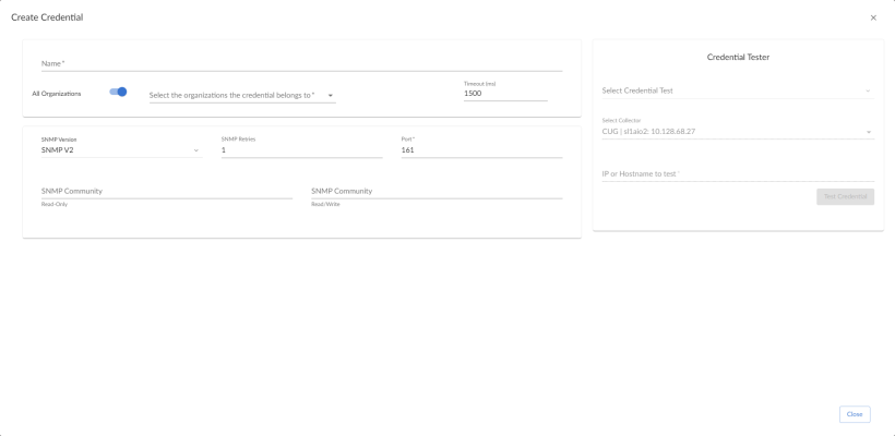

Creating an SNMP Credential for F5 BIG-IP
To use the Dynamic Applications in the F5 BIG-IP PowerPack, you must first define an SNMP credential in SL1. This credential allows SL1 to communicate with the BIG-IP system.
To configure an SNMP credential for F5 BIG-IP:
  1. Click the Create New button.
  1. In the drop-down list that appears, select Create SNMP Credential. The Credential Editor page appears:
  1. In the SNMP Version field, select SNMP V2.
  2. In the Name field, enter a name for the credential.
  3. In the All Organizations drop-down field, select the organizations the credential belongs to.
  4. In the SNMP Community (Read Only) field, enter the community string for the BIG-IP system.
  5. Optionally, supply values in the other fields in this page. In most cases, you can use the default values for the other fields.
  6. Click the Save & Close button.

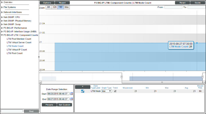

Manually Aligning the "F5 BIG IP LTM: Service Discovery" Dynamic Application with the BIG-IP Root Device
When you run discovery, the "F5 BIG-IP LTM: Component Counts" Dynamic Application is automatically aligned with the F5 BIG-IP system. This Dynamic Application enables you to determine the number of component devices in your BIG-IP system that will be discovered.
To determine the BIG-IP component device count:
  1. Go to the Device Manager page (Hamburger Menu > Devices > Device Manager).
  2. Click the wrench icon () for the BIG-IP system.
  3. In the Device Administration panel, click the Collections tab. The Dynamic Application Collections page displays.
  4. Click the plus icon (+) for the "F5 BIG-IP LTM: Component Counts" Dynamic Application. If collection for the Dynamic Application was successful, the graph icons () for the "F5 BIG-IP LTM: Component Counts" presentation objects are enabled:
  1. Click a graph icon () for any of the "F5 BIG-IP LTM: Component Counts" presentation objects to view the collected data for that presentation object. The Device Performance page displays the number of components that are being monitored.
After verifying the number of component devices that will be discovered, perform the following steps to start component device discovery by aligning the "F5 BIG-IP LTM: Service Discovery" Dynamic Application with the BIG-IP root system:
