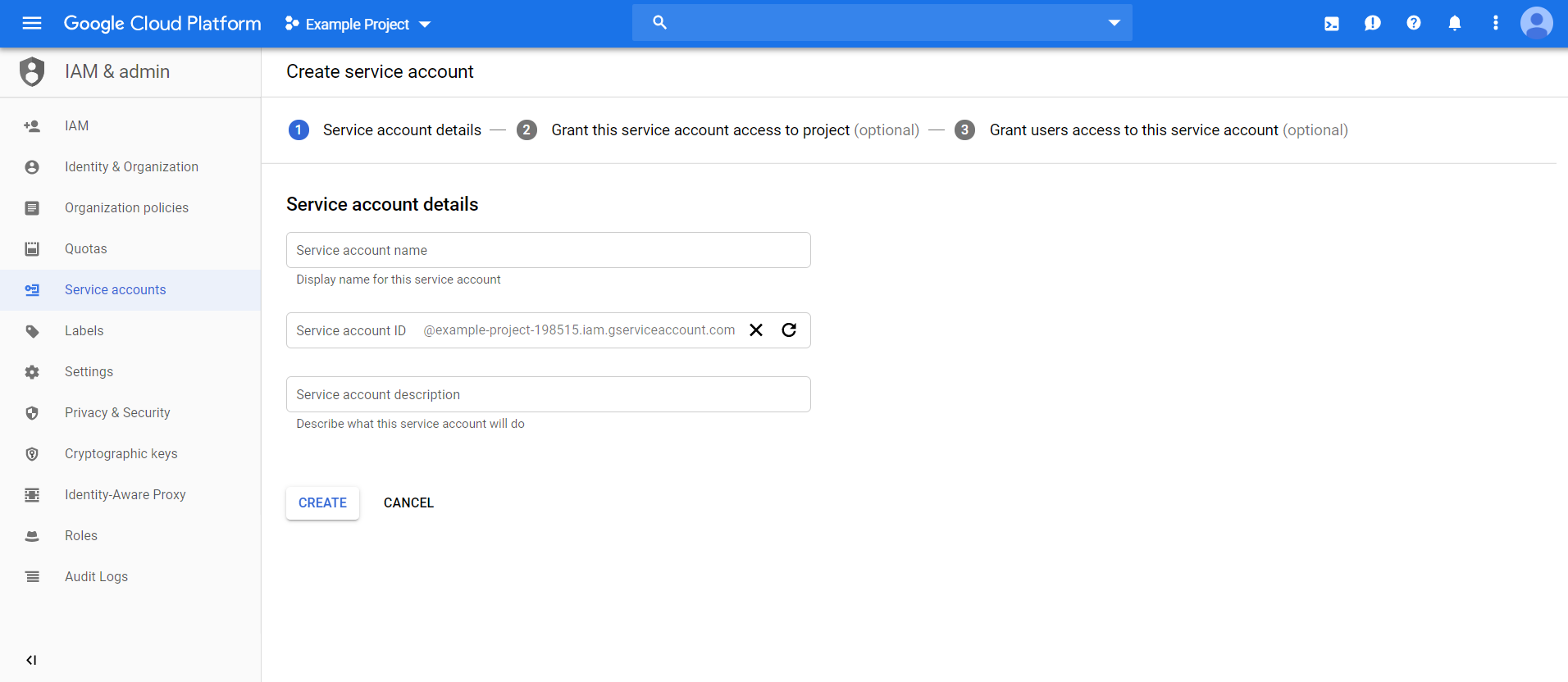

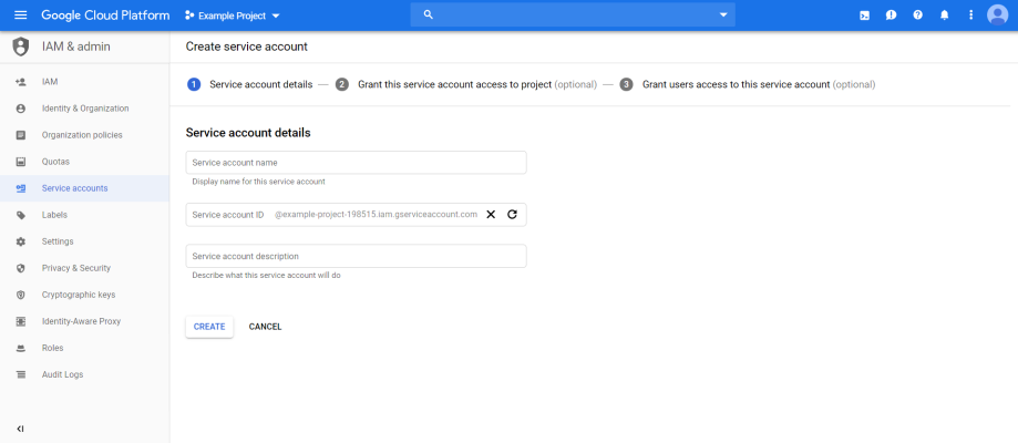

To create a GCP service account:
  1. Log in to the GCP Console and go to the Service accounts page. If prompted, select a project.
  1. Click the CREATE SERVICE ACCOUNT button.
  1. Complete the following fields on the Create service account page:
  • Service account name. Type a name for the service account.
  • Service account ID. This field auto-populates with a service account ID that is based on your Service account name.
  • Service account description. Type a description for the service account.
  1. Click Create. Your service account is created, and the Service account permissions page displays.

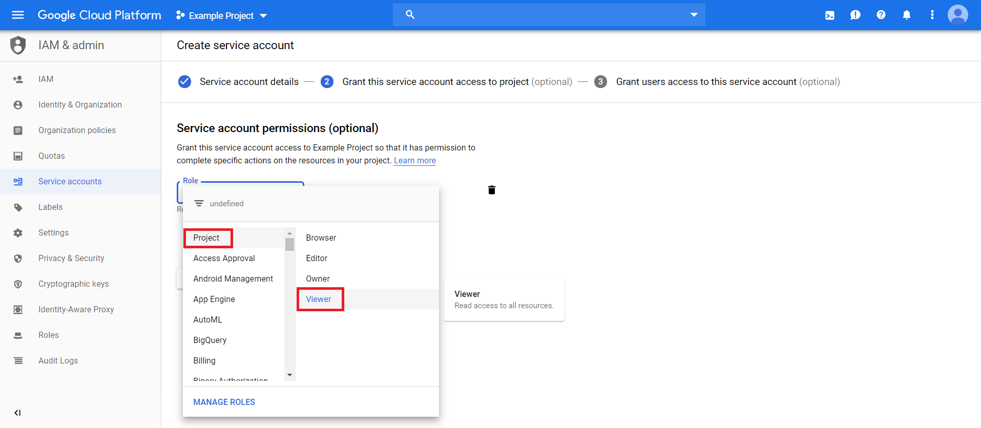

  1. Complete the following fields on the Service account permissions page:
  • Role. Select Project > Viewer.
At a minimum, the service account must have a role of "Project" with "Viewer" permissions for the GCP service that you want to monitor.

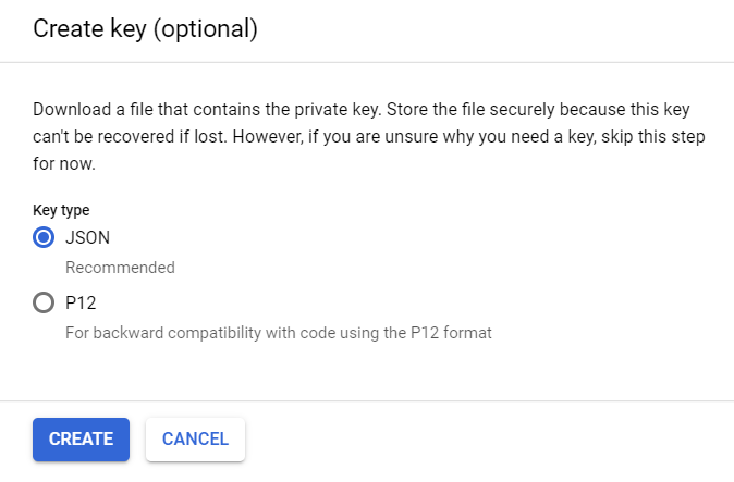

  2. Click Create Key. The Create key pane appears.
  1. On the Create key pane, select the JSON radio button and then click Create. The private JSON key is saved to your computer.
  1. Click Close, and then click Done.
  1. Open the JSON file that was downloaded to your computer and copy the following information:

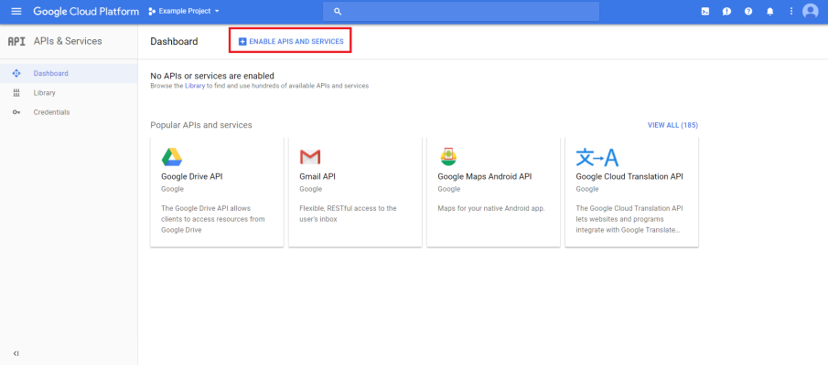

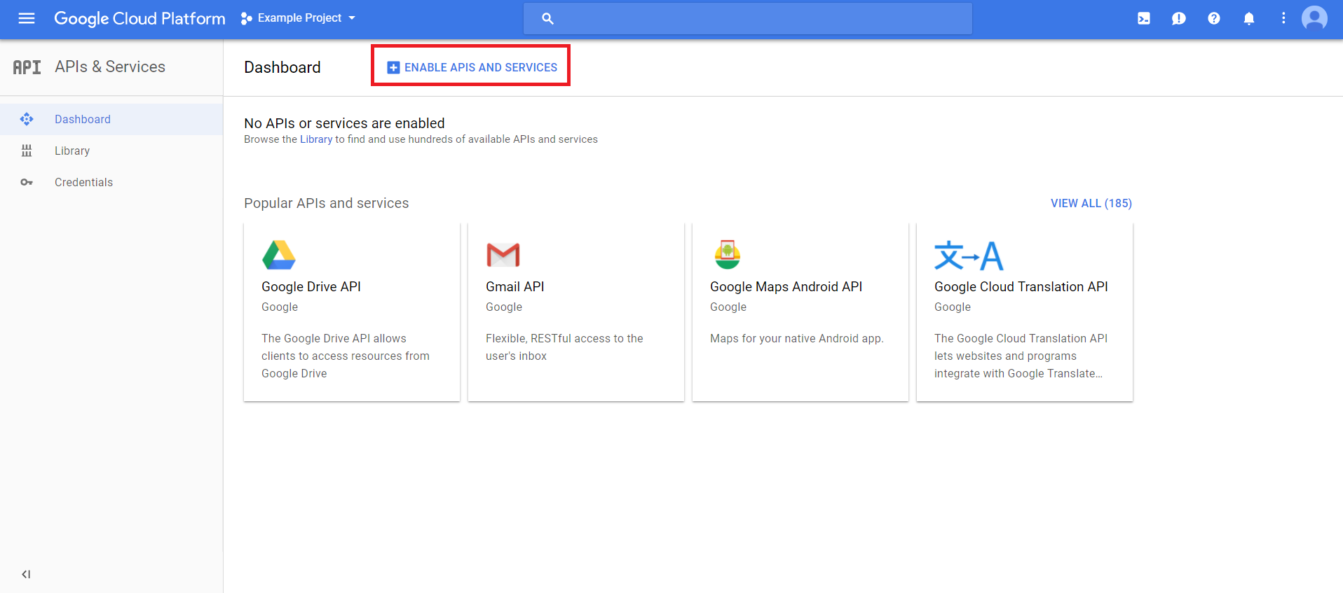

  1. Log in to the GCP Console for your project and go to the API & Services Dashboard page.
  1. Click ENABLE APIS AND SERVICES. The API Library page appears.

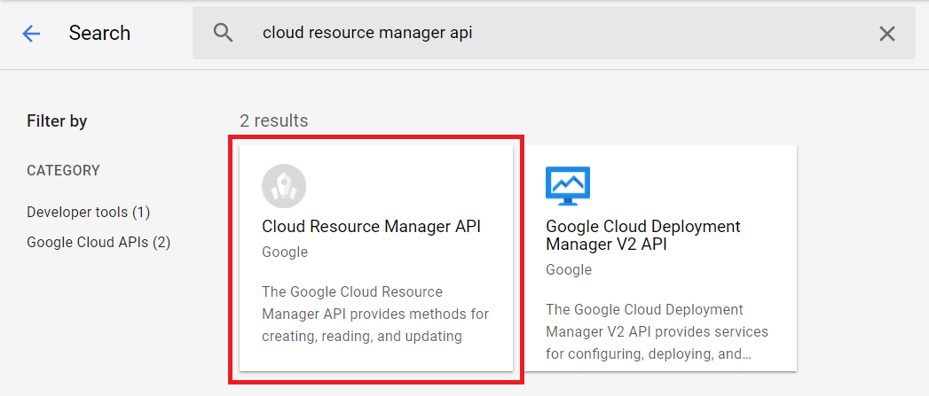

  1. In the search bar, type "Cloud Resource Manager API". The page will filter search results while you type.
  1. Click the Cloud Resource Manager API box.
  1. On the Cloud Resource Manager API page, click the Enable button.
  2. Click Dashboard on the API & Services left menu and then repeat steps 2-5 to enable the Compute Engine API.

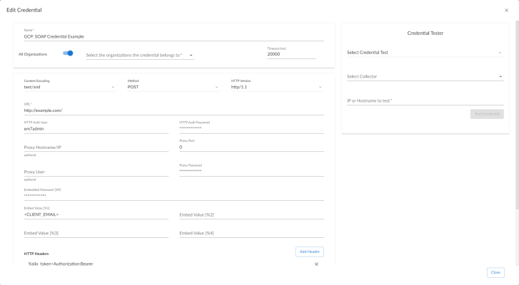

Creating a SOAP/XML Credential for Google Cloud Platform

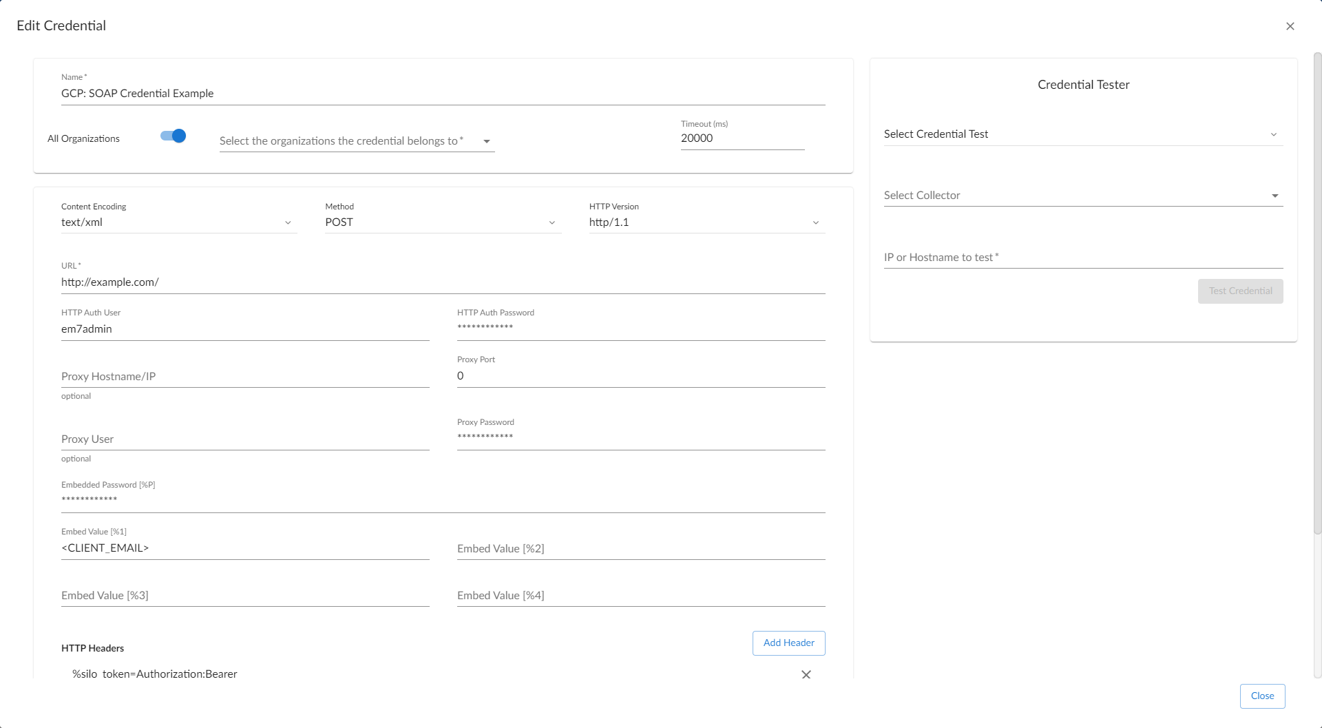

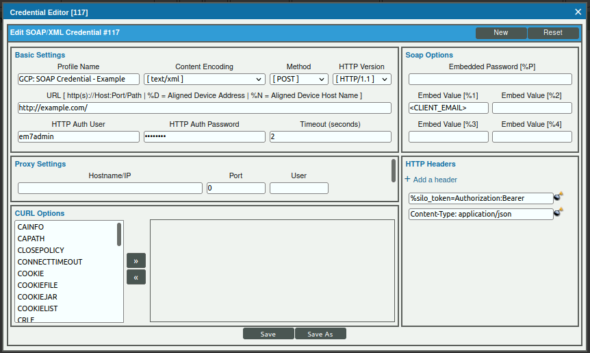

To configure SL1 to monitor GCP, you must create a SOAP/XML credential that allows the Dynamic Applications in the Google Cloud Platform PowerPack to connect with your GCP service. An example SOAP/XML credential that you can edit for your own use is included in the Google Cloud Platform PowerPack.
  2. Locate the GCP: SOAP Credential Example sample credential, click its Actions icon () and select Duplicate. A copy of the credential, calledGCP: SOAP Credential Example copy appears.
  3. Click the Actions icon () for the GCP: SOAP Credential Example copy credential and select Edit. The Edit Credential modal page appears.
  4. An image of the Edit Credential page.
  • Name. Type a new name for your Google Cloud credential.
SOAP Options
  • Embedded Password [%P]. Paste the "private_key" value from the private key JSON file.
  • Embed Value [%1]. Type the "client_email" value from the private key JSON file. For example: myprojectid@myaccount.iam.gserviceaccount.com.
When you copy the "private_key" from the JSON file, it must include the "BEGIN PRIVATE KEY" and "END PRIVATE KEY" lines, including all leading and ending dashes.
  2. Click Save & Close .
The SOAP/XML credential tester is not supported by the Google Cloud Platform PowerPack
To create a SOAP/XML credential to access GCP:
  1. Locate the GCP: SOAP Credential Example and then click its wrench icon (). The Edit SOAP/XML Credential modal page appears.
Basic Settings
SOAP Options
  2. Click the Save As button, and then click OK.

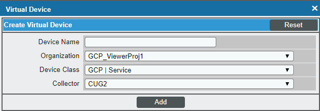

Because the GCP service does not have a static IP address, you cannot discover GCP devices using a regular discovery session. Instead, you must create a virtual device that represents the GCP service. A virtual device is a user-defined container that represents a device or service that cannot be discovered by SL1. You can use the virtual device to store information gathered by policies or Dynamic Applications.
To create a virtual device that represents your GCP service:
  1. Click the Actions button and select Create Virtual Device from the menu. The Virtual Device modal page appears.
  • Device Class. Select GCP | Service.

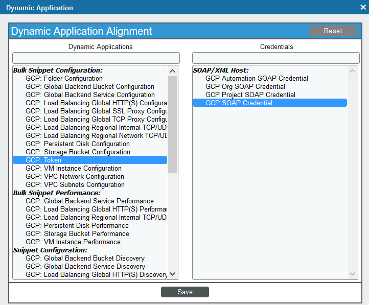

To manually align these Dynamic Applications:
  1. Click the wrench icon () for your GCP virtual device.
  3. Click the Actions button and select Add Dynamic Application from the menu.
  1. In the Dynamic Application Alignment modal:
  • In the Dynamic Applications field, select GCP Token.
  • In the Credentials field, select the credential you created for your GCP service.
  1. Click Save to align the Dynamic Application with the GCP virtual device.
  2. Repeat steps 2-6 to align the "GCP Project Discovery" or "GCP Project Discovery" Dynamic Application, depending on whether you are discovering an Organization or a Project.
You must align the "GCP: Token" Dynamic Application before you align the "GCP: Organization Discovery" or "GCP: Project Discovery" Dynamic Application.

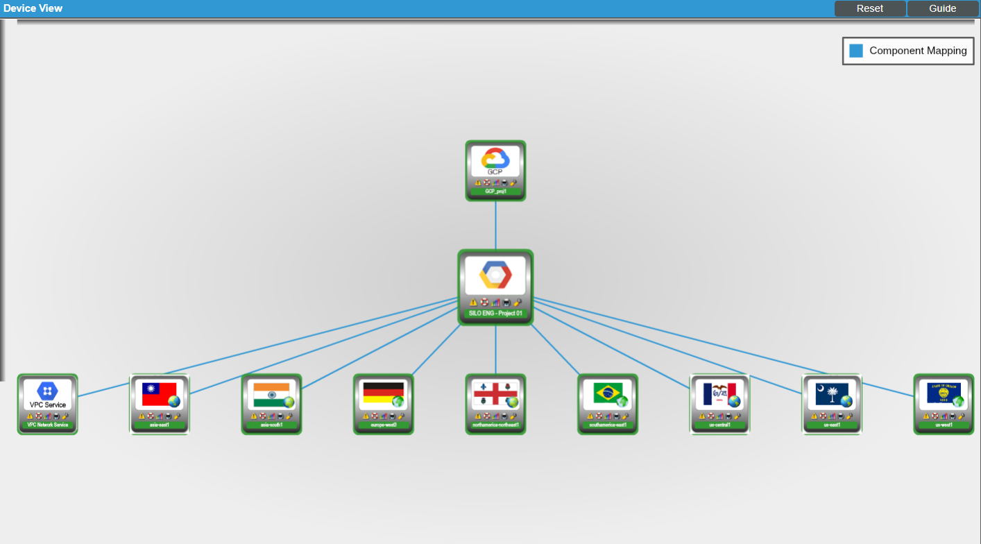

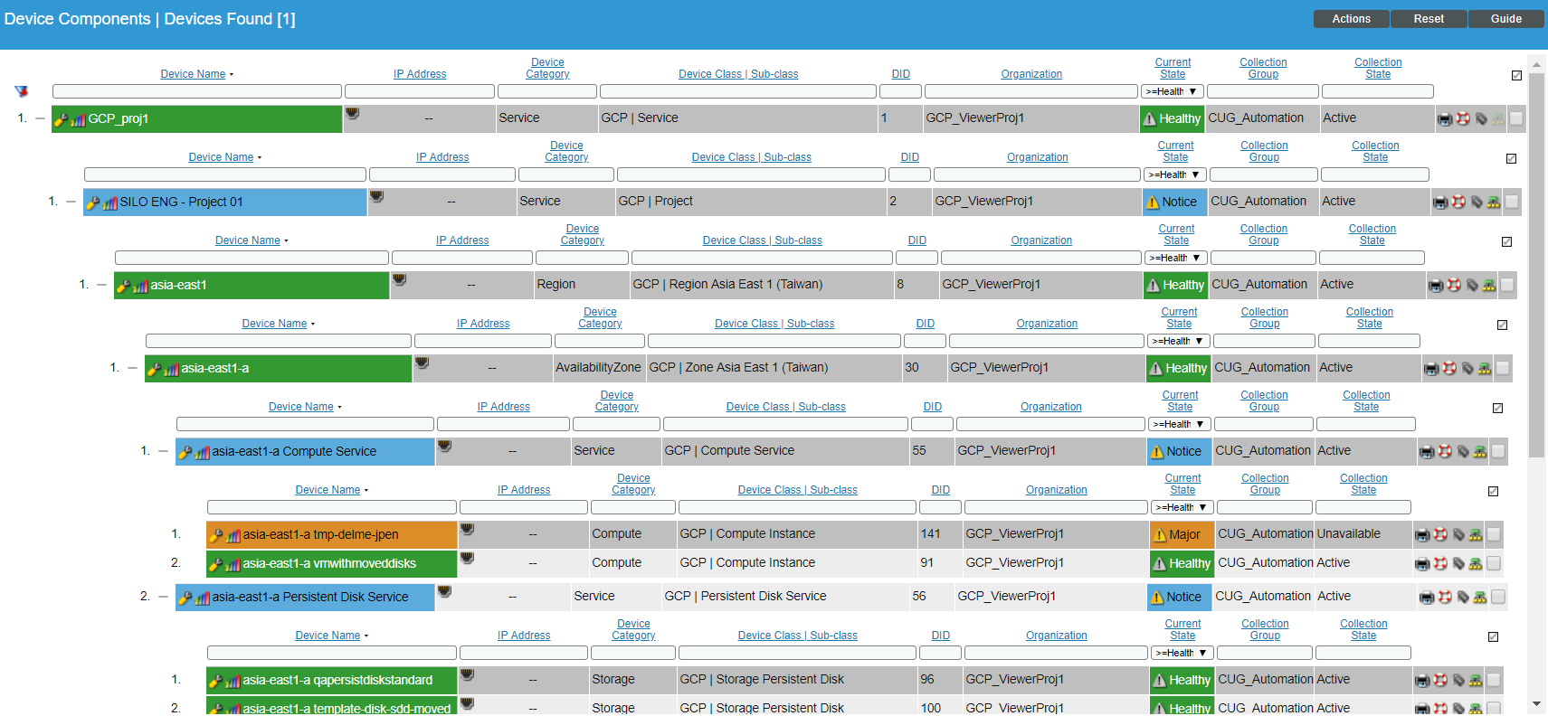

Viewing Google Cloud Platform Component Devices
In addition to the Device Manager page (Registry > Devices > Device Manager), you can view the GCP service and all associated component devices in the following places in the user interface:
  • The Device Components page (Registry > Devices > Device Components) displays a list of all root devices and component devices discovered by SL1 in an indented view, so you can easily view the hierarchy and relationships between child devices, parent devices, and root devices. To view the component devices associated with the GCP service, find the GCP virtual device and click its plus icon (+):
  • The Component Map page (Classic Maps > Device Maps > Components) allows you to view devices by root node and view the relationships between root nodes, parent components, and child components in a map. This makes it easy to visualize and manage root nodes and their components. SL1 automatically updates the Component Map as new component devices are discovered. The platform also updates each map with the latest status and event information. To view the map for the GCP service, go to the Component Map page and select the map from the list in the left NavBar. To learn more about the Component Map page, see the section on Views.
