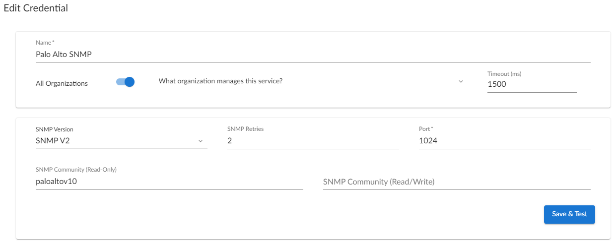

Some of the Dynamic Applications in the Palo Alto Base Pack PowerPack use SNMP to collect information about Palo Alto firewalls. To use these Dynamic Applications, you must first define an SNMP credential that enables SL1 to communicate with the firewalls.
To configure an SNMP credential:
  2. Click Create Newand then click Create SNMP Credential.
  • Timeout (ms). Time, in milliseconds, after which SL1 will stop trying to communicate with the device from which you want to retrieve data.
  • SNMP Version.
    • Select SNMP V2 (default)
    • Select SNMP V3 for enhanced security
  • SNMP Community (Read Only). Type the community string for the Palo Alto firewalls you want to monitor.
  • Port. Use the default setting.

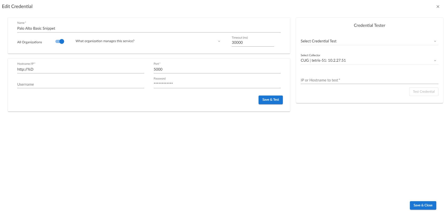

To configure SL1 to monitor Palo Alto devices, you must also create a Basic/Snippet credential. This credential enables some of the Dynamic Applications in the Palo Alto Base Pack PowerPack to connect with those devices.
To create a Basic/Snippet credential for Palo Alto devices:
  2. Click Create New and then click Create Basic/Snippet Credential.
  • Timeout (ms). Type "30000".
  • Hostname/IP. Type "https://%D".
  • Port. Type "443".
  • Username. Type the username for a user account with access to the Palo Alto firewalls.
  • Password. Type the password for the Palo Alto user account.

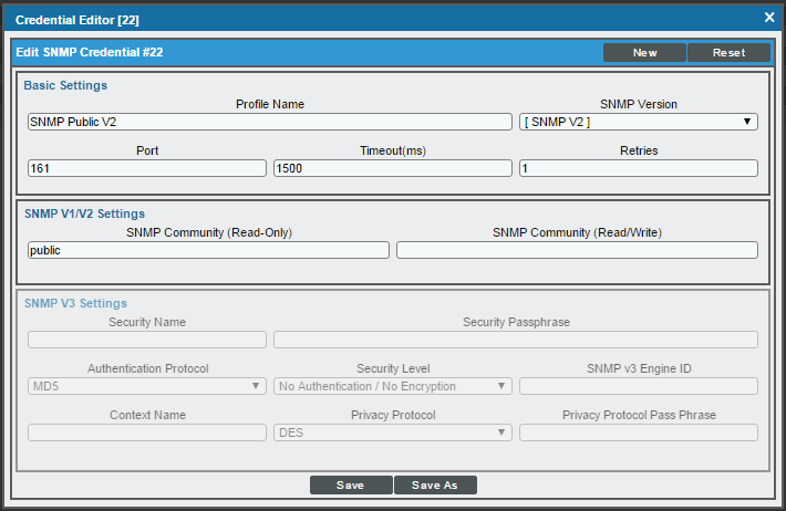

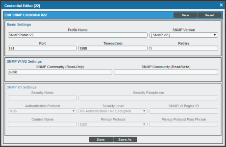

  1. Click the Actions button and then select Create SNMP Credential. The Credential Editor page appears.
Image of the SNMP Credential Editor page
  • SNMP Version. Select the version of the SNMP you wish to use.
  1. Supply values in the other fields on this page as needed. In most cases, you can accept the default values for the other fields.
  2. Click the Save button.

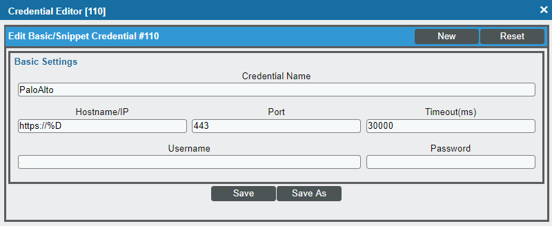

  2. Click the Actions button and then select Create Basic/Snippet Credential. The Credential Editor page appears.
  • Port. Type "443".
  • Timeout. Type "30000".
  1. Click the Save button.

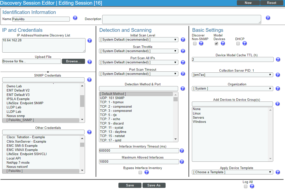

  1. The Discovery Session Editor page appears. In the Discovery Session Editor page, complete the following fields:
Image of the Discovery Session Editor page
  • IP Address/Hostname Discovery List. Type the IP address or addresses for the Palo Alto devices that you want to discover.
  • SNMP Credentials. Select the SNMP credential you created for the Palo Alto devices.
  • Other Credentials. Select the Basic/Snippet credentials you created for the Palo Alto devices.
  2. Click the Save button to save the discovery session, and then close the Discovery Session Editor window.
