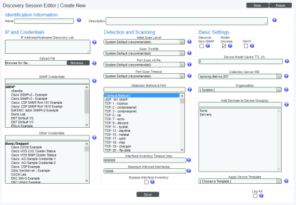

  2. In the Discovery Control Panel page, click Create.
  1. The Discovery Session Editor page appears. In the Discovery Session Editor page, supply values in the following fields:
  • Name. Enter a name for the discovery session. This name is displayed in the list of discovery sessions in the Discovery Control Panel page.
  • IP Address/Hostname Discovery List. Provide a list of the IP addresses or fully qualified domain names of the SNMP-enabled devices you want to discover.
  • SNMP Credentials. Select the SNMP credentials you created for the SNMP-enabled devices. You can select multiple credentials in this field.
  1. Optionally, supply values in the other fields in this page. For a description of the fields in this page, see the Discovery and Credentials section.
  2. Click Save.
  3. The Discovery Control Panel page will refresh. Click the lightning bolt icon () for the discovery session you just created.
  4. In the pop-up window, click OK. The page displays the progress of the discovery session.
