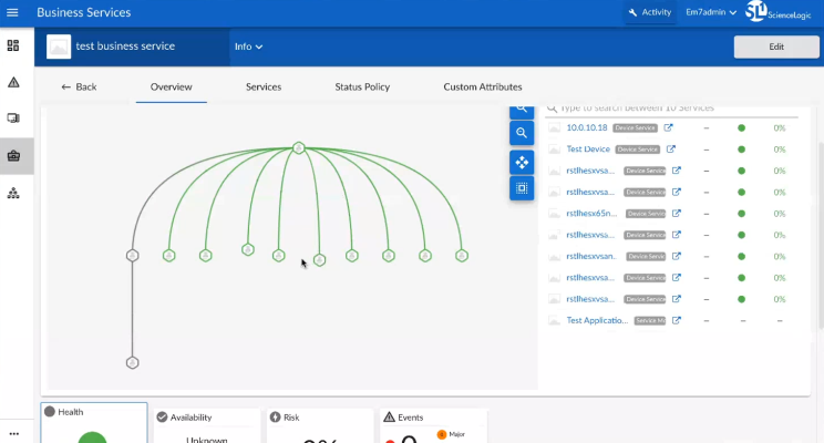

Syncing Business Services from SL1 to ServiceNow
The Sync Business Services from SL1 to ServiceNow application reads Business Services, IT Services, and Device Services from SL1 and syncs them with business services in ServiceNow. This application creates and updates services, but it does not delete services.
The "Sync Business Services from SL1 to ServiceNow" application does not currently support deleting or disconnecting services within ServiceNow. The application logs for the "Post to ServiceNow" step might contain information regarding disconnects, but you can ignore that information.
If a Device Service does not have a parent IT Service, the CMDB Group will be created, but the CI will not be created because of the way PowerFlow pulls each of those items. At the time of the Group creation, PowerFlow does not know if a service has a parent or not. At the time of the CI creation, PowerFlow does not directly pull Device Services; it only pulls Business Services and IT Services and their children.
PowerFlow only syncs business services that are aligned with devices that are already synced with ServiceNow. Before setting up business service sync, you must first sync devices between SL1 and ServiceNow.

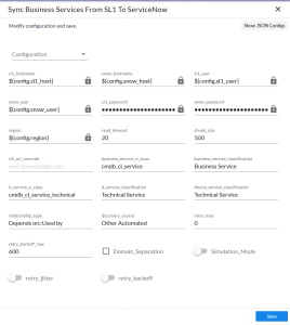

  8. Click Configure to open the Configuration pane:
  9. Complete the following fields, as needed:
  • Configuration. Select the relevant configuration object to align with this application. You cannot edit fields that are populated by the configuration object. Required.
    The region field is populated by the configuration object you aligned with this application. The region value must match the value in the SL1 Region field in ServiceNow. If you need to update this value, you will need to define the region variable in the configuration object that is aligned with this application, or align a different configuration object that has the correct region value.
  • read_timeout. Specify the maximum amount of time in seconds the application should wait for a response before timing out. The default is 20 seconds.
  • sl1_chunk_size. Specify the number of services to include in each chunk sent to ServiceNow when you run this application. The default chunk size is 500.
  • snow_request_limit. Specify the number of CIs fetched from ServiceNow in each request. The default is 500 objects per chunk.
  • sl1_url_override. Specify a URL that is different from the standard SL1 URL that gets sent to the ServiceNow CI record. Optional.
  • business_service_ci_class. Specify the ServiceNow CI Class for Business Services. The default is cmdb_ci_service.
  • it_service_ci_class. Specify the ServiceNow CI Class for IT Services. The default is cmdb_ci_service_technical.
  • business_service_classification, it_service_classification, and device_service_classification. Use these fields to update the default service classifications. Optional.
  • relationship_type. Specify the relationship type string to use between services. The default is Depends on::Used by.
  • discovery_source. Specify the ServiceNow Discovery source. The default is "Other Automated".
  • verify_snow_ssl. Toggle on (blue) this option to enable verification of the SSL certification when you run this application.
  • snow_batch_size. Specify the total number of CIs being sent to ServiceNow in each triggered application. The default is 150 objects per batch.
  • snow_chunk_size. Specify the number of CI objects to send in each chunk or in each sub-payload with a batch (specifed in the snow_batch_size field). The default is 150 objects per chunk or sub-payload.
  • retry_max. The maximum number of times PowerFlow will retry to execute the step before it stops retrying and logs a step failure. For example, if retry_max is 3, PowerFlow will retry after 1 second, then 2 seconds, then 4 seconds, and stop if the last retry fails. The default is 0.
  • retry_backoff_max.The maximum time interval for the retry_backoff option, in seconds. For example, if you have retry_max set to 15, the delays will be 1, 2, 4, 8, 16, 32, 64, 120, 240, 480, 600, 600, 600, 600, and 600. The default is 600.
  • Domain_Separation. Select this option if your ServiceNow environment is domain-separated, where the data, processes, and administrative tasks have been organized into logical groupings called domains. If your ServiceNow instance is domain-separated, the user listed in the snow_user field must be a member of the top domain and have access to all of the domains you intend to integrate. Also, ServiceNow should be the "source of truth" for organizations if your environment is domain-separated.
  • Simulation_Mode. Select this option if you want to perform a simulated run of this application to show you the potential results of that run.

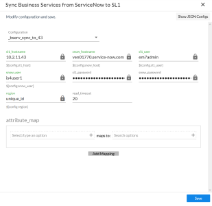

  6. Click Configure () to open the Configuration pane:
  7. Complete the following fields, as needed:
    • attribute_map. In this section, click Add Mapping if you want to create a mapping for any other asset fields that you want to sync between SL1 (the first column) and ServiceNow (the second column).
  8. In the Company Mapping Override section, you can create a new mapping for the ServiceNow company field. You can override the company field with a different ServiceNow field where you can read and write the company_sys_id for CIs.
  9. Click Save. The Configuration pane automatically closes.
  10. Click Run to run the application. When the application completes, the ServiceNow business services will be available on the Business Services page of SL1:

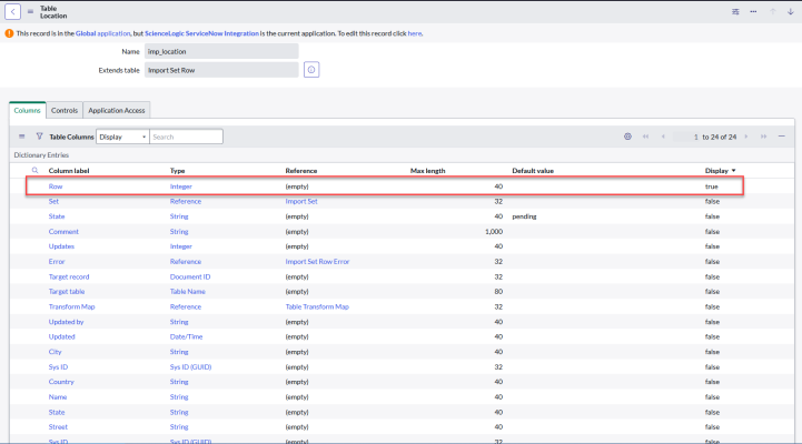

The following image shows the Location table, and the Display column shows the Name marked as true. Only one field on the table can be marked as true, and that is the field that will be returned to PowerFlow :

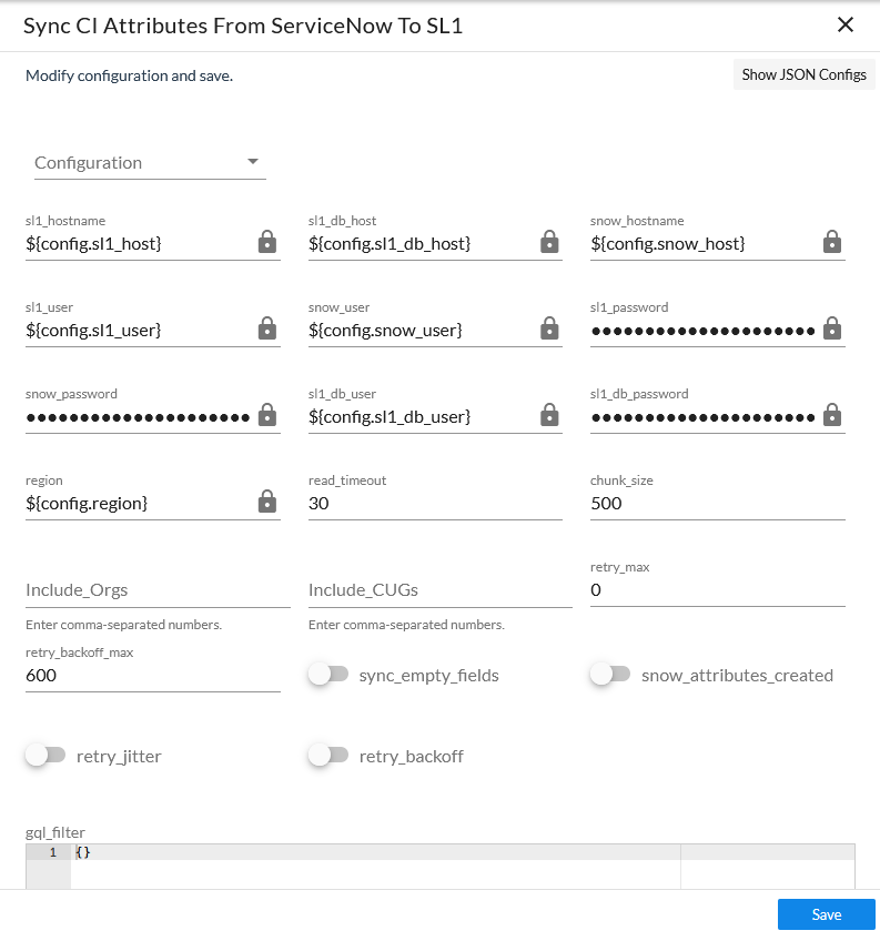

  4. Click Configure. The Configuration pane appears:
  5. Complete the following fields, as needed:
  • Configuration. Select the configuration object with the relevant SL1 and ServiceNow credentials to align with this application. You cannot edit fields that are populated by the configuration object. Required.
    The region field (along with other fields related to user names and passwords) is populated by the configuration object you aligned with this application. The region value must match the value in the SL1 Region field in ServiceNow. If you need to update this value, you will need to define the region variable in the configuration object that is aligned with this application, or align a different configuration object that has the correct region value.
  • read_timeout. Specify the maximum amount of time in seconds that the application should wait for a response before timing out. The default is 20 seconds
  • chunk_size. Specify the number of devices to include in each chunk sent to ServiceNow when you run this application. The default chunk size is 500 devices.
  • Include_Orgs. If you want to include SL1 Organizations in the sync, add the Organization IDs from SL1 in this field, separated by commas. Leave this field empty to sync all SL1 Organizations. This option filters on the ServiceNow CI sync as well as the SL1 Device sync.
  • Include_CUGs. If you want to include SL1 Collector Groups (CUGs) in the sync, add the Collector Group IDs from SL1 in this field, separated by commas. Leave this field empty to sync all SL1 Collector Groups.
  • sync_empty_fields. Select this option if you want to include empty fields on ServiceNow CIs when you run this application. This option is disabled by default.
    SL1 does not return extended custom attributes for devices if no value is present. As a result, if the value for the custom attribute is empty in ServiceNow, PowerFlow will continually send updates for those devices, because the empty value written to is not returned in subsequent runs of the application. When the sync_empty_fields option is selected, the application sends a 0 or '', depending on the attribute type for the custom attributes in the mappings for all devices.
  • snow_attributes_created. Select this option to show that custom attributes for ServiceNow sys_id and ci_class already existing in SL1.
  • retry_jitter. When selected, instead of using a defined interval between retries, PowerFlow will retry the step execution at random intervals. The default is unselected.
  • retry_backoff. When selected, instead of using a defined interval between retries, PowerFlow will incrementally increase the interval between retries. The default is unselected.
  • gql_filter. Specify a custom GraphQL filter to apply to the devices in the sync. An example of a Device Search GraphQL query is: {"name": {"doesNotBeginWith": "jc-is-ma"}}
  1. In the Mappings section, click the Edit button (PowerFlow 2.7.0 or later) or the expand button () to view and edit the mappings between ServiceNow CI classes and SL1 device classes. You can map a single ServiceNow CI class with multiple SL1 device classes.
    If no mappings are provided in this section, the application will only pull CI classes provided in the "Sync Devices from SL1 to ServiceNow" application. If you add mappings in this section, only CI classes that were included in this section will be returned from ServiceNow.
    For more information about how to view, edit, and create mappings, see Editing Mappings in a PowerFlow Application. This topic also covers how to use the Company Mapping Override and the Attribute Mappings sections, below.
  2. In the Company Mapping Override section, you can create a new mapping for the ServiceNow company field. You can override the company field with a different ServiceNow field where you can read and write the company_sys_id for CIs.
  3. In the Attribute Mappings section, click the Edit button (PowerFlow 2.7.0 or later) or the expand button () to view and edit mappings for any other custom attributes you want to sync between SL1 (the first column) and ServiceNow (the second column). For more information, including lists of default and available device attribute mappings, see Device Attribute Mappings.
    To sync a user-defined field on the ServiceNow CI record to the device notes table in SL1, create a custom attribute mapping for that field in this section. This option works best if you only want a single value synced over so that value can remain in the notes.
    For the Attribute Mappings section, you can use a Jinja2 Template for device attribute fields on the SL1 side (the left column). For more information, see Using a Jinja2 Template.
    When an attribute value is "0" in SL1, the corresponding field in ServiceNow might display as empty.
  4. Click Save. The Configuration pane automatically closes.
  5. Click Run to run the "Sync CI Attributes from ServiceNow to SL1" application.

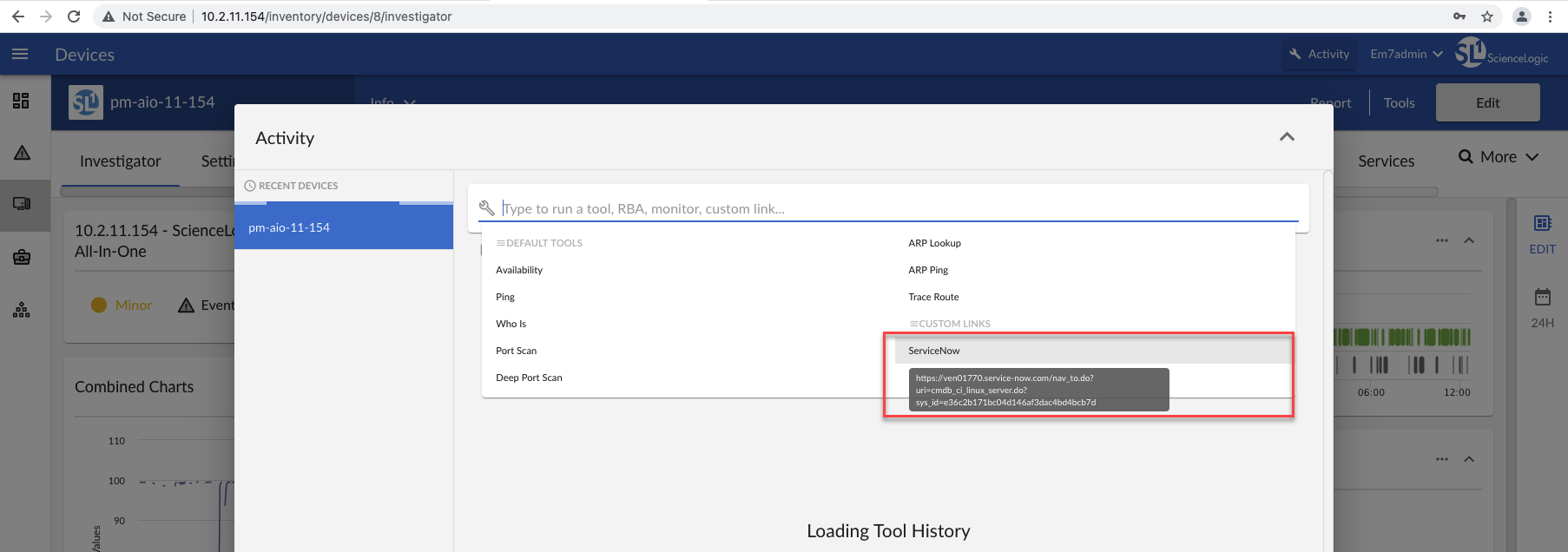

Creating a Link in an SL1 Device to a ServiceNow CI
To help you mange your SL1 devices and their corresponding ServiceNow CIs, you can create a link in an SL1 Device that goes directly to the synced CI in ServiceNow.
The "Create Custom Attributes and ServiceNow Custom Link in SL1" PowerFlow application creates servicenow_sys_id and servicenow_ci_class custom device attributes in SL1, and then SL1 uses those two attributes to create a custom link in SL1 titled ServiceNow that redirects to the ServiceNow CI.
In SL1, the link appears as a custom link on the Tools menu for the corresponding device:
The application only creates the custom attributes if the attributes do not already exist. Additionally, if the custom link functionality is disabled by default on SL1, the application will enable the feature before creating the necessary attributes and link.
To create a link for the SL1 device:
  1. In the PowerFlow user interface, go to the Applications page and open the "Sync CI Attributes from ServiceNow to SL1 to ServiceNow" application.
  2. Click the Configure button. The Configuration pane appears.
  3. Enable the snow_attributes_created toggle and click Save.
  4. Click Run to run the application.
  5. On the Applications page, open the "Create Custom Attributes and ServiceNow Custom Link in SL1" PowerFlow application, align a configuration object if needed, and click Run to run the application.
You only need to run the "Create Custom Attributes and ServiceNow Custom Link in SL1" application once.

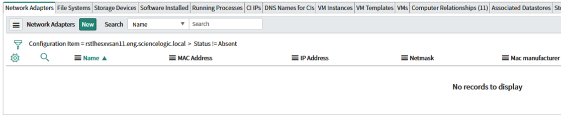

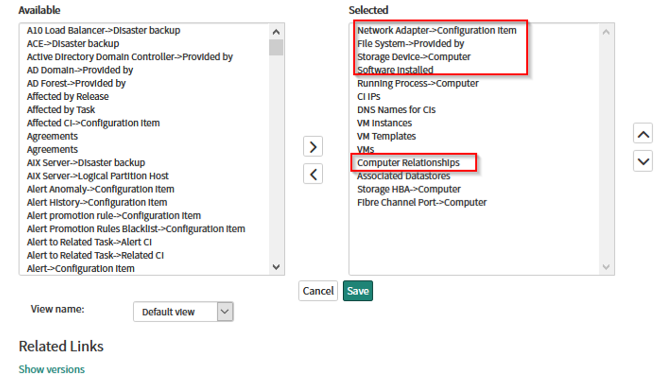

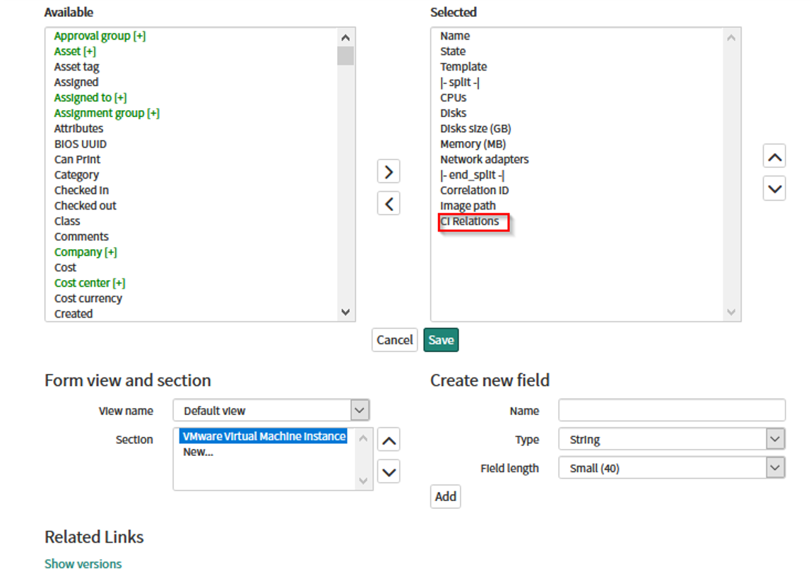

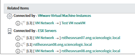

Adding Related Items and Lists to the CI Record in ServiceNow
In ServiceNow you can add Related Items and Related Lists to CI records so you can see all related records in ServiceNow. The following image shows the Related Items pane on a CI record for a VMware Virtual Machine Instance:
The following image shows how to add Related Items for a VMware Virtual Machine instance by selecting the CI relations option.
The following image shows the related lists for network adapters and files systems:
The items highlighted by the red boxes below are the most commonly used items:
For more information, see the ServiceNow Documentation at https://docs.servicenow.com/bundle/paris-platform-user-interface/page/use/using-forms/concept/c_RelatedLists.html.

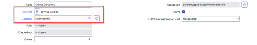

To configure the ServiceNow service requests for Discovery Sync:
  1. In ServiceNow, go to the Catalog Items page (Service Catalog > Catalog Definitions > Maintain Items).
  2. Type "ScienceLogic" in the Category column. The Device Discovery and Monitoring Removal service requests appear in the search results.
  3. Open the Device Discovery service request and ensure that the Catalogs and Category fields are accurate. For example:
NOTE: Do not set the Category to a Change Request.
  1. If you need to update these fields, click the Edit in Catalog Builder button at the top of the detail page.
  2. Update the fields and click the Update button to save your changes.
  3. From the Catalog Items page, click the check box for the Device Discovery service request and click the Activate button at the bottom of the Catalog Items window.
NOTE: This service request is instance-specific, which means that the service request will appear in the same location as the catalogs you specified for that request. In the example, above, the Catalog was set to Service Catalog.

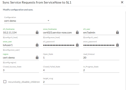

  1. Sync Service Requests from ServiceNow to SL1. This application sends the request forms to SL1. This application was called "Sync Discovery Session Requests from ServiceNow to SL1" in previous versions of the SyncPack. This application uses one or more of the following options from the Configuration pane:
  • Open_State. The State ID from ServiceNow that specifies which Requested Items (RITMs) to pull and process. The default is 1.
  • Closed_Success_State. The State ID for a successfully created virtual device. The State ID for a successful run changes from 1 to 2 and then ends with 4. The default is 3.
  • Closed_Failed_State. The State ID for failed discoveries or failed virtual device creation, usually caused by invalid payloads. The State ID for a failed run changes from 1 to 2 and then ends with 4. The default is 4.
  • In_Progress_State. The State ID for RITMs for a running discovery. The default is 2.
  • target_vcug. Leave this field blank.
  • recursively_disable_children. Leave this field blank.

  1. In the PowerFlow user interface, select the "Sync Service Requests from ServiceNow to SL1" application from the Applications page and click Configure. The Configuration pane appears:
  1. Complete the following fields, as needed:
  • Closed_Failed_State The State ID for failed discoveries or failed virtual device creation, usually caused by invalid payloads. The State ID for a failed run changes from 1 to 2 and then ends with 4. The default is 4.
  1. Click Save. The Configuration pane automatically closes.
  2. Click Run to run the application.

  3. In the PowerFlow user interface, select the "Sync Service Requests from ServiceNow to SL1" application from the Applications page and click Configure on the application detail page. The Configuration pane appears:
  • recursively_disable_children. Check this option to move all child devices of the devices you are decommissioning to the VCUG. If this option is not checked and a parent device is in the disable request, the parent device will be skipped with a warning message.
  • target_vcug. Specify the ID of the SL1 Virtual Collection Group (VCUG) you created to hold the devices on the Collector Group Settings page (System > Settings > Collector Groups). If this value is null, the application will attempt to pull the value from the target_vcug field in the "Delete Devices from SL1" application.
  1. Click Save. The Configuration pane automatically closes after this message appears.

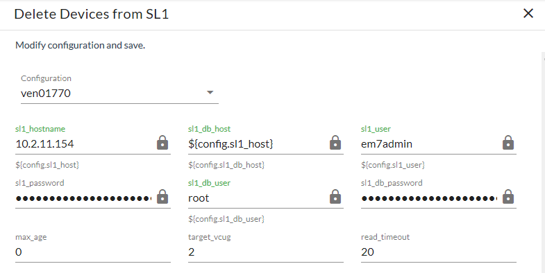

  2. On the Applications page, select the "Delete Devices from SL1" application and click Configure on the application detail page. The Configuration page appears:
  • max_age. Specify how long (in days) that you want to keep the devices in the VCUG before deleting the devices. The default is 0 days. If this setting is 0, all devices in the VCUG will be deleted as soon as this application runs. If this setting is null, the application will fail. If all device children are in the same VCUG, the application will delete the target device and all of its children.
  • target_vcug. Specify the ID of the SL1 Virtual Collection Group (VCUG) you created to hold the devices on the Collector Group Settings page (System > Settings > Collector Groups). Set this value to -1 if you want this applications to use the target_vcug value from the "Sync Service Requests from ServiceNow to SL1" application.
    If you specify a value to target_vcug here, the "Delete Devices from SL1" application will use that value instead of the target_vcug value from the "Sync Service Requests from ServiceNow to SL1" application.

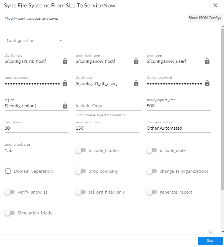

  1. In the PowerFlow user interface, go to the Applications page and run the "Cache ServiceNow Companies, CIs and SL1 Orgs, Device Classes" application to read all existing SL1 Device Classes, Organizations, ServiceNow CIs, and Companies and write them to a cache.
  2. When that application completes, go to the Applications page and select the "Sync File Systems from SL1 to ServiceNow" application.
  3. Click Configure to open the Configuration pane:
  4. Complete the following fields, as needed:
    The region field (along with other fields related to user names and passwords) is populated by the configuration object you aligned with this application, using the Configuration field. The region value on this pane must match the value in the SL1 Region field in ServiceNow. If you need to update this value, you will need to define the region variable in the configuration object aligned with this application, or align a different configuration object that has the correct region value.
  • Include_Orgs. If you want to include a specific set of SL1 Organizations in the sync, add the Organization IDs from the SL1Organizations page () in this field, separated by commas. If this field is enabled, PowerFlow will pull only the Organizations listed in this field; PowerFlow does not pull all Organizations and then drop those not on the list. Leave this field empty to sync all SL1 Organizations. Optional.
  • snow_request_limit. Specify the number of objects fetched from ServiceNow in each request. The default is 500 objects per chunk.
  • read_timeout. Specify the maximum amount of time in seconds the application should wait for a response before timing out. The default is 30 seconds.
  • snow_batch_size. Specify the total number of objects being sent to ServiceNow in each triggered application. The default is 150 objects per batch.
  • snow_chunk_size. Specify the number of objects to send in each chunk or in each sub-payload with a batch (specifed in the snow_batch_size field). The default is 150 objects per chunk or sub-payload.
  • include_hidden. Select this option to sync hidden file systems. This filter is only applied on the SL1 side of the sync. By default, this option is not selected.
  • include_stale. Select this option to sync stale file systems. This filter is only applied on the SL1 side of the sync. By default, this option is not selected.
    Be cautious when applying these include options, as enabling one or both options might cause unwanted disconnects if the File System Sync is run with these options enabled and then run with the options disabled.
  • sync_unsupported_file_systems. Toggling this on will allow file systems that have a parent device class of Network.Switch or Network.Router to sync when the application is run.
  • change_fs_organizations. Toggle on (blue) this option to allow file systems to change companies with an Interface Sync if the companies are within the same domain in ServiceNow. If you change the Organization/Company and another field, but do not enable this parameter, PowerFlow will not apply any changes to the file system. By default, this option is not selected.
  • drop_company. Toggle on (blue) this option to remove the sys_id in existing companies from the sync. This will prevent the "Company" field from sending to ServiceNow. This option has no effect if the domain_separation parameter is enabled for this application. By default, this option is not selected.
    If you select this option, the ServiceNow company sys_id for the file system and the SL1 organization crm_id for the SL1 device will not be compared when determining if an update has occurred. Do not select this option if you selected the Domain_Separation option, as ServiceNow requires PowerFlow to send the "company" field in domain-separated environments. Also, do not select this option if you selected the change_interface_organizations option, as changing the company for a file system in ServiceNow requires the "company" field to be sent.
  • sl1_org_filter_only. Toggle on (blue) this option to apply the organization filter to only the SL1 side of the data pull.
    Enabling this toggle will only apply organization filtering to the SL1 side of the data pulls, while all file systems for the provided region in ServiceNow will be returned. Be cautious using this option, as enabling it may cause unwanted disconnects in ServiceNow.
  • generate_report. Select this option to create a "Sync File Systems from SL1 to ServiceNow" report. This report contains counts of the number of file systems gathered from SL1 and ServiceNow, the number of unchanged file systems, and the number of creations, updates, and disconnects sent to ServiceNow. Detailed file system information for the file systems sent to ServiceNow is also displayed. Finally, the report contains file systems that are in an unsupported format. The reports are available on the Reports page of the PowerFlow user interface.
    Due to the differences between how SL1 and ServiceNow discover file systems, only certain formats of file systems contained in the SL1 database will be synced to ServiceNow. Only file systems where the name and the mount point can be determined from the name database field stored in the SL1 will be synced.
  • retry_jitter. When selected, instead of using a defined interval between retries, the PowerFlow system will retry the step execution at random intervals. By default, this option is not selected.
  • retry_backoff. When selected, instead of using a defined interval between retries, PowerFlow will incrementally increase the interval between retries. By default, this option is not selected.
  1. In the Company Mapping Override section, you can create a new mapping for the ServiceNow company field. You can override the company field with a different ServiceNow field where you can read and write the company_sys_id for CIs.
  2. In the Attribute Mappings section, click the Edit button (PowerFlow 2.7.0 or later) or the expand button () to view and edit the mappings for any other custom device attributes you want to sync between SL1 (the first column) and ServiceNow (the second column).
  3. Click Save. The Configuration pane closes.

    6. When the application completes, go to ServiceNow and type "cmdb_ci_network_adapter.list". The Network Adapters page appears with a list of synced interfaces.
    7. You can add additional columns to this page using the Update Personalized List button () to add columns like Operational status, which is synced from SL1. The Operational status value is different from the SL1 Monitored value, but PowerFlow tracks both values.
    8. Select a network interface from the list tab to see more information about the interface.

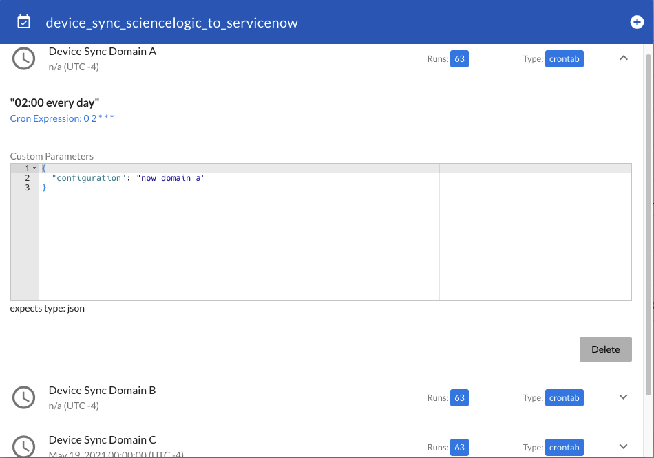

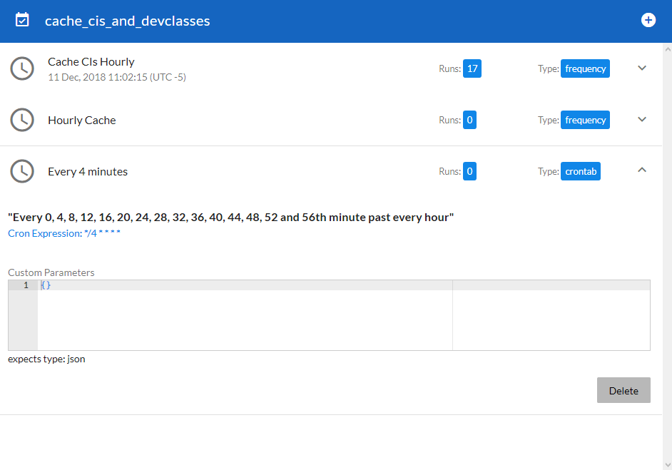

    Using the PowerFlow user interface, you can configure PowerFlow applications to run on a schedule instead of manually running the applications. As a best practice, if you use any of these applications, ScienceLogic recommends that you schedule those applications, in the following order:
    • "Cache ServiceNow CIs and SL1 Device Classes"
    • "Sync Devices from SL1 to ServiceNow"
    • "Sync Interfaces from SL1 to ServiceNow"
    ScienceLogic recommends that you schedule these applications to run at least every 23 hours. You can also schedule additional applications as needed.
    You can create one or more schedules for a single application in the PowerFlow user interface. When creating each schedule, you can specify the queue and the configuration file for that application.
    To schedule an application:

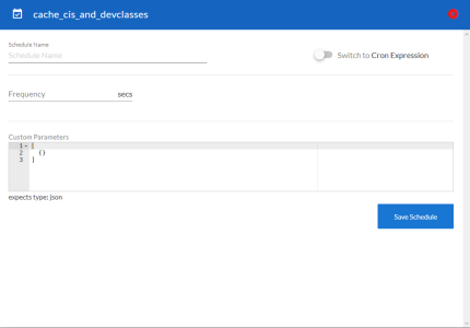

    1. On the Applications page (), click the Schedule button for the application you want to schedule. The Schedule window appears, displaying any existing schedules for that application:
      If you set up a schedule using a cron expression, the details of that schedule display in a more readable format in this list. For example, if you set up a cron expression of */4 * * * *, the schedule on this window includes the cron expression along with an explanation of that expression: "Every 0, 4, 8, 12, 16, 20, 24, 28, 32, 36, 40, 44, 48, 52, and 56th minute past every hour".
    1. Select a schedule from the list to view the details for that schedule.
    2. Click the + icon to create a schedule. A blank Schedule window appears:
    1. In the Schedule window, complete the following fields:
    • Switch to. Use this toggle to switch between a cron expression and setting the frequency in seconds.
    • Cron expression. Select this option to schedule the application using a cron expression. If you select this option, you can create complicated schedules based on minutes, hours, the day of the month, the month, and the day of the week. As you update the cron expression, the Schedule window displays the results of the expression in more readable language, such as Expression: "Every 0 and 30th minute past every hour on the 1 and 31st of every month", based on */30 * * /30 * *.
    • Custom Parameters. Type any JSON parameters you want to use for this schedule, such as information about a configuration file or mappings. The values in this field will override any application variables that exist in the PowerFlow application you are scheduling.
    1. Click Save Schedule. The schedule is added to the list of schedules on the initial Schedule window. Also, on the Applications page, the word "Scheduled" appears in the Scheduled column for this application, and the Schedule button contains a check mark:
    1. On the Applications page, click the Schedule button for the application that contains a schedule you want to delete. The Schedule window appears.
    1. Click the down arrow icon () to view the details of an existing schedule:
    1. To delete the selected schedule, click Delete.
