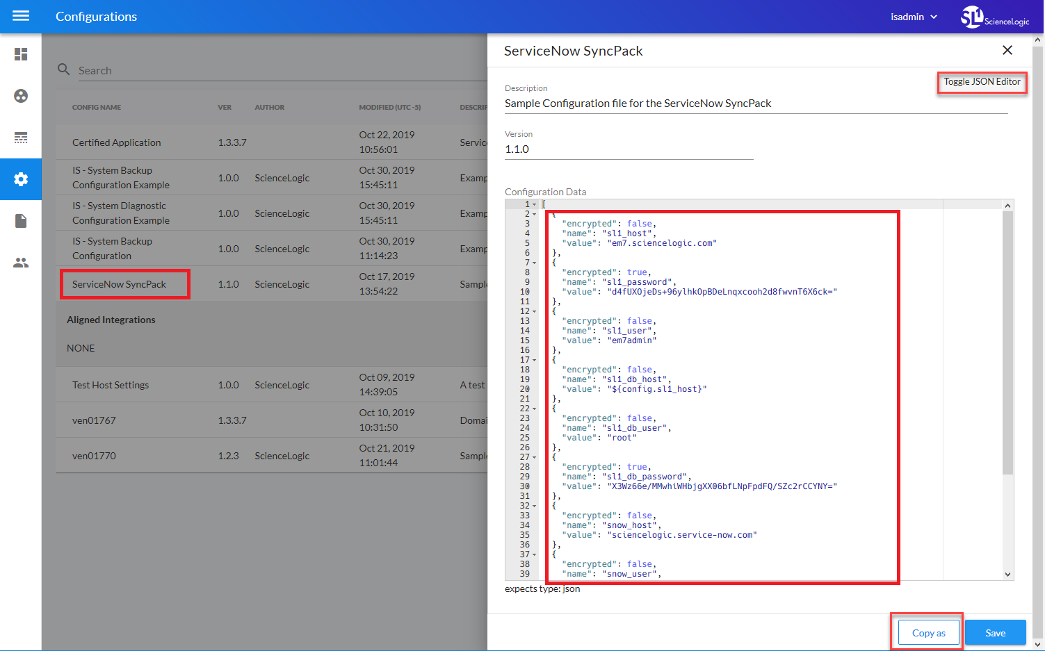

  1. Create a configuration object in the PowerFlow user interface

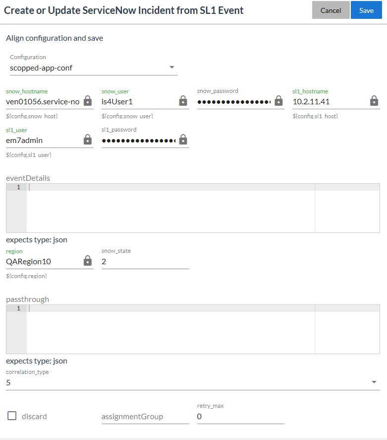

  2. Align the new configuration file with the following PowerFlow applications:
  • "Create or Update ServiceNow Case from Skylar One Event"
  • "Resolve ServiceNow Case from Skylar One Event"
  • "Sync Case or Incident State from ServiceNow to Skylar One Event"

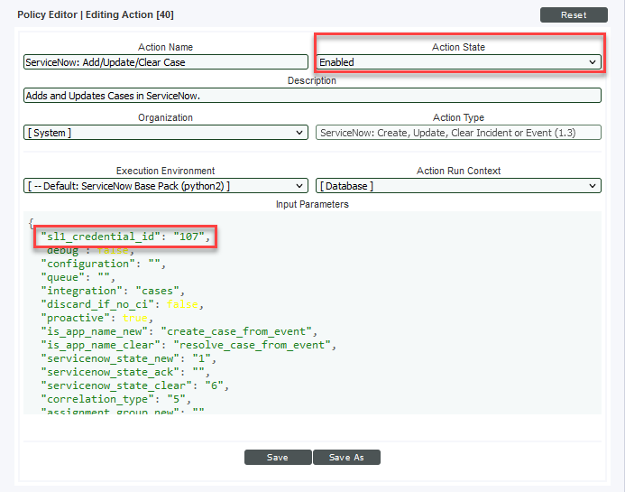

To enable and customize the Case run book action policy:
  1. In Skylar One, go to the Actions page (Registry > Run Book > Actions).
  2. Locate the ServiceNow: Add/Update/Clear Case policy and click its wrench icon (). The Action Policy Editor page appears:
  1. For the Action State filed select Enabled.
  2. For the sl1_credential_id field in the Input Parameters pane, specify the credential ID from the ID column on the Credential Management page (System > Manage > Credentials). For example: "sl1_credential_id": "101"
  3. Edit the snippet code as necessary, using the information in the Customizing the Snippet Code in the Input Parameters Pane section, below.
  4. When you are finished, click Save.

You can customize the following values in the "ServiceNow: Add/Update/Clear Case" run book action snippet code:
  • sl1_credential_id. Specifies the ID of the credential object. You can find this value in the ID column of the Credentials page (Manage > Credentials of Skylar One. For example: "sl1_credential_id": "41"
  • debug. A true/false value that determines if the action is logged in Skylar One and if the application is run in Debug Mode on PowerFlow. Troubleshooting logs are written to /data/tmp/servicenow_rba.log.
  • configuration. Specifies the ID of the configuration object used on PowerFlow. The configuration ID is all lower-case, with spaces in the configuration object "friendly" name replaced by underscores. For example: "configuration": "docs_config"

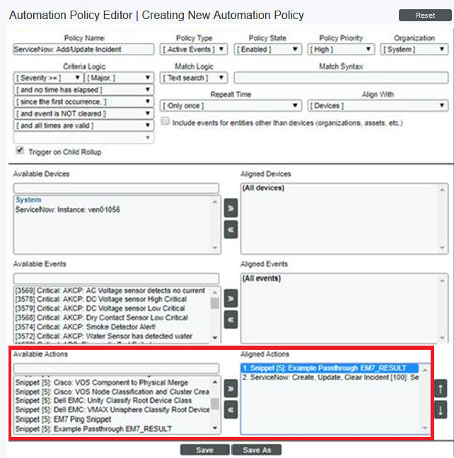

  2. Go to the Automation Policy Manager page (Registry > Run Book > Automation) and open the "ServiceNow: Add/Update Incident" run book automation Policy.
  1. In the Available Actions section, add the new run book action before the "ServiceNow: Create, Update, Clear Incident" run book action:
    The output of this new run book action will be consumed by the "ServiceNow: Create, Update, Clear Incident" run book action, ensuring that the EM7_RESULT dictionary is passed through to ServiceNow. The "ServiceNow: Create, Update, Clear Incident" run book action automatically populates the passthrough values with any values from EM7_LAST_RESULT. The passthrough overwrites any other previously defined fields, such as assignment group.
  1. You can add additional run book actions to the run book automation Policy for any additional workflows that you might want to run. The Automation Policy execute these Actions in a sequential, top-down order. However, the "ServiceNow: Create, Update, Clear Incident" run book action only consumes the EM7_RESULT dictionary from the run book action directly above it.

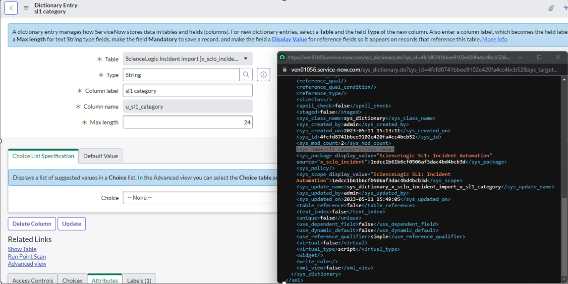

For the Dictionary Entry of the ServiceNow field on the import table, you can reference the XML of the record. You will need to copy the <sys_name> value so you can use that as the key for the passthrough.
In this example, you want to bring in an additional field called sl1 category.
  1. Create the new sl1 category field on the import table in ServiceNow. You can right-click on the header of the form to view the XML:
  2. Look for the <sys_name> value.
  3. Copy that value directly out and use that in your EM7_RESULT for the passthrough value (in the Snippet Code pane):
    EM7_RESULT = {'sl1 Category': 'test'}

To create a configuration object based on the "ServiceNow SyncPack" configuration object:
  1. In the PowerFlow user interface, go to the Configurations page ().
  2. Click the Actions button () for the "ServiceNow SyncPack" configuration object and select Edit. The Configuration pane appears:
    Click Toggle JSON Editor to show the JSON code. Click the button again to see the fields.
  1. Click Copy as. The Create Configuration pane appears.
    This step is required. Do not use the original configuration object to run PowerFlow applications.
  • Friendly Name. Name of the configuration object that will display on the Configurations page.
  1. In the Configuration Data field, include the required block of code to ensure that the applications aligned to this configuration object do not fail:

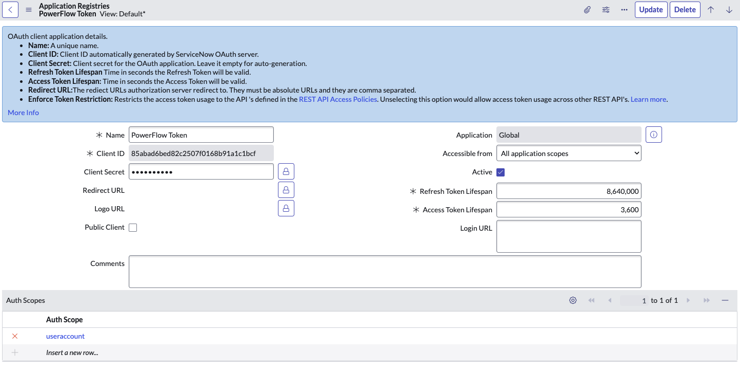

    Creating an OAuth2 Credential Record in ServiceNow
    In order to use OAuth2 for authentication with ServiceNow, you must create an OAuth2 credential record in ServiceNow. To configure the ServiceNow credential that will be used by the Connector Instance:
    1. Navigate to System OAuth > Application Registry. The Application Registries page appears.
    2. Click New.
    3. Select Create an OAuth API endpoint for external clients. A new record appears.
    4. Complete the following fields on the new record:
    • Name. Type a unique name for the credential. Required.
    • Client ID. The Client ID is automatically generated by the ServiceNow OAuth server.
    • Client Secret. Leave this empty. ServiceNow will auto-generate this when the record is saved.
    • Refresh Token Lifespan. Enter the length of time in seconds the Refresh Token will be valid.
    • Access Token Lifespan. Type the length of time in seconds that the Access Token will be valid. ScienceLogic recommends setting this to 3,600 seconds to avoid known issues for longer ServiceNow REST interactions.
    In a scenario where the Access Token Lifespan value is shorter than the duration of a Skylar Automation step that makes multiple REST interactions with ServiceNow, the access token will expire and need to be refreshed. As a result, retries were added to several Skylar Automation steps where this issue may occur. This issue will hopefully be addressed in future versions of the Base Steps SyncPack.
    1. Under the Auth Scope section at the bottom of the page, double click Insert a new row.
    2. In the search box that appears, click the magnifying glass icon, select the useraccount record, and click the checkmark icon to save.
    3. Click Submit to save the new record.

    1. On the Applications page of the PowerFlow user interface, open one of the PowerFlow applications listed above and click Configure. The Configurations pane for that application appears:
    1. From the Configurations drop-down, select the configuration object you want to use.
      The values for eventDetails and the other parameters that appear in the Configuration pane with a padlock icon () are populated either by the configuration object you aligned with the application or by the Run Book Action. Do not modify these values. If you encounter an error, make sure your Run Book Action is configured properly.
    2. If needed, edit the retry values:
    • retry_max. The maximum number of times PowerFlow will retry to execute the step before it stops retrying and logs a step failure. For example, if retry_max is 3, PowerFlow will retry after 1 second, then 2 seconds, then 4 seconds, and stop if the last retry fails. The default is 0.
    • retry_jitter. Instead of using a defined interval between retries, the PowerFlow system will retry the step execution at random intervals. The default is unselected.
    • retry_backoff. Instead of using a defined interval between retries, PowerFlow will incrementally increase the interval between retries. The default is unselected.
    • retry_backoff_max.The maximum time interval for the retry_backoff option, in seconds. For example, This means, if you have retry_max set to 15, the delays will be 1, 2, 4, 8, 16, 32, 64, 120, 240, 480, 600, 600, 600, 600, and 600. The default is 600.
    • read_timeout. Specify the maximum amount of time in seconds that the application should wait for a response before timing out. The default is 20.
      Do not update any of the other parameters on the Configuration pane for any of these PowerFlow applications related to Case Sync. These values are updated by the "ServiceNow: Add/Update/Clear Case" Run Book Action.
    1. Click Save to align that configuration with the application.
    2. Repeat this process for the other PowerFlow applications. The "Cache Skylar One Users" application is in the "System Utils" SyncPack.
