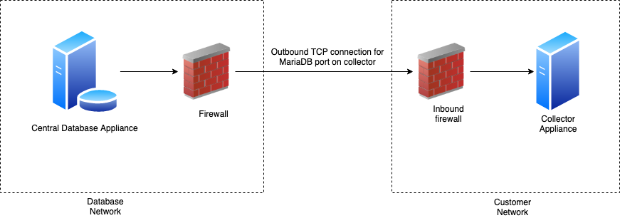

In the Traditional method, the Skylar One services on the Database Server initiate a new connection to the MariaDB port on the collector to read and write data. The connection request traverses the network, including the Internet if necessary, eventually reaching the collector. For this approach to work, the collector administrator must allow ingress communication from the Database Server on TCP port 7707, which is the MariaDB port on the collector. The communication is encrypted using SSL whenever possible.
A diagram showing the traditional method of communication.
The benefit of the traditional method is that communication to the Database Server is extremely limited, so the Database Server remains as secure as possible.

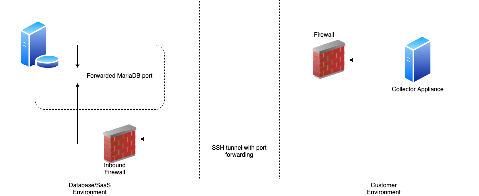

In the PhoneHome method, the collectors initiate an outbound connection to the Database Server over SSH. The connection requests originate from edge to core via TCP, using port 7705 by default.
After authenticating, the client forwards the local MariaDB port onto the Database Server using a loopback remote IP address. A corresponding Skylar One appliance is added using the loopback IP. When the Skylar One services on the database try to make a connection to the collector's MariaDB, they connect locally to the loopback IP address, in contrast to reaching out to the collector's IP or DNS name. The communication is encrypted.
A diagram showing the PhoneHome communication method.
The benefits of this method are that no ingress firewall rules need to be added, as the collector initiates an outbound connection, and no new TCP ports are opened on the network that contains the Data Collectors.
While you do not need to add any ingress firewall rules, a best practice is to add an egress firewall rule that allows SSH traffic from the collector on the server's port to either all available destination addresses on the DB or to the specific address on the DB that you know the collector will be able to reach. Custom firewall rules must use the rich rules syntax and added to /etc/siteconfig/firewalld-rich-rules.siteconfig.
The PhoneHome configuration uses public key/private key authentication to maintain the security of the Database Server. You can use RSA256 and RSA512 algorithms for key authentication when configuring PhoneHome communication.
Each Data Collector is aligned with an SSH account on the Database Server and uses SSH to communicate with the Database Server. Each SSH account on the Database Server is highly restricted, has no login access, and cannot access a shell or execute commands on the Database Server.
