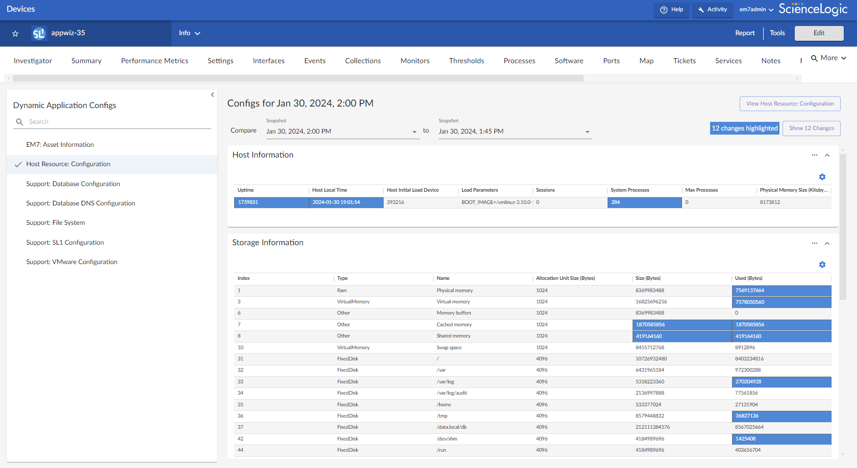

Viewing Device Snapshot Data
You can view all changes between two specific snapshot reference points of a Dynamic Application on the Configs tab of the Device Investigator page.
To view all changes between two snapshots of a Dynamic Application:
  1. Go to the Devices page.
  2. Locate the device for which you want to compare Dynamic Application snapshot data, and click its name under the Device Name column. The Device Investigator page appears.
  3. Click the Configs tab.
  4. Select a Dynamic Application from the collapsible Dynamic Application Configs pane on the left side of this page.
  5. NOTE: You can click the View <Dynamic Application Name> button to open the Dynamic Application Properties Editor modal for that Dynamic Application.
  6. Select two snapshots to compare in the Snapshot drop-down menu. By default, this page will compare the current system and the last snapshot. All changes are highlighted.
  7. Click the [Show X Changes] button, where the variable "X" is the number of changes between the two snapshots, located in the upper right side of the page. The Host Resource: Configuration modal appears.
  8. In this modal, you can view a more detailed breakdown of how these values changed between the two snapshots.

Selecting Data to View
If one or more journal Dynamic Applications are associated with the device, the Journals tab of the Device Investigator (or the Journal View page in the classic Skylar One user interface) will display that list of Dynamic Applications on the left side of the page.
When you select a Dynamic Application on the left side of the page, the right pane displays data collected from the device by the selected Dynamic Application.
The Journals tab of the Device Investigator (or the Journal View page in the classic Skylar One user interface) arranges collected journal entries in tabular format.
  • The table contains a row for each journal entry.
  • The table contains a column for each presentation object, plus the State and Collected On columns. Presentation objects define the text to display in each row in the column, including which collection values will be displayed. Presentation objects are defined in the Presentation Objects page for the Dynamic Application.
The Journals tab of the Device Investigator (or the Journal View page in the classic Skylar One user interface) displays the following about each journal entry:
To sort by descending order, click the column heading again. To sort a column that contains presentation objects, sorting must be enabled in the Presentation Objects page (System > Manage > Dynamic Applications > Create/Edit). Date and time column sorts by descending order on the first click; to sort by ascending order, click the column heading again.
  • Presentation Objects. One or more columns in the table of journal entries will be presentation objects defined in the Dynamic Application. The values in this column can be based on one or more collection objects, and can be a text string, a number, or a time and date value.
  • State. Specifies the current state of the journal entry. Journal entries can have one of the following states:
  • Open
  • Closed
  • Abandoned
  • Error
  • Reopened
  • Collected On. Specifies the last time the journal entry was updated.
