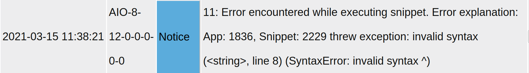

By modifying the User Editable area, if there are some mistakes in the source code you may see a Syntax Error. To solve the error you should review the syntax of your custom code. A good starting point is comparing your custom Snippet to what is provided in the Default Snippet.
../_images/SyntaxtError.png

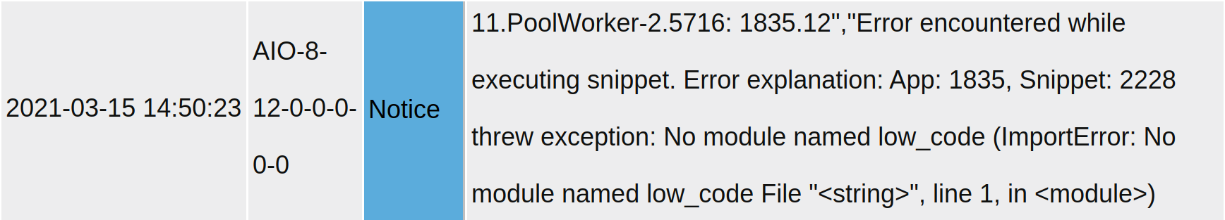

Another common error can be the Import Error. If this is the case, you should review and fix your execution environment.
../_images/ImportError.png

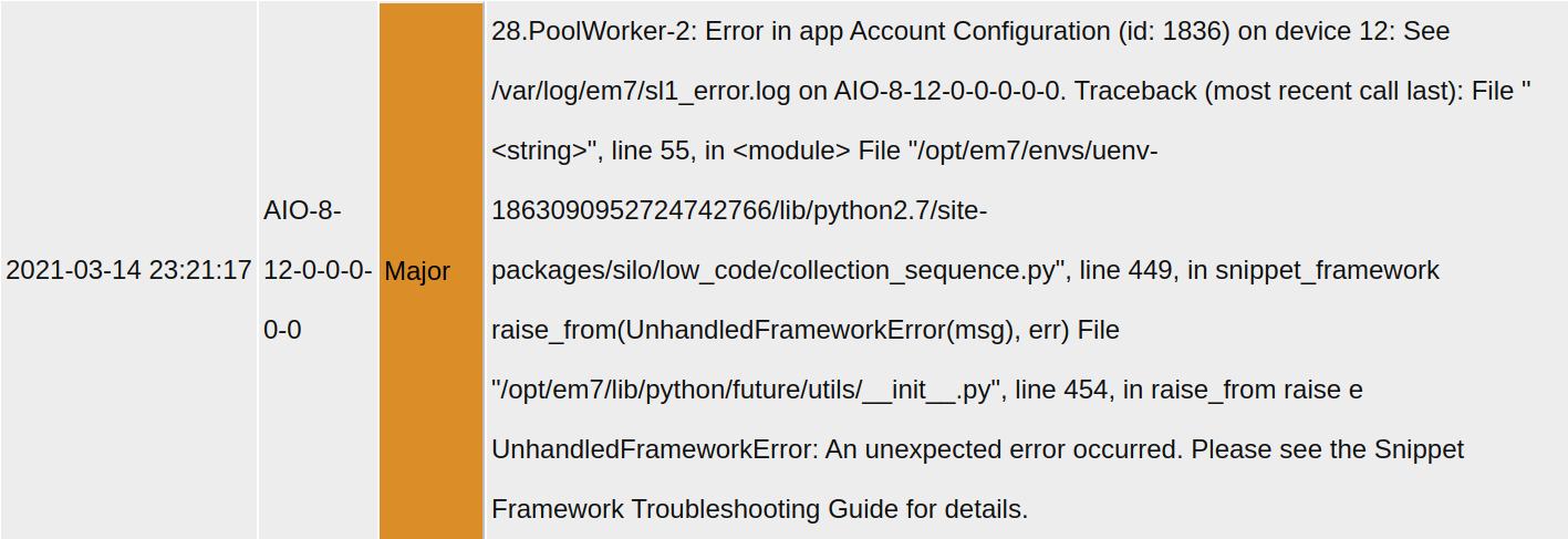

Unhandled Framework Error
When an unhandled error occurs in the Snippet Framework, collect the following logs from the collector, and contact ScienceLogic Support:
  • /var/log/em7/snippet_framework.log
../_images/UnhandledFrameworkExceptions.png
