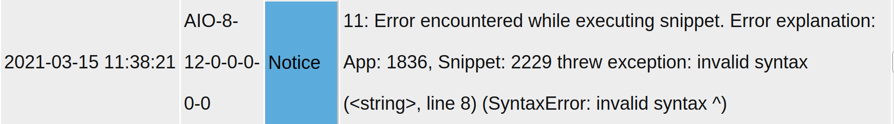

By modifying the User Editable area, if there are some mistakes in the
source code you may see a Syntax Error. To solve the error you should
review the syntax of your custom code. A good starting point is comparing
your custom Snippet to what is provided in the Default Snippet.

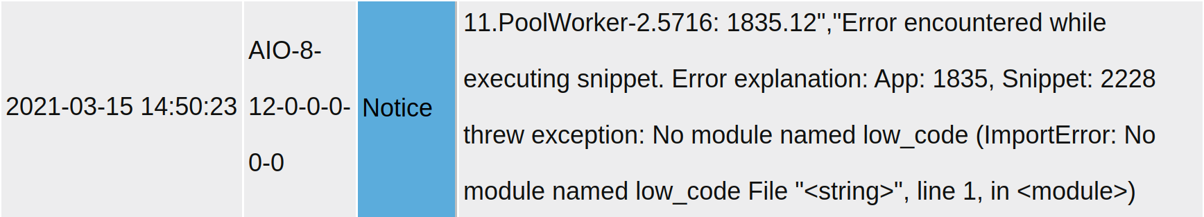

Another common error can be the Import Error. If this is the case, you should review and fix your execution environment.

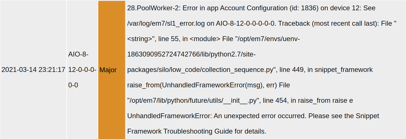

Unhandled Framework Error
When an unhandled error occurs in the Snippet Framework, collect the following logs from the collector, and contact ScienceLogic Support:
- /var/log/em7/snippet_framework.log
