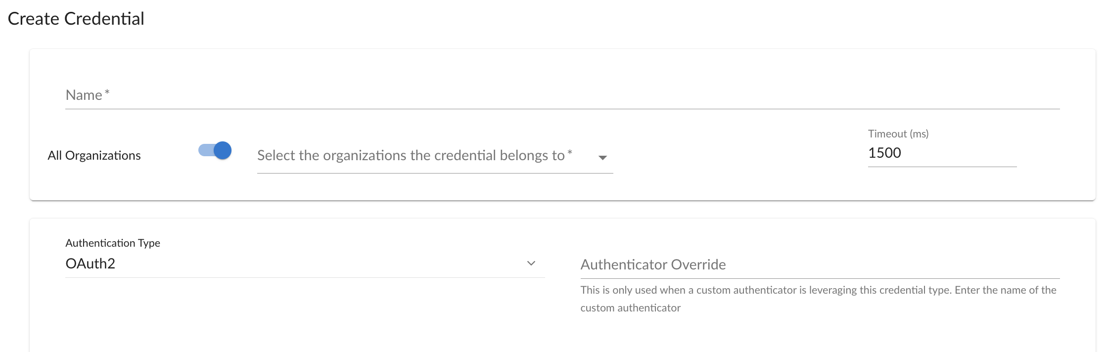

Authenticator Override
Before we dive into developing new or augmenting an existing authenticator, we need to understand how to reuse the Low-code tools: rest v104 credential type in order to point to a different authenticator while stilling being able to re-use existing credential fields.
Below is an image of the Low-code tools: rest v104 credential type. On the
bottom right of the image, is a field called Authenticator Override.
The contents of this field must match the output of the get_name()
function. Below is a shortened example of an authenticator. Its name is
AuthCustom. If we wanted to use this new authenticator then we would
need to update the credential field, Authenticator Override, to be
AuthCustom.
@add_auth
class AuthCustom(Authenticator):
    # There are more methods not shown
    @staticmethod
    def get_name():
        return "AuthCustom"
In the following examples, after we create our authenticator we will need to
update the Authenticator Override field to match our get_name() value.
