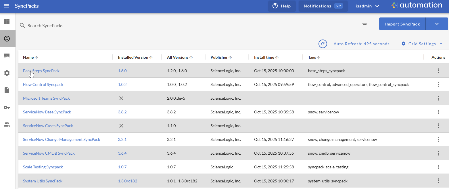

Viewing the List of SyncPacks
The SyncPacks page () provides a list of the SyncPacks on your Skylar Automation system. From this page you can search for and view SyncPacks, and you can also install and uninstall SyncPacks.
You can export a CSV list of the installed SyncPacks by clicking Grid Settings and then selecting Export to CSV.
Searching for a SyncPack
You can search for a specific SyncPack by typing the name of that SyncPack in the Search field at the top of the SyncPacks page. The user interface filters the list as you type. You can also filter the list by typing in the text box above a column header, and sort by clicking most column headers.
If you have more than one version of a SyncPack the active version of the SyncPack is highlighted in green in the Versions column.
Click the Filter icon () at the top right of the SyncPacks page and select Toggle Inactive SyncPacks to show all SyncPacks on the Skylar Automation system.
Viewing a Detail Page for a SyncPack
Click the name of a SyncPack from the list to view the detail page for the SyncPack.
At the top of this page you can view additional metadata, including the active version, the minimum Skylar Automation platform version, and other details.
In the Package Contents section, you can view more details about the steps, applications, and configuration objects include with that SyncPack:
  • The Applications tab includes a link to the detail page for each application, along with a list of steps in the application (with the option of clicking the step name to view the code for that step), and a thumbnail image of the workflow for the application.
  • The Steps tab includes a link to the Step Code dialog for each step, along with a list of any applications that are using that step. You can also click the name of the application from the list to go to the detail page for that application.
  • The Configurations tab includes a link to the detail page for each configuration object, along with a list of any Skylar Automation applications that are aligned with that configuration object (with the option of clicking the application name to view the detail page for that application).
