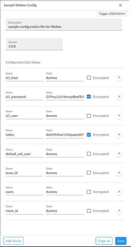

For this SyncPack, you can make a copy of the " Config" configuration object, which is the sample configuration file that was installed with the Webex SyncPack.
The "Sample Webex Config" configuration object contains all of the required variables. Simply update the variables from that object to match your SL1 and Webex settings.
To create a configuration object based on the "Sample Webex Config" configuration object:
  1. In the PowerFlow user interface, go to the Configurations page ().
  2. Click the Actions button () for the "Sample Webex Config" configuration object and select Edit. The Configuration pane appears:
An image of the configuration object page.
  1. Click Copy as. The Create Configuration pane appears.
    • Friendly Name. Name of the configuration object that will display on the Configurations page.
  1. In the Configuration Data field, update the default variable definitions to match your PowerFlow configuration:
    • sl1_host. The hostname or IP address of the SL1 system the alerts will synchronize to.
    • sl1_user. The username for your SL1 system.
    • sl1_password. The password for your SL1 system.
    • token. Webex bot token.
    • default_ack_user. The default user to acknowledge events and alerts.
    • team_id. ID of the team to create the channel for.
    • users. Comma-separted list of Webex user emails to invite to the created channel.
    • room_id. ID of the room to post messages in.

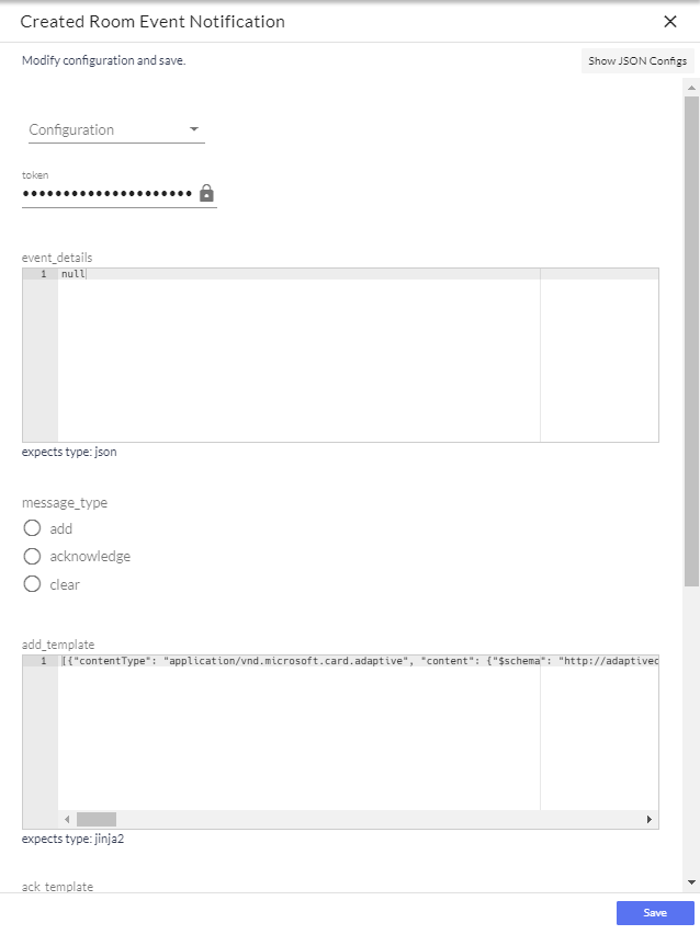

  1. On the Applications page of the PowerFlow user interface, open one of the PowerFlow applications listed above and click Configure (). The Configurations pane for that application appears:
    An image of the Configure page.
  1. From the Configurations drop-down, select the configuration object you want to use.
    The values for proxy_host and the other parameters that appear in the Configuration pane with a padlock icon () are populated either by the configuration object you aligned with the application or by the Run Book Action. Do not modify these values. If you encounter an error, make sure your Run Book Action is configured properly.
  1. Click Save to align that configuration with the application.
  2. Wait until you see the "App & Config modifications saved" pop-up message before proceeding.
  3. Repeat this process for the other PowerFlow applications.
