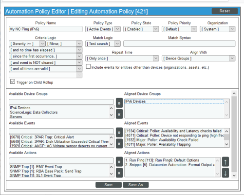

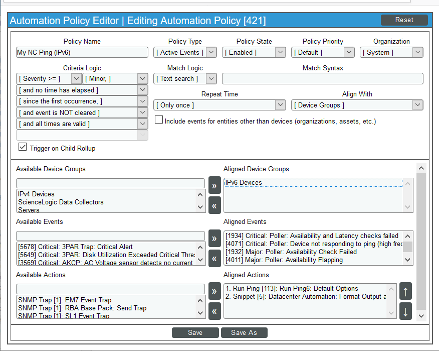

The following is an example of an automation policy that uses the automation actions in the Network Connectivity Automations PowerPack:
The policy uses the following settings:
  • Policy Name. The policy is named "My NC Ping (IPv6)".
  • Policy Type. The policy runs when an event is in an active state. Active Events is selected in this field.
  • Policy State. Enabled is selected in this field.
  • Organization. The policy executes for all organizations, so System is selected in this field.
  • Criteria Logic. The policy is configured to execute immediately when an event matches these criteria: "Severity >= Minor, and no time has elapsed since the first occurrence, and event is NOT cleared, and all times are valid".
  • Aligned Devices. The policy is configured to trigger for all devices in the "IPv6 Devices" dynamic device group.
  • Aligned Events. The policy is configured to trigger only when the following events are triggered:
    • Critical: Poller: Availability and Latency checks failed
    • Critical: Poller: Device not responding to ping (high frequency)
    • Major: Poller: Availability Check Failed
    • Major: Poller: Availability Flapping
    • Major: Poller: TCP/UDP port not responding (SMTP)
    • Major: Transactions: Round trip mail did not arrive within threshold
    • Minor: Poller: Network Latency Exceeded Threshold
    • Minor: Poller: TCP connections time above threshold
  • Aligned Actions. The automation includes the following actions. The formatting action allows you to view the output of ping in the Automation Log, accessed through the SL1 Event Console:
    • Run Ping6: Default options
    • Datacenter Automation: Format Command Output as HTML
