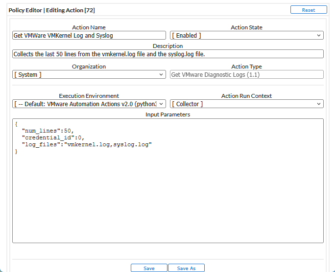

The following run book actions that use the "Get VMware Diagnostic Logs" action type are included in the "VMware Automation" PowerPack. Compare the commands run with the example in the image above. For more information about input parameter fields, see the table in Creating a VMware Run Book Action.

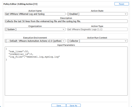

You can create a new run book action that collects certain logs using the "Get VMware Diagnostic Logs" custom action type. You can also use one of the existing run book actions in the PowerPack as a template by using the Save As option.
To create a custom run book action using the "Get VMware Diagnostic Logs" action type:
  • Navigate to the Action Policy Manager page (Registry > Run Book > Actions).
  • In the Action Policy Manager page, click the Create button. The Action Policy Editor modal appears:
  • In the Action Policy Editor page, supply a value in each field.
  • Action Type. Type of action that will be executed. Select the "Get VMware Diagnostic Logs" action type.
  • Input Parameters. A JSON structure that specifies each input parameter. Each parameter definition includes its name, data type, and whether the input is optional or required for this Custom Action Type. In the example shown above, the run book action policy request the last 50 lines of the logs from vCenter. Input parameters must be defined as a JSON structure, even if only one parameter is defined.

  • Click Save, or if you are modifying an existing action policy, click Save As. Supply a new value in the Action Name field, and save the current action policy, including any edits, as a new policy.
