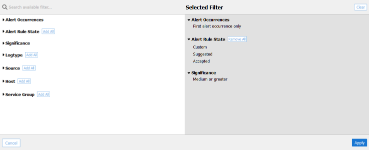

In addition, you can click the Filtering button () to select filters that will control which RCA reports display on the Alerts page. The Selected Filter dialog appears:
You can filter by log types (which typically match container names), service groups, hosts, tags, and more. Any RCA reports that match these attributes will be shown in the filtered view.
You can click the Views icon () to change the view that is currently displayed on the Alerts page. A view is a predefined set of filters for the user interface. You can also create your own view based on the filters you use regularly. For example, if you set up your filters on the Selected Filter dialog to only see the most recent occurrence in a specific service group, for the past seven days, then after you set those filters, you can click Add view on the Views menu to create a view for those filters. Later you can select that new view from the Views menu to get your customized set of filters.
Most of the filters on the Selected Filter dialog are self-explanatory. However, you should pay attention to the following filters, especially if you are not seeing the reports you want to see on the Alerts page:
  • Alert Occurrences. By default, only the first occurrence of a suggestion will be shown in the list, so that if the same type of alert occurs more than once, you will only see its first instance. You can change this if you wish to see all alert occurrences, the most recent alert occurrences, or other options.
    If you are not seeing as many suggestions as you would like, set this filter to All alert occurrences.
  • Alert Rule State. You can filter by some or all custom alerts, suggestions, accepted alerts, or rejected alerts.
  • Significance. The Skylar AI assigns a value of Low, Medium, or High to each suggestion, based on how likely that suggestion is related to a problem. By default, only suggestions with a significance of Medium and High are shown on the Alerts page.
    If you are not seeing as many suggestions as you would like, set this filter to Low or greater.
  • AI Assessment. Since not all suggestions that the Skylar AI generates will relate to problems that actually impact users, the Skylar AI attempts to reason over the data and assess whether a problem actually requires attention. This value is displayed as the AI Assessment. You can filter by Needs Your Attention and No Attention Needed

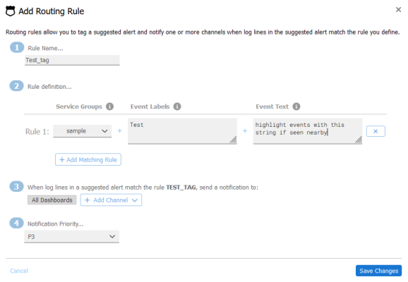

Use Routing Rules to Classify and Route Alerts
An even more powerful way to manage and route alerts is to set up routing rules on the Alert Rules & Settings page (Settings () > Alert Rules & Settings), on the ML Routing Rules tab.
This allows you to set up rules regarding service group, event labels (such as the Kubernetes app or pod name), as well as string matches in the actual log event. Each routing rule lets you automatically triage alerts and RCA reports, and send them to the appropriate destination.
For example, you might want to create a "Networking" tag for alerts that involves logs from Kubernetes pods that affect networking services, or contain key words related to network issues, and send them to an email alias or Slack channel for the networking team:
Image of the Update Tag window
For more information about creating the rules for the Event Labels and Event Text fields, see Defining Rules.
