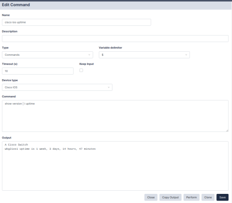

Select New Action from the drop-down menu, then enter the commands in the text area. Device Control Actions can also be defined from the Device Control page (Devices > Device Control), by clicking New Action.
If required, you can Save these commands as an Action for later execution, or for use in Compliance Remediation.
Stored Actions can also be scheduled. For more information, see Scheduled Actions.
Click Perform to execute the commands. Restorepoint will display the output of the commands for each of the selected devices. Device Control outputs are stored in the Output tab of the Device Control page.
Image of the Restorepoint Edit Command page
