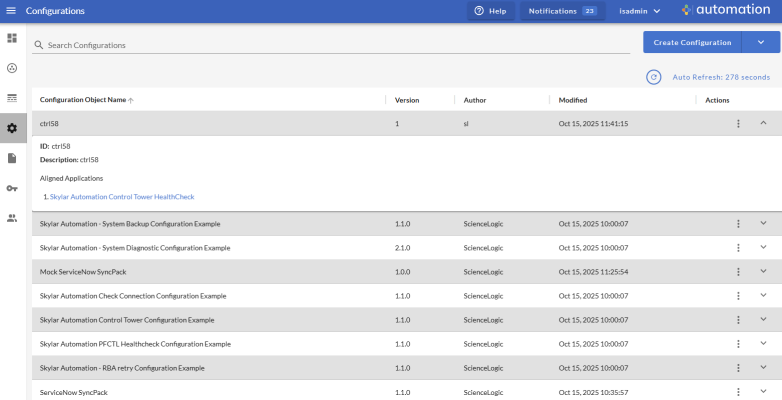

Viewing the List of Configuration Objects
The Configurations page () displays a list of available configuration objects. From this page you can create and edit configuration objects:
You can search for a specific configuration object by typing the name of that configuration in the Search field at the top of the Configurations page. The user interface filters the list as you type. You can also sort by clicking the Configuration Object Name column header.
The Configurations page displays the following information about each configuration object:
  • Config Name. The name of the configuration object.
  • Ver. The version number of the configuration object.
  • Author. The user or organization that created the configuration object.
  • Modified. The date and time that the configuration object was last edited.
  • Actions. Contains the following buttons:
  • Edit. Opens a pane where you can edit the contents of the configuration object.
  • Download. Lets you download the JSON file for the configuration object. If you have multiple Skylar Automation systems, you can download a configuration object from one system and then use the Import Configuration option (under the Create Configuration button) to upload that object to the second Skylar Automation system.
  • Delete. Removed the configuration object from the Skylar Automation system. Any Skylar Automation applications that were aligned with that configuration object are no longer aligned with that object.
Click the down arrow icon () for a configuration object to view a section that lists the applications that are currently aligned with that configuration object. Click the up arrow icon () to close the section.

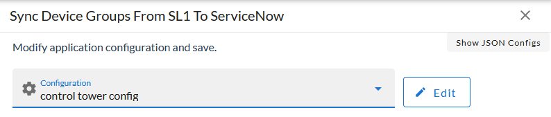

Edit Configuration Button
If you have a configuration object already selected on the Configuration pane for a Skylar Automation application, you can edit it by clicking the Edit button:
The Configuration pane for that configuration object displays to the left of the application Configuration pane. Add or edit the values on that new pane and click the Save button.

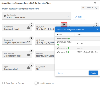

Available Configuration Values Pop-up
For any of the application variables with a gear icon () in the right-hand corner, you can click that icon to open the Available Configuration Values pop-up:
This pop-up contains a list of all of the available configuration variable values in the configuration object that you selected in the Configurations field.
In the Available Configuration Values pop-up, you can:
  • Select a value from the list to replace the value in the existing application variable.
    If an application variable is using a value stored in the configuration object, the corresponding code for that variable displays underneath the box for that value, such as ${config.pf_username}.
  • Click the Set to Default button to set a changed application variable value back to its original value.
  • Click the Clear button to clear the selected value.

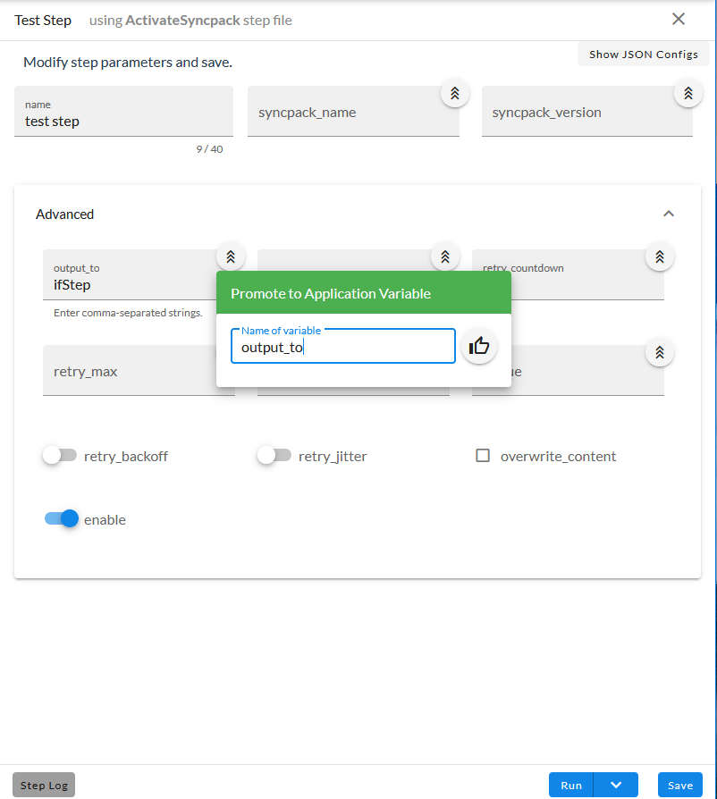

Promote Step Variable Option
You can use the "Promote to Application Variable" icon () on the Configuration pane for a step variable to make that value available in a configuration object. This is also called "promoting" a step variable.
The step promotion option is only available for steps that are not part of a ScienceLogicSyncPack.
Previously you could add a step variable to a configuration object, but you would need to type the encoded variable name, such as ${appvar.snow_hostname}, to promote that step variable to an application variable.
To promote a step variable to a configuration variable:
  1. In the Skylar Automation user interface, open the application that you want to update and click the Open Editor button. The Steps Registry of the Skylar Automation builder appears.
  2. Select the step that has the variable you want to promote and drag it to the main pane or canvas. The Configuration pane for that step appears automatically:
  3. Click the "Promote to Application Variable" icon () for the step variable you want to promote. A Promote to Application Variable modal appears.
  4. Use the existing name of the variable, or type a new name, and then click the thumbs-up icon ().
  5. Click the Save button for the step, and then click the Save button for the application. This step variable is now available on the Configuration pane for applications.
