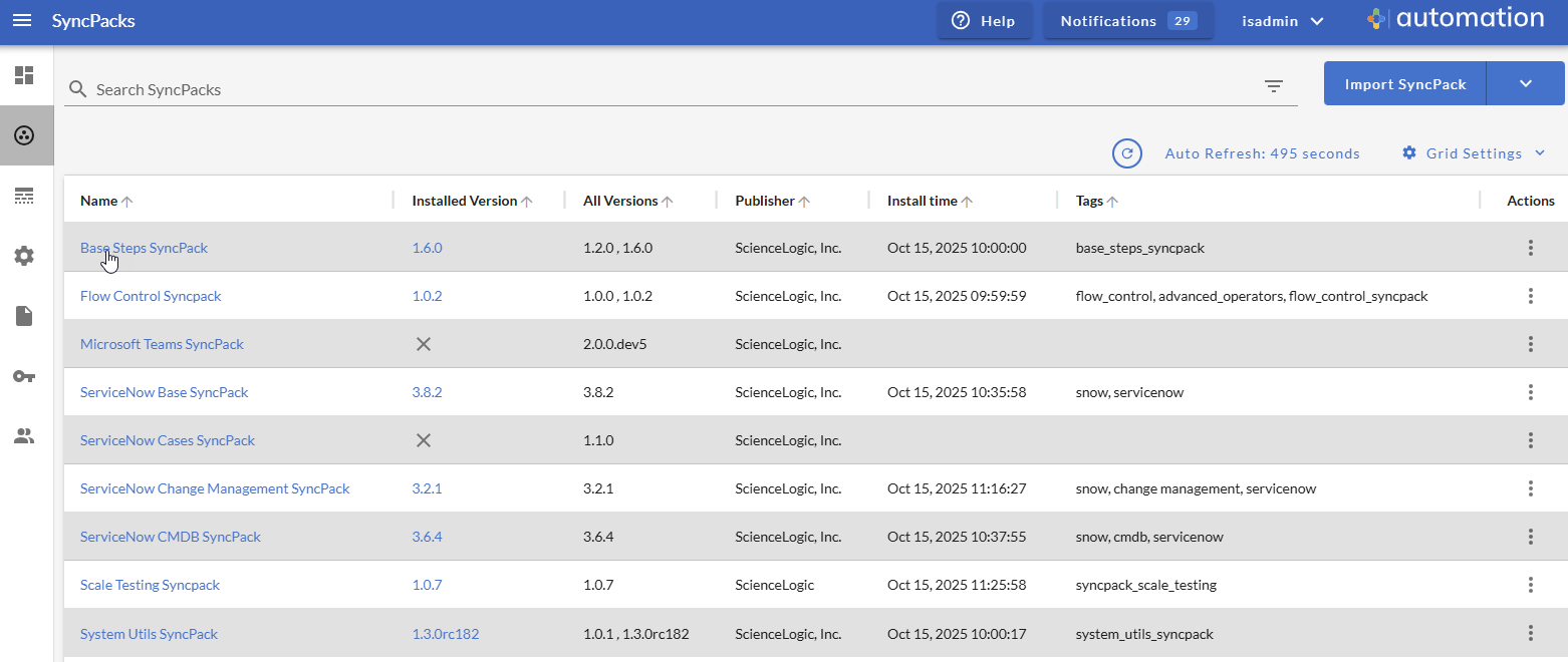

Viewing the List of SyncPacks
The SyncPacks page () provides a list of the SyncPacks on your Skylar Automation system. From this page you can search for and view SyncPacks, and you can also install and uninstall SyncPacks.
You can export a CSV list of the installed SyncPacks by clicking Download Version Report.
Searching for a SyncPack
You can search for a specific SyncPack by typing the name of that SyncPack in the Search field at the top of the SyncPacks page. The user interface filters the list as you type. You can also filter the list by typing in the text box above a column header, and sort by clicking most column headers.
If you have more than one version of a SyncPack the active version of the SyncPack is highlighted in green in the Versions column.
Click the Filter icon () at the top right of the SyncPacks page and select Toggle Inactive SyncPacks to show all SyncPacks on the Skylar Automation system.
