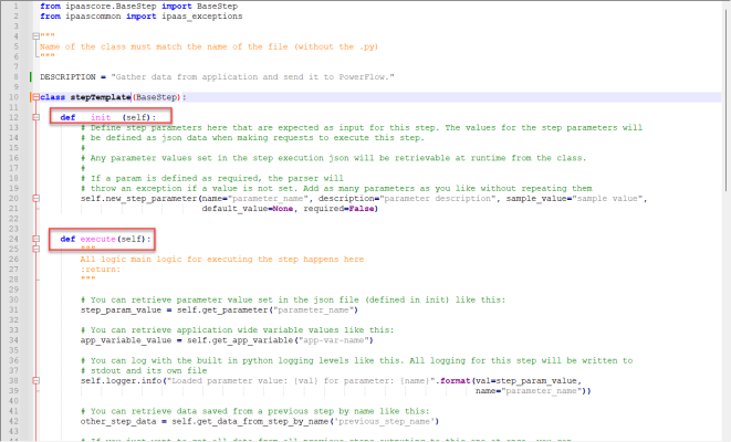

To execute successfully on Skylar Automation, your step must be a subclass of the ipaascore.BaseStep class. The ipaascore.BaseStep class is a Python class that is included with PowerFlow, and it contains multiple predefined functions that you can use when you are writing or editing a step.
Your new step must include the init method and the execute method. These methods are explained in the Required Methods section, below.
Subclass
The stepTemplate.py file is already configured to include the new step as a subclass of the ipaascore.BaseStep class. To update your step:
Use a source-code editor to open the new .py file for editing.
Notice that the file includes these lines of text:
from ipaascore.BaseStep import BaseStep
from ipaascommon import ipaas_exceptions
Do not remove or alter these lines of text.
Search for the following:
class stepTemplate(BaseStep):
Replace stepTemplate with the new name of the file (without the .py suffix).
Save and close the file.
Required Methods
To execute successfully on Skylar Automation, your step must contain at least these two methods:
- init method. This method lets you define initialization options and parameters for the step.
- execute method. This method includes the logic for the step and performs the action. After Skylar Automation evaluates all parameters and initialization settings and aligns the step with a worker process, Skylar Automation examines the execute method.
Without these methods, Skylar Automation will consider your step to be "incomplete" and will not execute the step.
The stepTemplate.py file includes these two methods and the syntax of some of the sub-methods you can use within the main methods:
