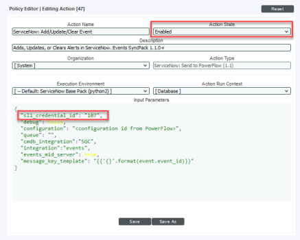

  1. Enable the "ServiceNow: Add/Update/Clear Event" run book action

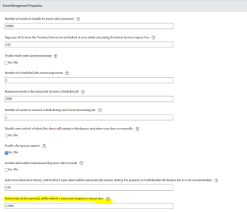

In ServiceNow, go to the Event Management Properties module under the Event Management application. On this page, you can access the Active interval (in seconds) within which a new event reopens a closed alert field (evt_mgmt.active_interval). In this field, you can set a time period in seconds within which an incoming event can either re-open a closed alert or create a new alert event with same message Key.
In the following image, this field has a value of 14400 seconds (4 hours):
You can configure these properties for each customer instance. You can have two different alerts with the same message Key. Consider the following scenarios:
  • When an event clear occurs to close the alert associated to it, and the next open event occurs within 4 hours (based on the setting in the image above), then this event would re-open the same alert.
  • When an event clear occurs to close the alert associated to it, and the next open event occurs after 4 hrs, then this event would not re-open the same alert. Instead, a new alert is created with the same message Key.

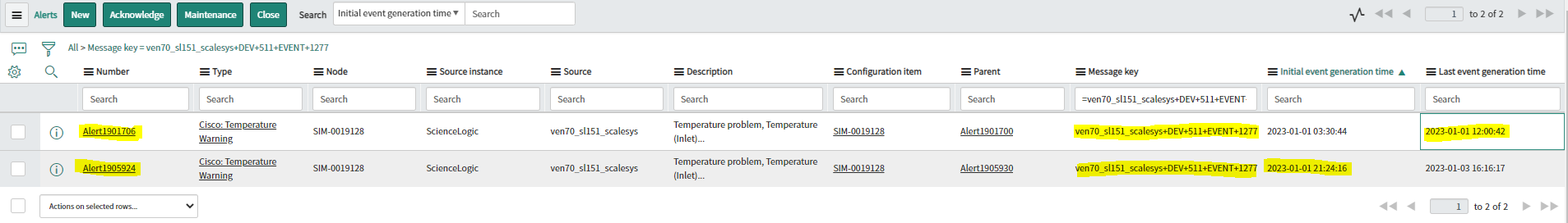

The following image shows an example of the second scenario:
In the above example, a clear event came in and closed the corresponding alert, Alert1901706 at 2023-01-01 12:00:42. The next open event that triggered with the same message Key was at 2023-01-01 21:24:16. The time difference was more than 4 hours, so as a result, this event created a different alert , Alert1905924 and did not re-open Alert1901706.

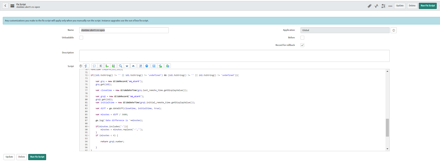

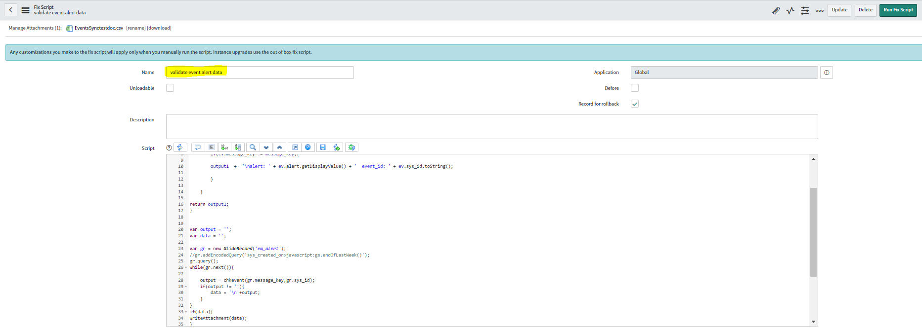

When you have large-scale data in event and alert tables in ServiceNow, it can be difficult to manually test the alignment of events and alerts, as well as alerts re-opening or creating a new alert, as mentioned in the scenarios, above.
To address this issue, ScienceLogic created Fix Scripts that you can use to validate the output and see if there are any misconfigured event/alert alignment or any mismatched alert re-openings.
To validate the event alert data, the following Fix Script checks to see if events that are aligned to alerts have the same message Key; if not, the script it pulls misconfigured alert numbers and Event sysIDs and creates a .CSV file with this data and attaches it to the same fix script. You can look at the .CSV file to check if there are any misconfigurations.
To validate alert re-openings, the following Fix Script checks for the date/time differences between alerts with same message Key. The Script pulls out any misconfigured alerts, creates a .CSV file with this data, and attaches it to the same Fix Script. You can look at the .CSV file to check if there are any misconfigurations for the alert re-opening/new alert scenario.

The "ServiceNow: Add/Update/Clear Event" run book action policy contains several default values in the snippet code for the policy that you can customize to use with the "ServiceNow Events" SyncPack.
You can edit these values in the Input Parameters pane of the Actions page for this policy.
Make sure you are using the most recent version of the run book action policy. If there are two policies with the same name, always use the policy with the higher number in the ID column of the Actions page.
To enable and customize the Event run book action policy:
  1. In Skylar One, go to the Actions page (Registry > Run Book > Actions).
  2. Locate the ServiceNow: Add/Update/Clear Event policy and click its wrench icon (). The Action Policy Editor page appears:
  1. For the Action State filed select Enabled.
  2. For the sl1_credential_id field in the Input Parameters pane, specify the credential ID form the ID column on the Credential Management page (System > Manage > Credentials). For example: "sl1_credential_id": "107"
  3. In the Input Parameters pane, edit the snippet code as necessary, using the information in the Customizing the Snippet Code in the Input Parameters Pane section, below.
  4. When you are finished, click Save.
