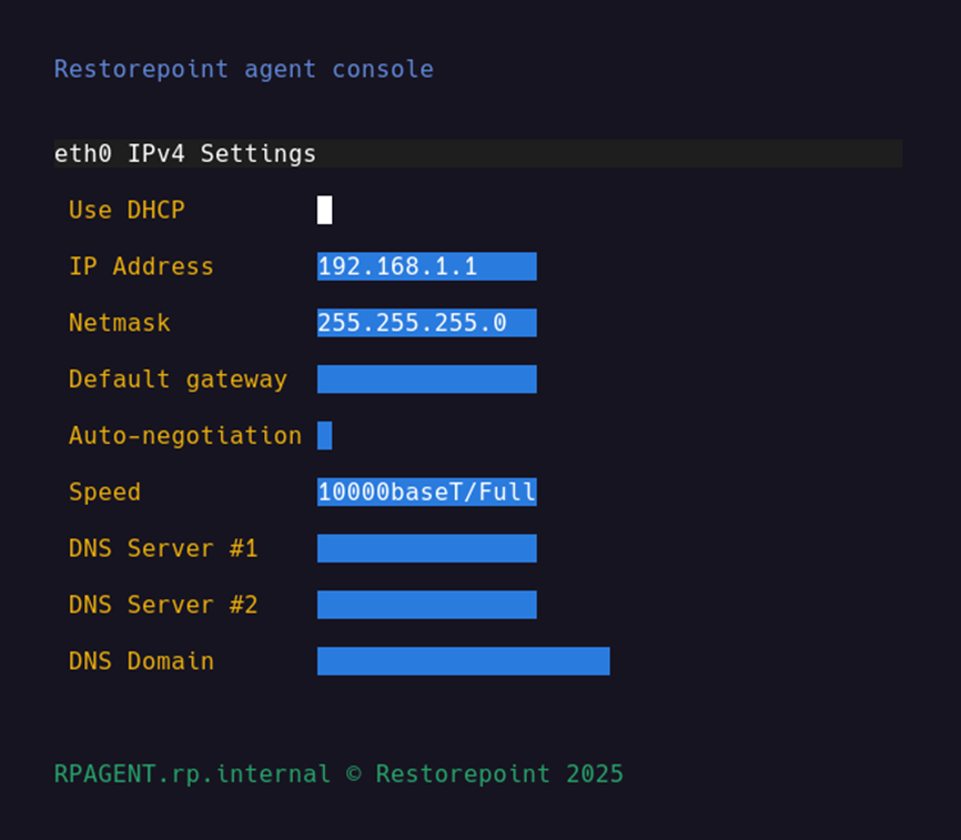

  4. Select IP Address Configuration at the console menu:
  5. Image of the Restorepoint Agent Console
  1. Enter the settings for IP Address, Netmask, Default gateway, and DNS Server and Domain settings as prompted.
  2. Enter Y to confirm the settings. If the settings are applied successfully, the console menu will be redisplayed.

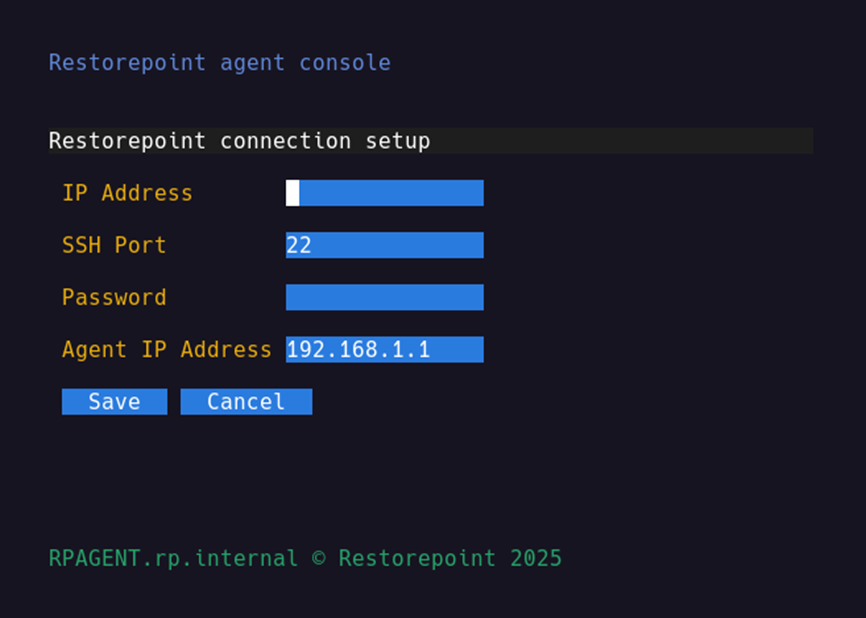

  3. Next, select Initial Restorepoint Master Setup:
  4. Image of the Restorepoint Agent Console
  1. Enter the IP Address of the master Skylar Compliance appliance, and a one-time password to verify the agent to the master (used only for initial pairing). Optionally, you can also specify which SSH Port and Agent IP Address you want to use for the connection.

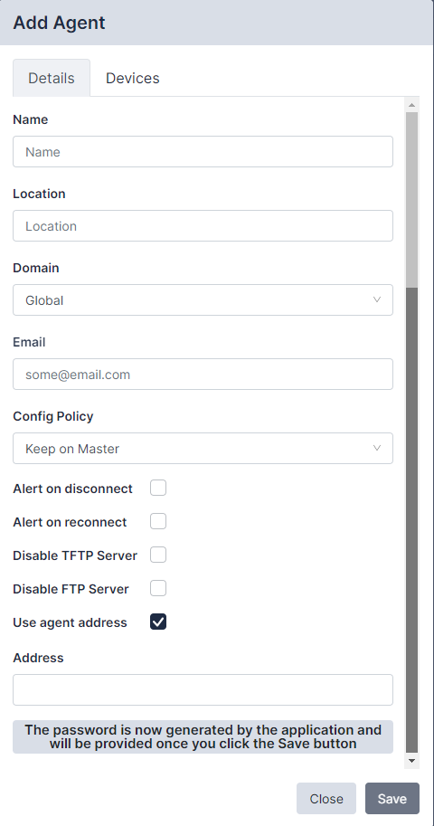

To add a configured agent to Skylar Compliance, navigate to the Agents page (Administration > Agents) and click Add Agent. The Add Agent dialog appears:
Image of the Restorepoint Add Agent page
Enter the following details:
  • Name. Type a name for the agent.
  • Location. Choose a new or existing location for the agent.
  • Domain. (Optional) The domain of the devices that this agent will manage. For more information, see Administration Domains.
  • Email. (Optional) The email for the user that is responsible for the upkeep of the agent.
  • Config Policy. Defines the backup storage policy. Select from one of the following options:
    • Keep on master. Backups are stored only on the master appliance.
    • Keep on agent. Backups are stored only on the agent appliance.
    • Keep on both. Backups are stored on both the master and the agent appliances.
  • Alert on disconnect. Select this checkbox to automatically email an alert if the agent goes offline. If the Email field is not filled in, the default notification address is used.
  • Alert on reconnect. Select this checkbox to automatically email an alert if the agent comes back online. If the Email field is not filled in, the default notification address is used.
  • Disable TFTP Server. Select this checkbox to disable TFTP servers.
  • Disable FTP Server. Select this checkbox to disable FTP servers.
  • Secondary To. Type the ID of an agent this agent is secondary to in a HA setup.
  • Secondary Master IP Address. Type the IP address of the secondary master IP in an HA setup.
  • Use Agent Address. Select this checkbox to enter the IP Address into the Address field.
  • Address. The specified address must be the address the agent uses to connect to the master. The address option for agents will not work if multiple agents use the same NAT address.
Skylar Compliance will generate an eight-character password upon registering a new agent.

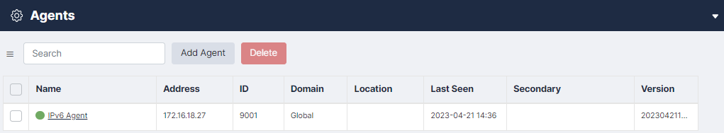

After the agent is added, Skylar Compliance will display the agent list. The address and port will be automatically filled in once the agent has connected successfully for the first time. Note that only one agent can be set up at a time.

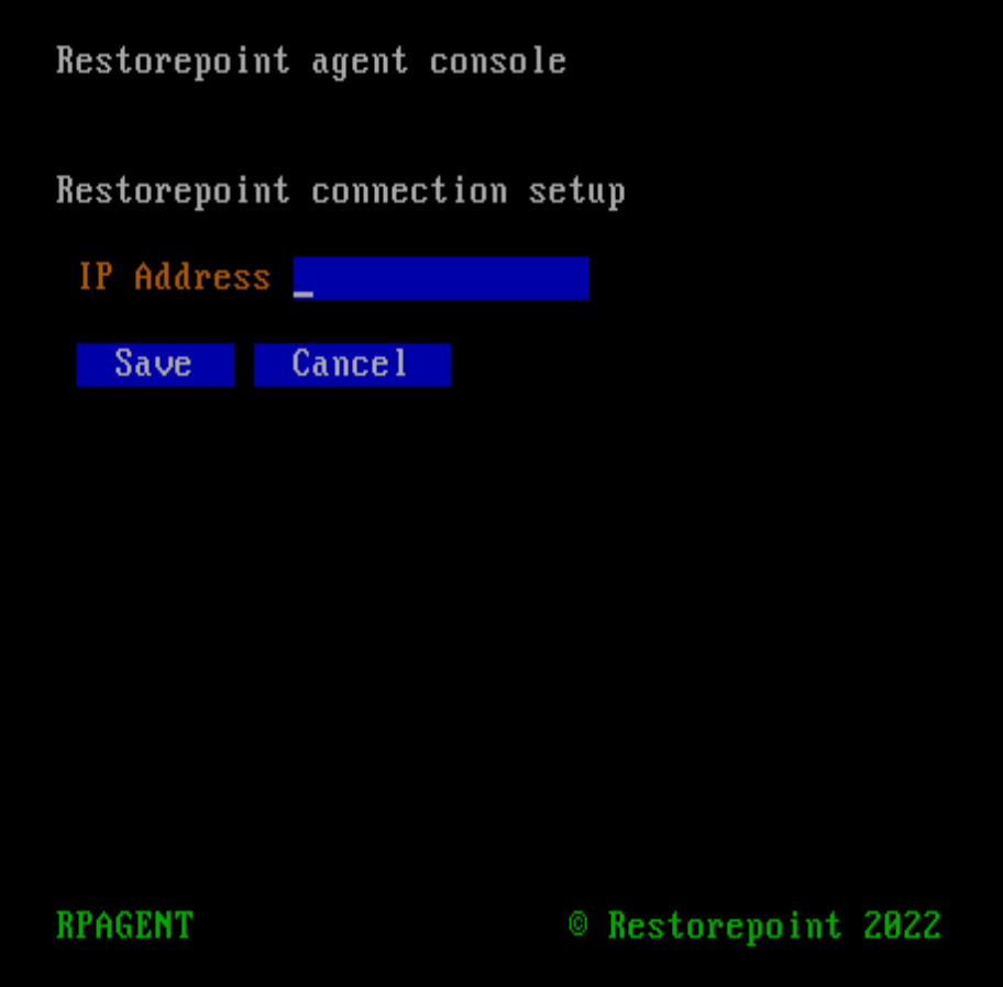

  1. SSH to the agent (or open the virtual machine console).
  2. Log in using the agent’s admin account.
  3. Select Change Restorepoint Master IP address in the console menu, and apply the new master IP address.
Do not use the option Initial Restorepoint Master Setup to set the new master IP address. If you use this option, it invalidates the master-agent authentication and would require re-pairing the agent to the master Skylar Compliance appliance.

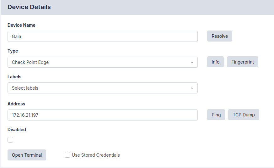

To move an existing device to an agent, select one or more devices from the Device Management List, and click Edit, then select the correct Agent in the drop-down menu as shown:
Image of the Restorepoint Device Details page
Operations using agents are completely transparent for the user. For instance, bulk operations can be started for agent-managed and directly-managed devices simultaneously.

You can view a list of the paired agents from the Administration > Agents page. To edit an agent’s settings, click the name of the agent.
The settings include the Name, Location, Domain, Email, whether to Alert on Disconnect/Reconnect, or allow you to factory Reset the Agent for re-pairing. There are additional settings for Debugging agent connections.
