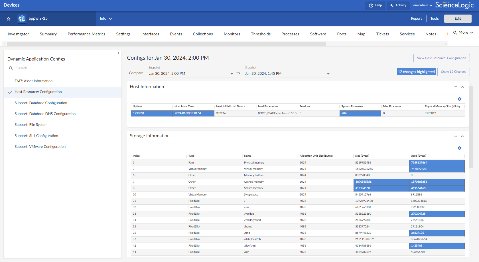

Viewing Device Snapshot Data
You can view all changes between two specific snapshot reference points of a Dynamic Application on the Configs tab of the Device Investigator page.
To view all changes between two snapshots of a Dynamic Application:
  1. Go to the Devices page.
  2. Locate the device for which you want to compare Dynamic Application snapshot data, and click its name under the Device Name column. The Device Investigator page appears.
  3. Click the Configs tab.
  4. Select a Dynamic Application from the collapsible Dynamic Application Configs pane on the left side of this page.
  5. NOTE: You can click the View <Dynamic Application Name> button to open the Dynamic Application Properties Editor modal for that Dynamic Application.
  6. Select two snapshots to compare in the Snapshot drop-down menu. By default, this page will compare the current system and the last snapshot. All changes are highlighted.
  7. Click the [Show X Changes] button, where the variable "X" is the number of changes between the two snapshots, located in the upper right side of the page. The Host Resource: Configuration modal appears.
  8. In this modal, you can view a more detailed breakdown of how these values changed between the two snapshots.
