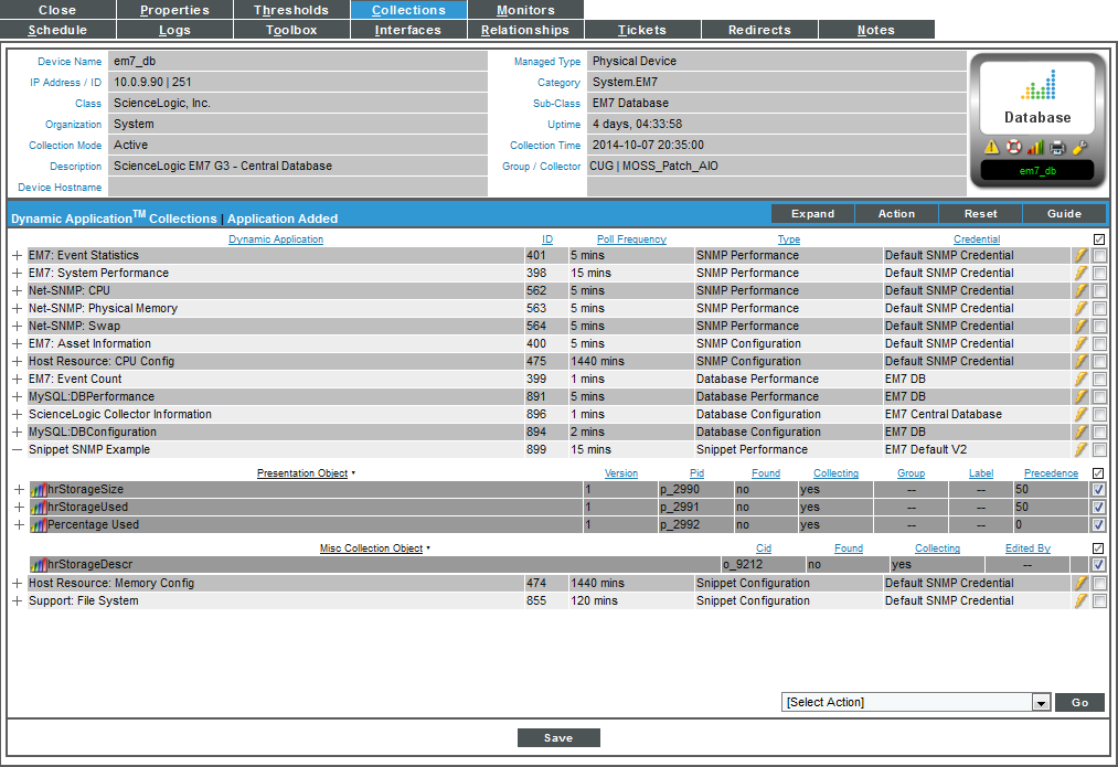

Aligning the Dynamic Application with a Device
To align this Dynamic Application to a device, perform the following steps:
- Go to the Device Manager page (Devices > Classic Devices, or Registry > Devices > Device Manager in the classic user interface).
- Select the wrench icon (
) for the device you want to align the Dynamic Application with. The Device Properties page is displayed.
TIP: To find a device to align with the Dynamic Application, go to the Device Hardware page (Devices > Hardware) and search for devices with Comp Type of File System.
- Select the tab. The Dynamic Application Collections page is displayed.
- Select the Action menu and choose Add Dynamic Application.
- In the Dynamic Application Alignment modal page, select our example Dynamic Application, Snippet SNMP Example. Select the credential you created in the previous section.
- Select the button. The page refreshes, and the Snippet SNMP Example Dynamic Application is displayed in the list of Dynamic Applications.

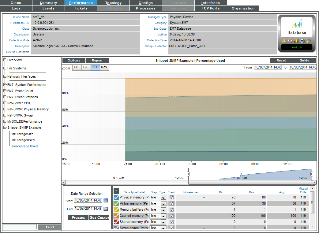

Viewing Performance Data
The first collected values will be stored within one minute. To view the performance data for this Dynamic Application:
- Select the graph icon (
) for the device you aligned the Dynamic Application with. The Device Summary page is displayed. - Select the tab. The Device Performance page is displayed.
- Select Snippet SNMP Example in the left Navbar, then the Storage Percent presentation object Dynamic Application. A performance graph will be displayed.
