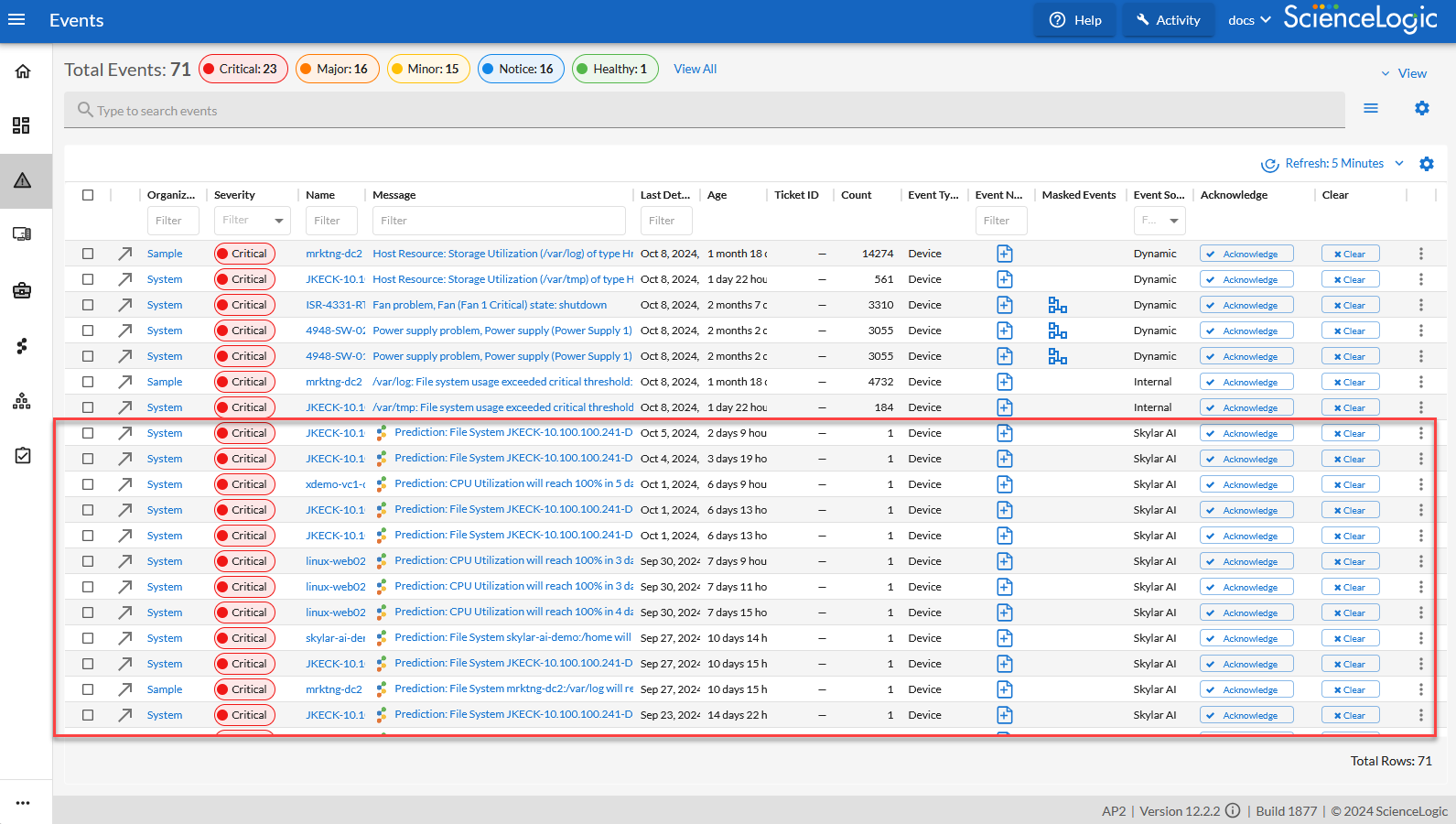

Predictive alerts display the Skylar icon () to the left of the event message in the Message column of the Events page, and the message starts with the word "Prediction":
Image of an SL1 Events page.
To view details about a predictive alert:
  1. In SL1, go to the Skylar AI page () and click the Visit button for Skylar Predictive Alerting. A filtered Events page displays a list of predictive alerts.
  2. On the Events page, click the message for a predictive alert with the Skylar icon (). The Event Investigator page for that alert appears.

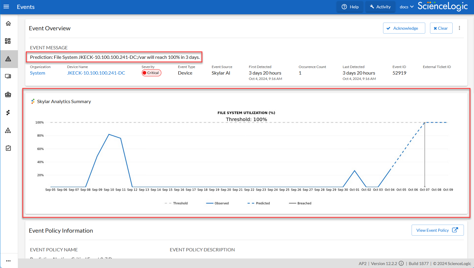

  3. On the Event Investigator page, the Skylar Analytics Summary panel displays a timeline of data from Skylar AI about a specific metric:
    Image of an SL1 Event Investigator page with Skylar Analytics.
    The dotted line on the graph in the Skylar Analytics Summary panel represents a time frame in the future that Skylar AI is forecasting, based on pattern recognition.
    The blue line represents the activity observed so far by SL1, and the gray dotted line represents the threshold set in SL1.The blue dotted line represents where Skylar AI is predicting a potential alert in the future, with the gray line representing a potential problem in the future, also predicted by Skylar AI.
    In the example above, Skylar AI predicts that the file system utilization will hit the threshold of 100% in three days, on October 7th. By tracking the timeline on the graph, you can see when a potential event might happen, and you can take action now to prevent it.

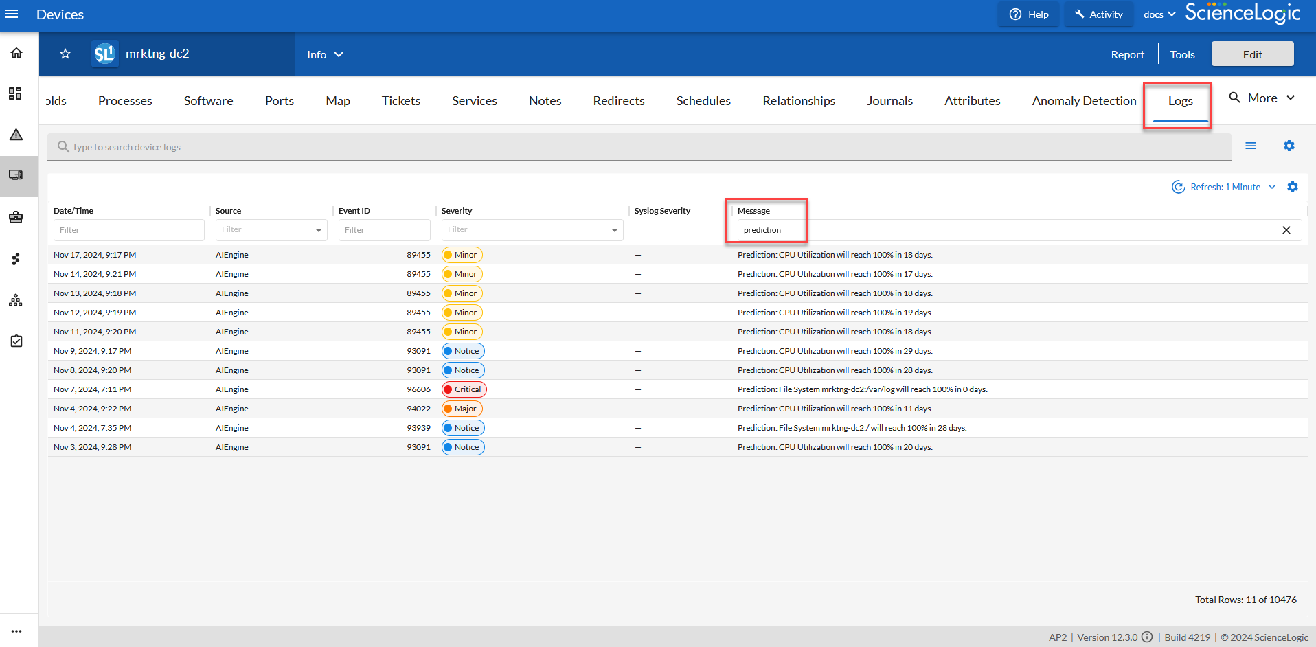

You can also review the logs for a specific device to view the history of the predictions:
  1. On the Devices page or the Events page, select the device with the predictive alerts. The Device Investigator page for that device appears.
  2. Click the Logs tab. A list of recent logs displays:
    Image of the Logs tab of the Device Investigator, showing predictive alerts.
  3. If needed, type "prediction" in the Message column to view only the predictive alerts.
