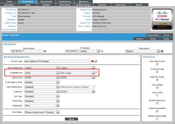

Configuring Availability Monitoring on a Device
SL1 uses ports to monitor a device's availability. You specify which ports to use for device availability in the Device Properties page.
NOTE: Unlike for hardware-based devices, SL1 does not use ICMP, TCP, or UDP to monitor availability for component devices. Component devices use a Dynamic Application collection object to measure availability. SL1 polls component devices for availability at the frequency defined in the Dynamic Application. For more information, see the section Configuring Availability for Component Devices.
To configure availability monitoring for a device:
  1. In the Device Manager page, find the device for which you want to configure availability monitoring. Click its wrench icon (). The Device Properties page displays:
  1. In the Device Properties page, edit the following fields:
  • Availability Port . Specifies the protocol (first drop-down menu) and specific port (second drop-down menu) that SL1 should monitor to determine if the device is available. The list of ports will contain all the ports discovered by SL1. The data collected from this port will be used in device availability reports. Protocol options include:
  • TCP. Availability is based on whether SL1 can connect to the device using the specified TCP port.
  • ICMP. Availability is based on whether the device responds to an ICMP ping request from SL1. If you select ICMP as the protocol, you can use the ICMP Availability Thresholds fields in the Device Thresholds page to further define how SL1 will test the device's availability.
  • SNMP. Availability is based on whether the device responds to an SNMP GET request from SL1.
  • ScienceLogic Agent. Availability is based on whether the SL1 Agent is reporting data to SL1. The agent must be installed on the device to use this option.
  • Avail + Latency Alert. Specifies how SL1 should respond when the device fails an availability check, a latency check, or both. These options allow you to create separate events when SNMP fails on a device and when a device is not up and running (indicated by the device failing both the availability check and the latency check). Choices are:
  • Enabled. SL1 will create the following events:
    • If the device fails the availability check, generates the event "Device Failed Availability Check: UDP - SNMP".
    • If the device fails the latency check, generates the event, "Network Latency Exceeded Threshold: No Response".
    • If the device fails both the availability check and the latency check, generates the event "Device Failed Availability and Latency checks".
  • Disabled. SL1 will create the following events:
    • If the device fails both the availability check and the latency check, generates the Major event "Device Failed Availability Check: UDP - SNMP". The Minor event "Network Latency Exceeded Threshold: No Response" is rolled up under the availability event.
NOTE: The Ping & Poll Timeout (Msec) setting in the Behavior Settings page (System > Settings > Behavior) affects how SL1 monitors device availability. This field specifies the number of milliseconds the discovery tool and availability polls will wait for a response after pinging a device. After the specified number of milliseconds have elapsed, the poll will timeout.
