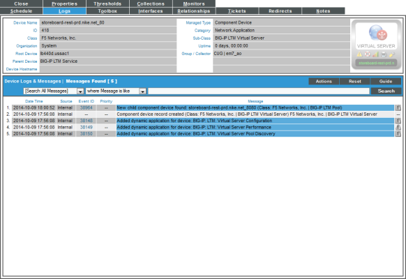

In the Device Administration panel, the Device Logs & Messages page displays all the messages SL1 and the SL1 agent, if applicable, have collected from the device. You might find it helpful to view these log entries during troubleshooting or to manually check on the status of a device.

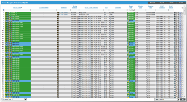

  • Go to the Device Manager page (Devices > Device Manager).
  • In the Device Manager page, find the device for which you want to view the device logs. Select its wrench icon ().

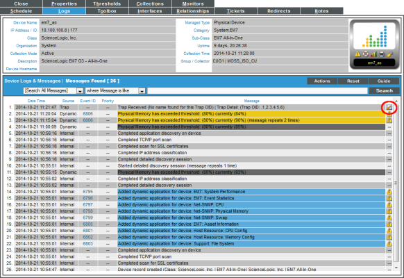

  • The Device Logs & Messages page displays the following about each log entry:
  • Date Time. The date and time the entry was made in the log.
  • Source. The entity or process that generated the message.
  • Syslog. Entry was generated from standard system log generated by device.
  • Internal. Entry was generated by SL1.
  • Trap. Entry was generated by an SNMP trap.
  • Dynamic. Entry was generated by a Dynamic Application.
  • API. Entry was generated by another application.
  • Email. Entry was generated by an email message from a third-party application to SL1.
  • ScienceLogic Agent. Entry was generated by the SL1 Agent.
  • Event ID. If an event was created, a unique event ID, generated by SL1. If the log entry is not associated with an event, no ID appears in this column.
  • Priority. If applicable, specifies the priority of the syslog message.
  • Info. An error occurred.
  • Notice. An error has not occurred. Entry denotes normal system activity.
  • N / A. Not applicable. Entry was not generated by syslog.
  • Message. Text of the log entry, color coded to match event severity (if applicable).

  • In the Device Logs & Messages page, find the log entry you are interested in. Select its event icon ().
  • The Viewing Events page appears for the device and displays the event associated with the selected log entry. For details on events, see the section on Events.
