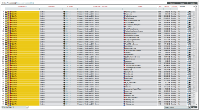

Viewing the List of System Processes on All Devices
The Device Processes page displays a list of all processes discovered by SL1 on all devices.
To view the list of all processes running on all discovered devices:
- Go to the Device Processes page (Devices > Processes).
- The Device Processes page displays the following about each process:
To sort the list of processes, click on a column heading. The list will be sorted by the column value, in ascending order. To sort the list by descending order, click the column-heading again.
- Device Name. Name of the device where the process resides. For devices running SNMP or with DNS entries, the name is discovered automatically. For devices without SNMP or DNS entries, the device's IP address will appear in this field.
- Organization. Organization associated with the device where the process resides.
- IP Address. IP address of the device where the process resides.
- Device Classification / Sub-Class. The manufacturer (device class) and type of device (sub-class). The Device-Class/Sub-Class is automatically assigned during auto-discovery.
- Process. The name of the process. A single process name can have multiple entries.
- PID. A unique ID for the process. The device's operating system assigns this value.
- Memory. The amount of memory currently used/reserved for the process.
- Run State. The current state of the process:
- Runnable. Process is ready to run as needed.
- Running. Process is currently running.
- Not Running. Process is in a "waiting" state.
- Invalid. Process is part of an operation that failed. Process was not ended gracefully.
NOTE: Run states are defined by a device's operating system and/or installed agents. Run states may differ between devices.
- Monitored. Specifies whether or not SL1 monitors the process:
- Yes. SL1 currently monitors this process.
- No. SL1 does not currently monitor this process.

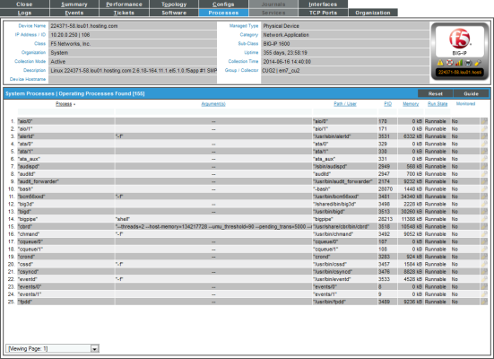

Viewing a List of System Processes on a Single Device
On the Device Investigator, you can view information about the processes running on the device. The tab displays a combined list of processes collected via SNMP and the agent, where applicable.
tab of theFor each process, the System Processes page displays the following information:
To sort the list of processes, click on a column heading. The list will be sorted by the column value, in ascending order. To sort the list by descending order, click the column heading again.
- Argument(s). The arguments with which the process was invoked.
- Path/User. The path where the process executable resides. The value in this field varies, depending on the device's operating system and installed agents.
- Memory. The amount of memory currently being used/reserved for the process.
- Run State. The current state of the process. This can be one of the following:
- Monitored. Specifies whether or not SL1 is monitoring this process.

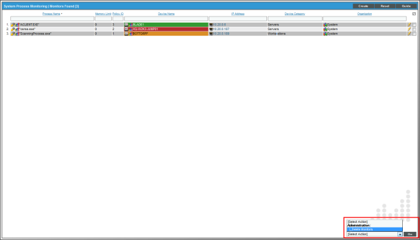

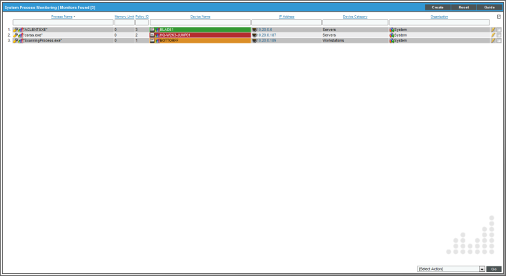

Viewing the System Process Monitoring Policies
You can view a list of system process monitoring policies from the System Process Monitoring page (Registry > Monitors > System Processes).
The System Process Monitoring page displays the following information about each system process:
- Process Name. Name of the policy.
- Memory Limit. The maximum amount of memory that can be used or reserved by a single instance of the process, as specified in the process policy.
- Policy ID. Unique, numeric ID, assigned to the policy automatically by SL1.
- State. Whether the policy is enabled or disabled.
- Device Name. Name of the device associated with the policy.
- IP Address. IP address of the device associated with the policy. This is the IP address SL1 uses to communicate with the device.
- Device Category. Device category of the device associated with the policy.
- Organization. Organization for the device associated with the policy.
- Delete Monitors. Deletes the selected policies from SL1. The associated reports (from the Device Reports > Performance tab) are also deleted.
- Enable Monitors. Enables the selected policies so that SL1 can collect the data for these policies.
- Disable Monitors. Disables the selected policies. SL1 will not collect the data specified in these policies.

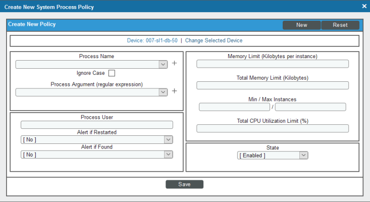

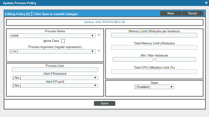

Defining a System Process Monitoring Policy
You can define a system process monitoring policy for a device on the Device Investigator.
tab of the
To define a system process monitoring policy:
- Go to the Devices page and click the Device Name of the device for which you want to define a system process monitoring policy. The Device Investigator displays.
- Click the tab.
- Click Create System Process Policy. The System Process Policy modal appears: , and then select
- In the System Process Policy modal, supply a value in each of the following fields:
- Process Name. The name of the process. You can either:
- Select from a list of all processes running on this device.
- Click on the "+" icon and manually enter the name of a process.
- Ignore Case. Select this option if you want SL1 to ignore case-sensitivity in this process name when determining whether to run the system process policy.
- Process Argument (regular expression). The arguments with which the process is invoked. This field includes a drop-down list of all arguments currently in use by the current device for the specified process (specified in the Process Name field). If you don't want to use an argument from the drop-down, you can manually enter a valid regular expression in this field. If you want to include special characters in this regular expression, be sure to escape those special characters. The Create System Process Policy modal will display an error message if the regular expression is not valid. SL1 will match the policy to a process if the value in this field appears anywhere in the argument string for that process. For example "win" would match arguments for "windows" and "win2k".
- Process User. Search for the following process user or process owner when the process is running. This field is helpful for finding processes running as root that should not be.
NOTE: Some hardware includes information about a process user or owner for each process in the SNMP data; some does not. Do not specify a value in the Process User field if the device does not include process user or process owner information in its SNMP data. If you specify a process user, and a device does not include process user in its SNMP data, SL1 will not generate an alert, even if it finds this process running
- Alert if Restarted. You can use this field to generate an alert in the Device Log if a system process restarts. Your choices are:
- Yes. Use this setting to check for system processes that have restarted. SL1 checks every 5 minutes to determine if a system process has restarted. If SL1 finds a restarted system process, it will generate an alert in the Device Log.
- No. Use this setting if you do not want SL1 to check for system processes that have restarted.
NOTE: When a system process has been restarted, it receives a new process ID number. It might take up to 2 hours for this new ID to appear on the Process Manager page (System > Settings > Processes).
NOTE: In some cases, this alert might appear if a device is restarted.
- Alert if Found. You can use this field in one of two ways: generate an event when a required system process is not running or generate an event when an illicit system process is running. Your choices are:
- Yes. Use this setting to look for illicit processes.
- If SL1 finds the illicit process (specified in the Process Name field), SL1 will generate an event.
- If SL1 does not find the illicit process running, SL1 will not generate an event.
- No. Use this setting to ensure that a required process is running.
- If SL1 finds the required (specified in the Process Name field) running, SL1 does not generate an event.
- If SL1 does not find the required process running, SL1 generates an event.
- Memory Limit (Kilobytes per instance). The amount of memory, in kilobytes, you will allow each instance of the process to use. This is an optional field.
- Total Memory Limit (Kilobytes). This setting is modifiable only if the SL1 Agent is running on the selected device. The amount of memory, in kilobytes, you will all instances of the process to use in total. This is an optional field.
- Min Instances. The minimum number of instances of the process that should be running. If the minimum instances are not running, SL1 generates an event. The event will be of severity "major" and will say "too few processes running."

Example Policy for a System Process
- This policy monitors a system process on the device "em7ao".
- The policy looks for the process "crond".
- If the process is not found running on the device, SL1 generates an event.
Defining a Monitoring Policy for a System Process in the Classic SL1 User Interface
You can define a process monitoring policy in the System Process Policy modal. You can access the System Process Policy page either from the Device Manager page (Devices > Device Manager) or from the System Process Monitoring page (Registry > Monitors > System Processes).
To access the System Process Policy modal from the Device Manager page:
- Go to the Device Manager page (Devices > Device Manager)
- In the Device Manager page, find the device that you want to associate with the monitoring policy. Select wrench icon (
) for the device.
- In the Device Administration panel for the device, select the tab.
- From the Create System Process Policy. menu in the upper right, select
- The System Process Policy modal appears.
To access the System Process Policy modal from the System Process Monitoring page:
- Go to the System Process Monitoring page (Registry > Monitors > System Processes).
- Select the button.
- Click the device icon (
) for the device you want to align to policy with.
For information about completing the fields in the System Process Policy modal, see the section on Defining a Monitoring Policy for a System Process.
Editing a System Process Monitoring Policy
To edit a system process monitoring policy:
- Go to the Devices page and click the name of the device for which you want to edit a monitoring policy. The Device Investigator displays.
- Click the tab.
- Find the policy you want to edit and click its wrench icon (
). The System Process Policy modal appears.
- In the System Process Policy modal, you can change the values in one or more of the fields described in the section on Defining a Monitoring Policy for System Processes.
- Click .

- From the System Process Monitoring page (Registry > Monitors > System Processes):
- In the System Process Monitoring page, find the policy you want to edit and click its wrench icon (

You can delete one or more system process policies from the System Process Monitoring page. When you delete a monitoring policy, SL1 no longer uses the policy to collect data from the aligned device. Deleting a monitoring policy will also remove all data that was previously collected by the policy.
To delete a system process policy in the classic SL1 user interface:
- In the System Process Monitoring page, select the checkbox(es) for each system process policy you want to delete. Click the checkmark icon (
) to select all of the system process policies.
- In the Delete Monitors. menu in the bottom right of the page, select
- Click .
- The policy is deleted from SL1. The associated reports (from the Device Reports > tab) are also deleted.
