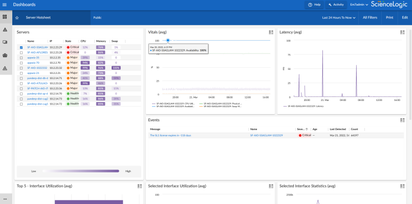

A dashboard is a page that displays one or more graphical reports, called widgets. SL1 includes pre-defined widgets that can be customized and displayed in the
To define an instance of a widget, you first select from a list of pre-defined widget definitions, and then customize what will be displayed by the selected widget by supplying values in the option fields provided by that widget.
The Custom Table widget displays multiple instances of an entity in a table. The Custom Table widget can be configured to display a list of devices, device classes, or device groups (and also other entities).
The generated table displays information about each entity in the list. You can configure which information is included in the table in the Layout Editor pane during configuration.
The Layout Editor panel displays the columns that will be displayed in the widget.
In the example above, Color and Device Location are custom attributes for devices.
