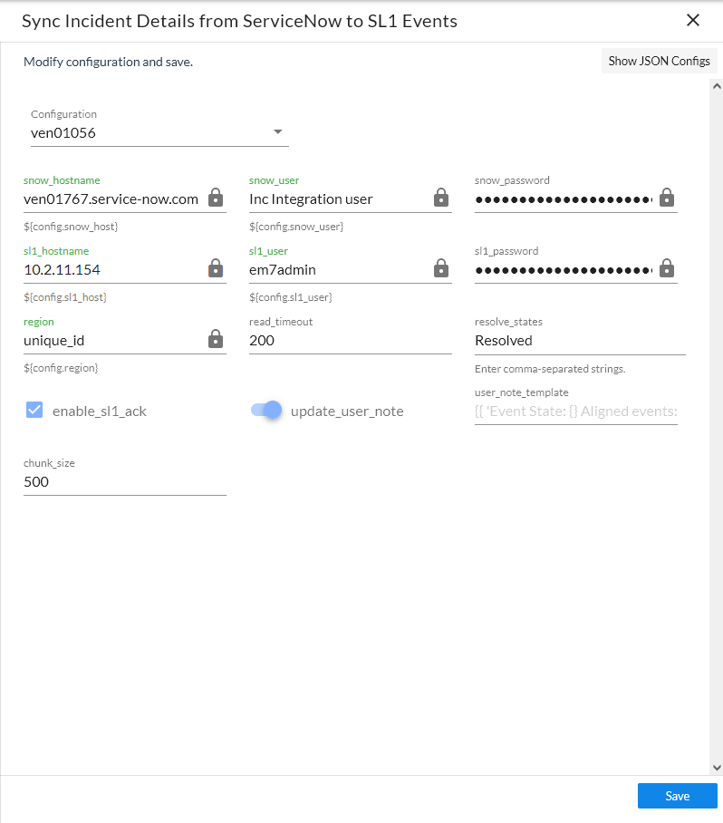

Configuring PowerFlow
  1. Create a configuration object in the PowerFlow user interface
  2. Configure the following PowerFlow applications:
  • "Cache Skylar One Users"
  • "Sync Cached Events to ServiceNow"
  • "Sync Skylar One Event to ServiceNow Incident"
  • "Sync Incident Details from ServiceNow to Skylar One Events"
  1. Schedule the PowerFlow applications as needed

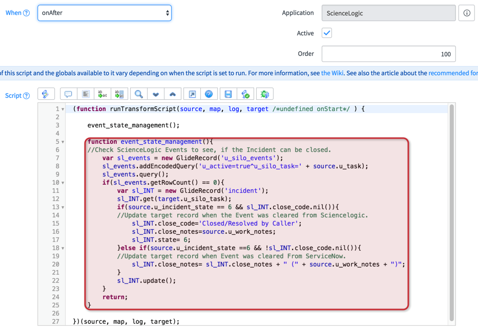

You can edit the snippet code in the run book action to adjust the behavior for changing states when a Skylar One event is acknowledged or cleared. For more information, see Customizing the Snippet Code in the Input Parameters Pane.

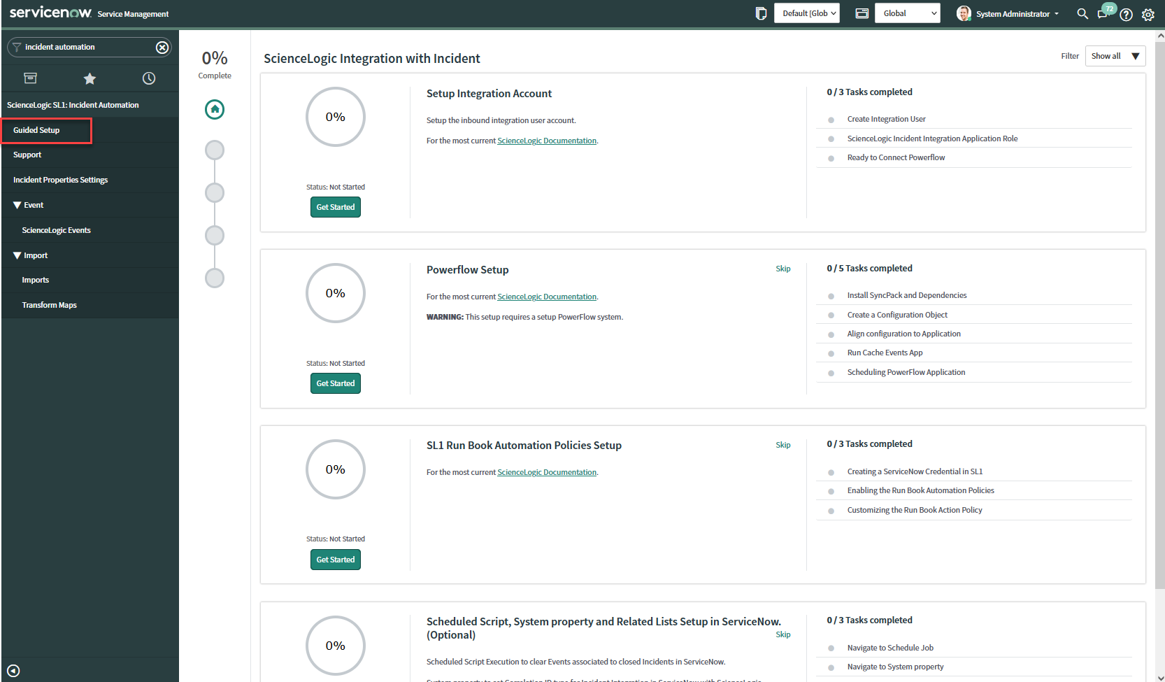

In ServiceNow, you can use the Guided Setup process to configure an integration user account, configure a Skylar One Incident Integration Application role, and connect to PowerFlow.
To use the Guided Setup process in ServiceNow
  1. In ServiceNow, go to ScienceLogic Skylar One: Incident Automation > Guided Setup. The ScienceLogic Integration with Incident page appears:
  2. In the Setup Integration Account section, click Get Started and complete the tasks in order.
  3. Click Configure button to configure each task.
  4. After you complete each task, click Mark as Complete.
  5. After you finish all the tasks in the Setup Integration Account section, complete the steps in the PowerFlow Setup section and Skylar One Run Book Automation Policies Setup section.
    These tasks are explained in the Guided Setup sections in ServiceNow , and they are also explained in this manual.
  6. Optionally, you can run the steps in the Scheduled Script, System property and Related Lists Setup in ServiceNow section.

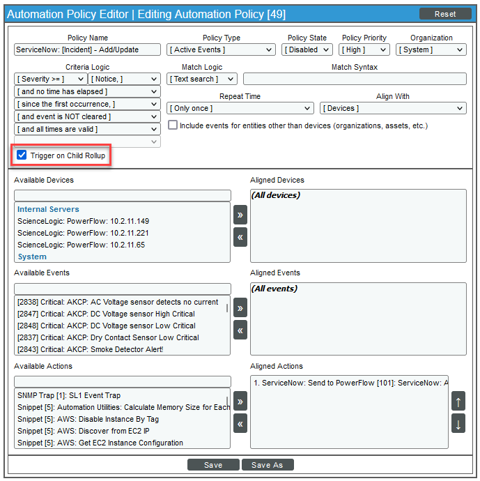

To enable the three ServiceNow run book automation policies:
  1. In Skylar One, go to the Automation Policy Manager page (Registry > Run Book > Automation).
  1. Locate the "ServiceNow: [Incident] - Add/Update" automation policy and click its wrench icon (). The Automation Policy Editor page appears.
  • Policy Priority. Select High to ensure that this PowerFlow automation policy is added to the top of the queue.
  • Available Actions. If it is not already selected, select the corresponding ServiceNow run book action policy. Filter the Available Actions section by typing "ServiceNow" in the search field.
    By default, the "ServiceNow: [Incidents] Add/Update" automation policy will create ServiceNow Incidents for all devices. You can limit the devices affected by making changes to the Organization, Severity, Match Logic, Aligned Devices, and/or Aligned Events fields.
  2. Repeat steps 2-4 for the "ServiceNow: [Incident] - Event Acknowledged" and "ServiceNow: [Incident] - Event Cleared" run book automation policies.

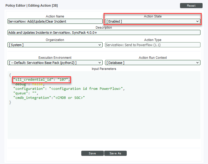

The "ServiceNow: Add/Update/Clear Incident" run book action policy contains snippet code that you can customize to use with the "ServiceNow Incident" SyncPack.
You can edit these values in the Input Parameters pane of the Actions page for this policy.
Make sure you are using the most recent version of the run book action policy. If there are two policies with the same name, always use the policy with the higher number in the ID column of the Actions page.
To enable and customize the Incident run book action policy:
  1. In Skylar One, go to the Actions page (Registry > Run Book > Actions).
  2. Locate the "ServiceNow: Add/Update/Clear Incident" policy and click its wrench icon (). The Action Policy Editor page appears:
  1. For the Action State filed select Enabled.
  2. For the sl1_credential_id field in the Input Parameters pane, specify the credential ID form the ID column on the Credential Management page (System > Manage > Credentials). For example: "sl1_credential_id": "107"
  3. Edit the snippet code as necessary, using the information in the Customizing the Snippet Code in the Input Parameters Pane section, below.
  4. When you are finished, click Save.

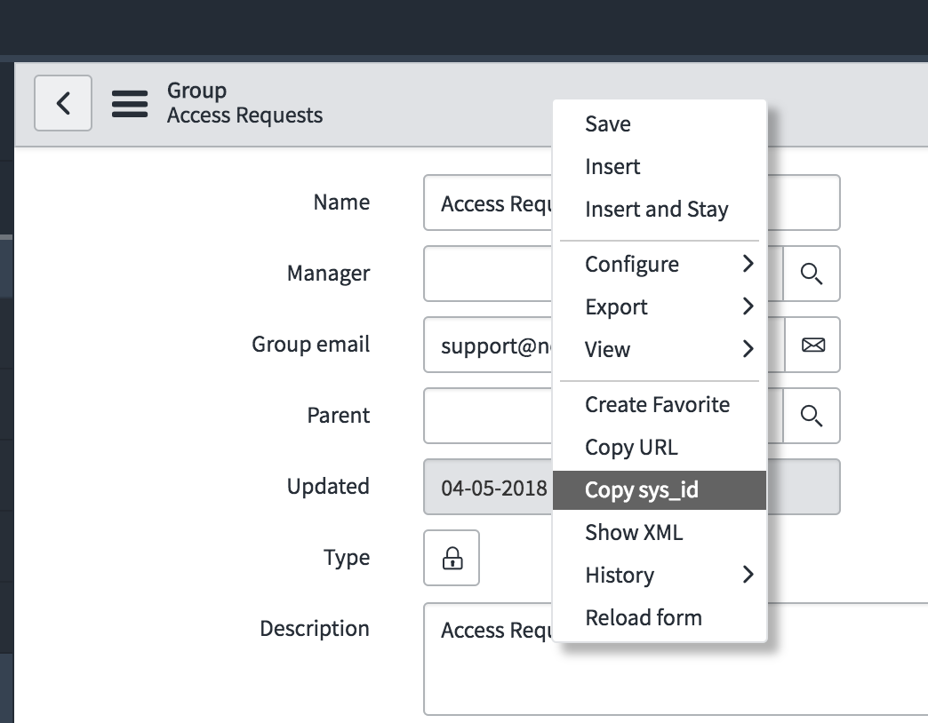

  • To assign an assignment group, set the variable value to the sys_id of the ServiceNow Assignment Group. In the following example, the assignment group is assigned to incidents that are cleared:
    "assignment_group_new": "",
    "assignment_group_ack": "",
    "assignment_group_clear": "sys_id"

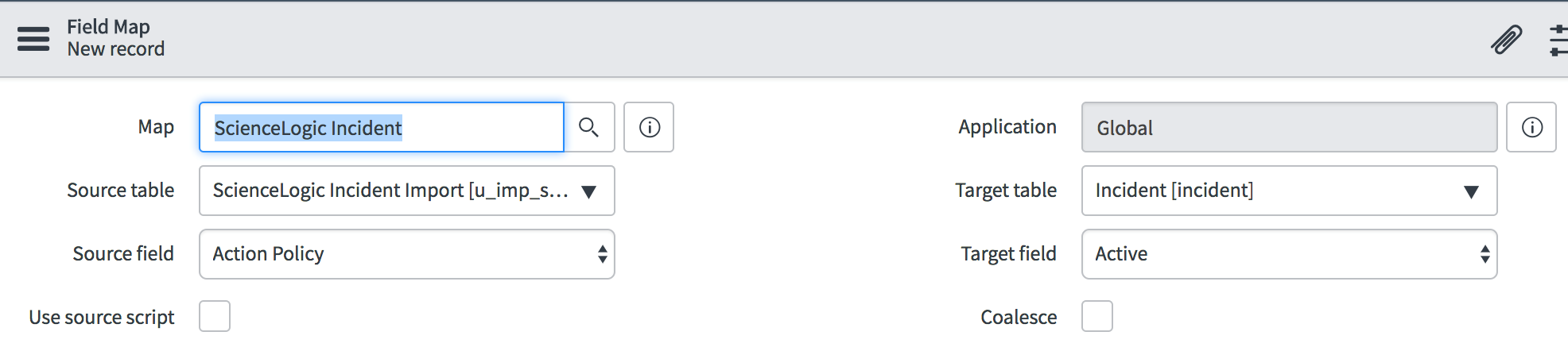

Passthrough Example

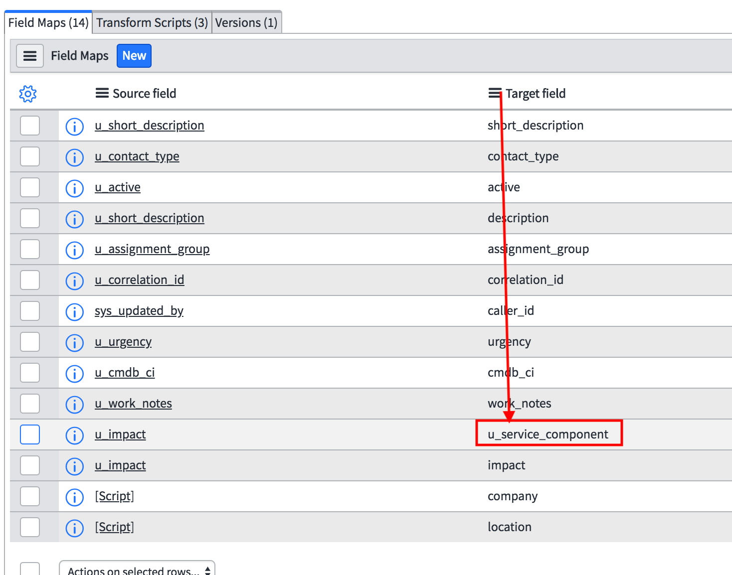

For the Dictionary Entry of the ServiceNow field on the import table, you can reference the XML of the record. You will need to copy the <sys_name> value so you can use that as the key for the passthrough.
In this example, you want to bring in an additional field called sl1 category.
  1. Create the new sl1 category field on the import table in ServiceNow. You can right-click on the header of the form to view the XML:
  2. Look for the <sys_name> value.
  3. Copy that value directly out and use that in your EM7_RESULT for the passthrough value (in the Snippet Code pane):
    EM7_RESULT = {'sl1 Category': 'test'}

  • Available Actions. If it is not already selected, select ServiceNow: Send to PowerFlow: ServiceNow: Add/Update/Clear Incident and add it to the Aligned Actions field.
  1. Click Save. The "Click to Create" feature is now available on the Events and Event Investigator pages.

    2. Go to the Applications page, open the "Sync Incident Details from ServiceNow to Skylar One Events" application, and click Configure. The Configuration pane for that application appears:
      This application populates the incident numbers in Skylar One as well as updating other incident behaviors.
    3. From the Configurations drop-down, select the configuration object you want to use.
    4. Update the following fields, as needed:
    • resolve_states. Specify one or more state labels that PowerFlow will consider as "Resolved", separated by commas. Skylar One Events associated with a ServiceNow Incident in these states will be cleared.
    • enable_sl1_ack. Select this option to allow this integration to acknowledge events. The application attempts to acknowledge with the user assigned to the incident.
    • update_user_note. De-select this option if you do not want this application to update the User Note in Skylar One.
    • user_note_template. Lets you add a Jinja2 template to define a customer format for populating the User Notes in Skylar One. If you leave this field blank, PowerFlow uses the state label that displays in gray text. For more information about Jinja2 filters, see the List of Built-in Filters in the Jinja2 documentation.
      The following is an example of a Jinja2 template that you can use in this field:
      {{'Incident {} is assigned to {} has {} events aligned to it and is currently in state {}'.format(incident.incident_number, incident.user.user|default(None), incident.events|length, incident.state)}}

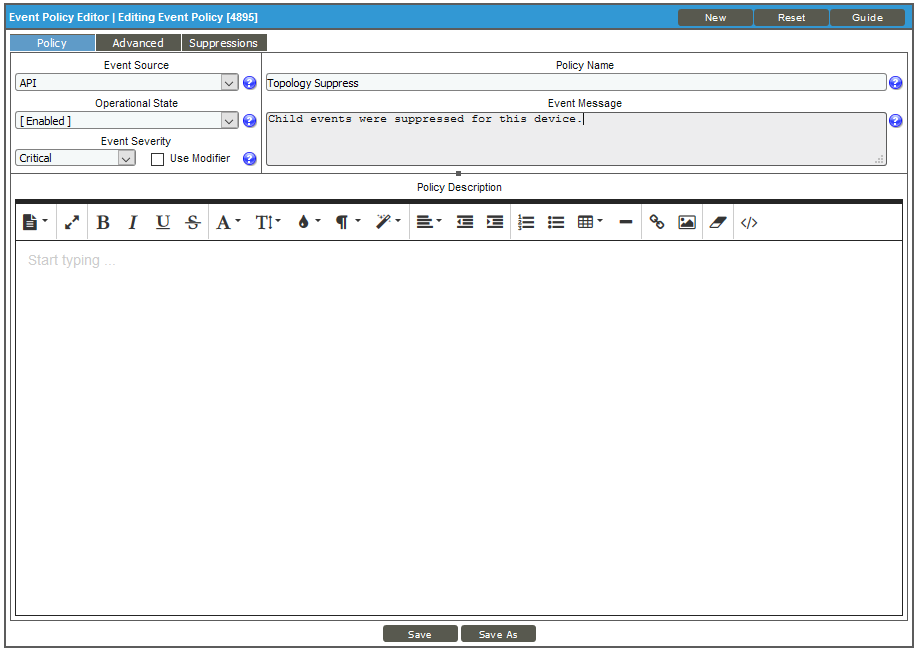

    1. In Skylar One, navigate to the Event Policy Manager page (Registry > Events > Event Manager) and click the Create button. The Event Policy Editor modal appears:
    1. On the Policy tab, update the following fields:
    • Event Source: Select API.
    • Operational State: Select Enabled.
    • Event Severity: Select Critical as the severity of the event.
    • Policy Name. Type the name of the event. Can be any combination of alphanumeric characters, up to 48 characters in length
    • Event Message. Type the message that will appear when this event occurs.

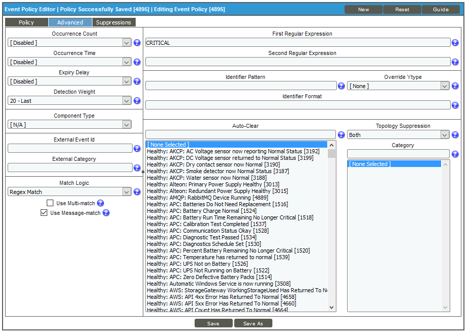

    1. Click the Advanced tab.
    1. On the Advanced tab, update the following fields:
    • Detection Weight. Select 20 - Last. If two event definitions are very similar, the weight field specifies the order in which Skylar One should match messages against the similar event definitions. The event definition with the lowest weight will be matched first. This field is most useful for events that use expression matching. Options range from 0 (first) - 20 (last).
    • Match Logic. Select Regex Match. Specifies whether Skylar Oneshould process the First Match String field and Second Match String as regular expressions or as simple text matches. Because you selected Regex Match, you cannot define a "match all" expression by leaving the First Match String and Second Match String fields empty.
    • Use Message-match. Select this option. If Skylar One has generated an event and then a second log message or alert matches the same event policy for the same entity, Skylar One will not generate a second event, but will increase the count value for the original event. This behavior will occur only if the log messages or alerts contain the same message.
    • First Regular Expression. Type "CRITICAL" as the string used to correlate the event with a log message.
    • Topology Suppression. Select Both. If this event occurs on a parent device, it behaves as a suppressing event. If this event occurs on a child device, it behaves as a suppressible event.
    1. Click Save and close the Event Policy Editor modal.

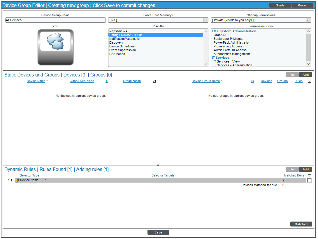

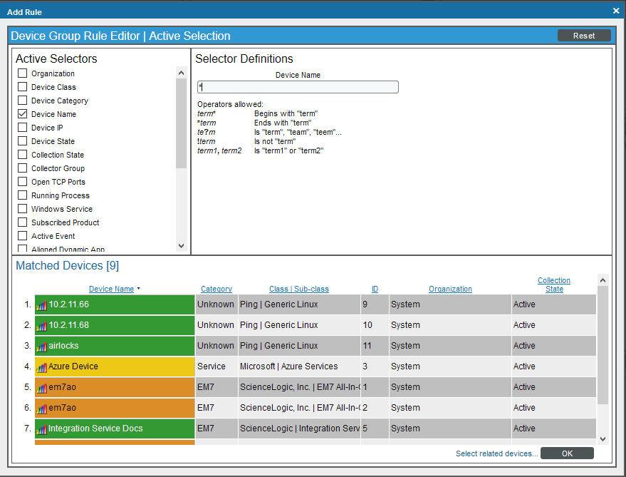

    2. Next, go to the Device Groups page (Registry > Device Groups) and click the Create button. A Device Group Editor page appears:
    1. Complete the following fields, and leave the default settings for the remaining fields:
    • Template Name. Specify the name of the new device group.
    • Force Child Visibility. Select "No".
    • Visibility. Select Config Policies/Bulk Edit to let you configure all the devices in the new device group using a device template.
    1. Click the Save button and then click the Add button in the Dynamic Rules pane to add dynamic rules to the new device group. The Device Group Rule Editor modal page appears:
    1. In the Active Selectors pane, select Device Name.
    2. Optionally, in the Selector Definitions pane, type an asterisk (*) in the Device Name field. Using the * includes all devices by Device Name. In the Matched Devices pane, a list of all devices appears.
    3. Click OK to close the modal page.
    4. On the Device Group Editor modal page, click Save and close the page.

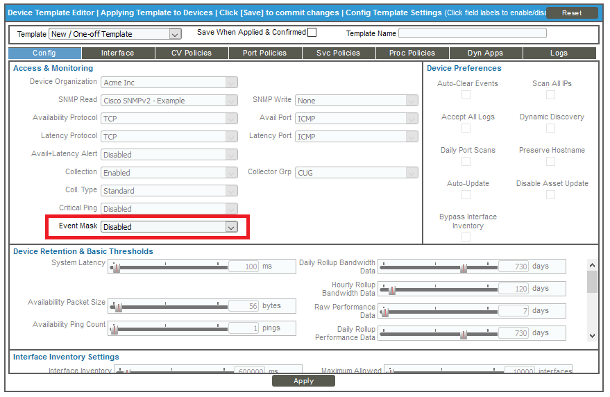

    1. Next, create a Device Group Template that will disable Event Masking for all devices in the new Device Group. Click the building blocks icon () for the new device group. A Device Template Editor page appears:
    1. Because all of the fields are disabled (grayed-out) by default, click the Event Mask field name to enable the field. Use the default setting of Disabled.
    2. Click Apply and click Confirm on the Device Template Editor page.
    3. Next, turn off the Trigger on Child Rollup option on the "ServiceNow: Add/Update Incident" Run Book Automation. Go to the Automation Policy Manager page (Registry > Run Book > Automation) and click the wrench icon () for the "ServiceNow: Add/Update Incident" Run Book Automation. The Automation Policy Editor page appears:
    1. Make sure the Trigger on Child Rollup option is not selected and click Save. Close the Automation Policy Editor page.

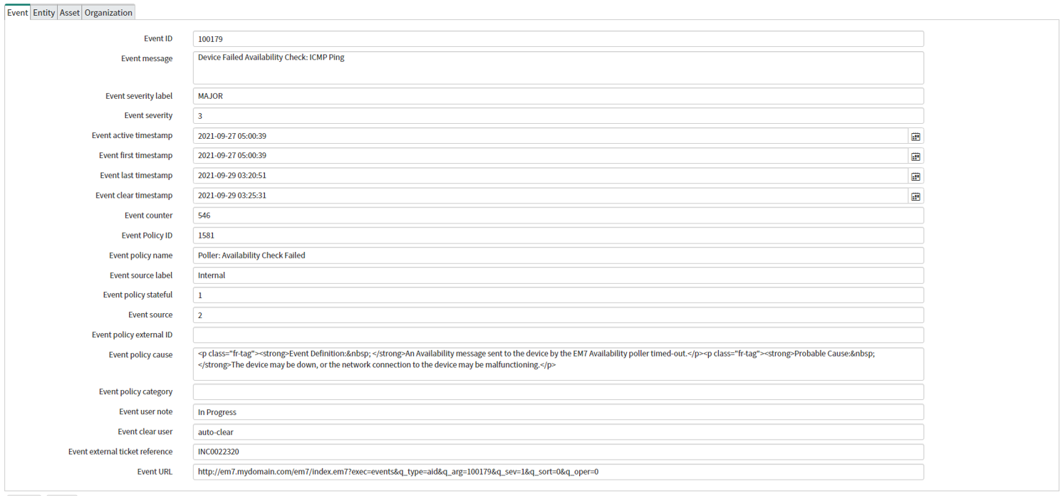

    Within ServiceNow, the Incident Sync sends as much data as possible, but limits what is sent or updated directly to the incident table. All Skylar One Event-specific data is mapped to a separate record and custom application-specific table. A related list option is available to provide event record data that you can view from the incident.
    The related list [Skylar One] Events is not configured when you install the Certified application. You need to add that related list to the incident form.
    You can also view the actual Event records at ScienceLogic Skylar One: Incident Automation > Event > ScienceLogic Events.

    Each Incident in ServiceNow will have one or more events aligned with it through a related list: [Skylar One] Event.
    By default the Hyperlink field "Event URL" only appears on the Event (x_sclo_incident_event) custom table provided by the Certified application. If a URL link is required, you would need to customize it to be applied to different location.
    The following image shows the Event record for an event aligned with an Incident:

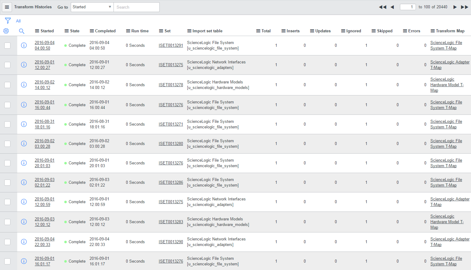

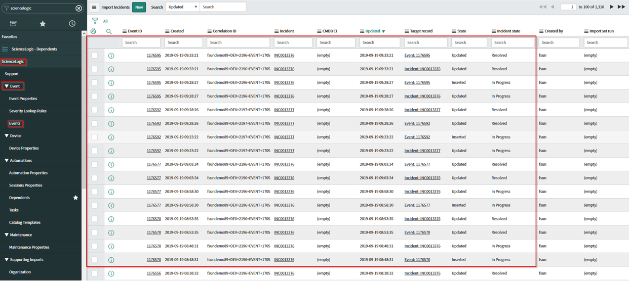

    Viewing the Incident Import Table in ServiceNow
    Each time Skylar One creates or changes an incident in ServiceNow, data is inserted into a temporary import table on the ServiceNow system. This table displays all inbound data from Skylar One and is a useful tool to determine what data is being sent and imported. The incident import table is created automatically when you install the ScienceLogic Certified (Scoped) Application.
    To view the data and the status of the import process, go to the Import Incidents page (ScienceLogic > Event > Events) in ServiceNow:
    You can view a complete audit of all import data and transforms by going to the Transform Histories page (System Import Sets > Advanced > Transform History):

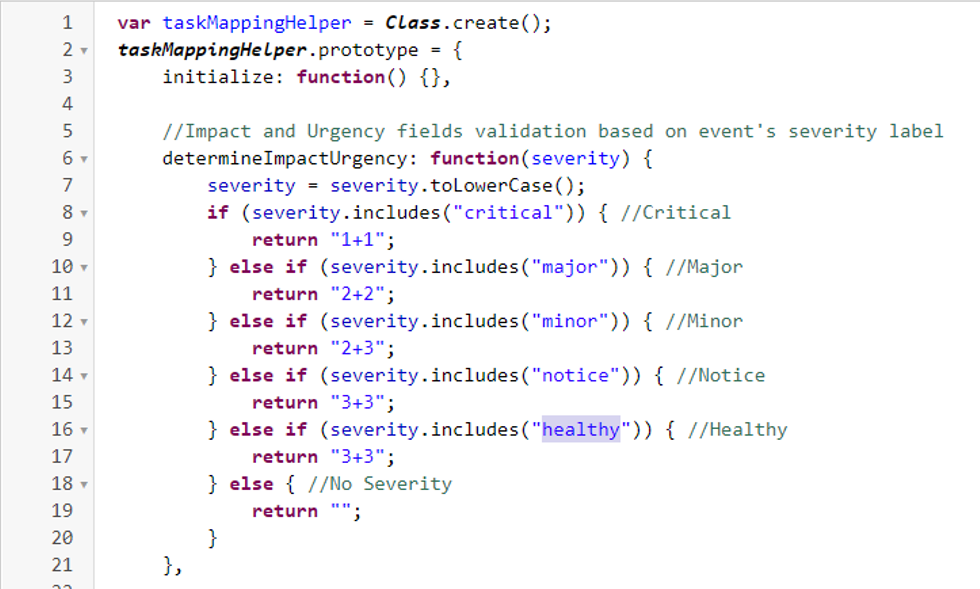

    The Severity conversions are handled in an "onBefore" transform script under the "ScienceLogic (Skylar One) Incident" transform map that automatically deploys with the ScienceLogic Certified (Scoped) Application.
    The "onBefore" transform script calls a script include called "taskMappingHelper" that handles the conversion from Severity to Impact or Urgency.
    To customize a Severity to Impact or Urgency conversion rule:
    1. In ServiceNow, create a new script include with new conversion rules. You can change the return values for Skylar One Severity labels to the desired Impact and Urgency values. The following is an example:
      In the above example, if the Skylar One Severity label is Minor, return the corresponding ServiceNow Incident Impact of 2 and Urgency of 3.

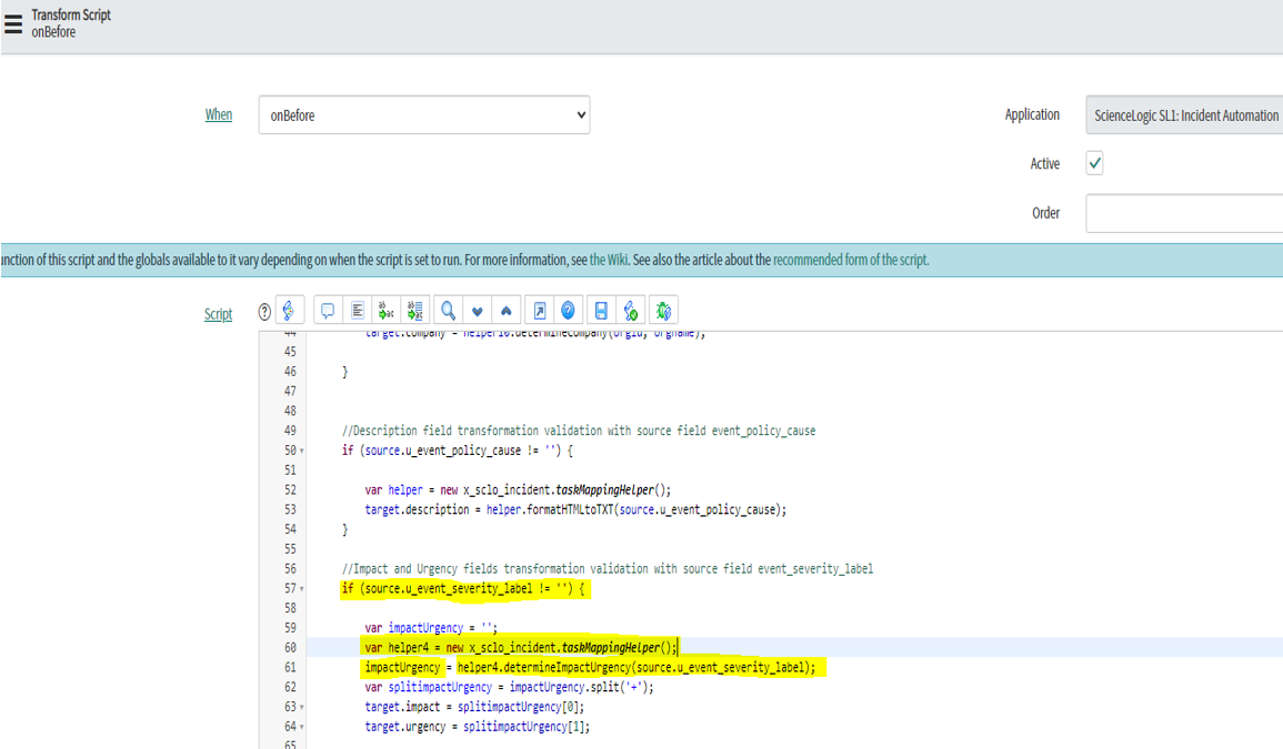

    2. In the "onBefore" transform script under the "ScienceLogic (Skylar One) Incident" transform map:
    • Modify line 60 to call the newly created script include.
    • Modify line 61 to call the newly created function under script include with the same parameter source.u_event_severity_label.
      For example:

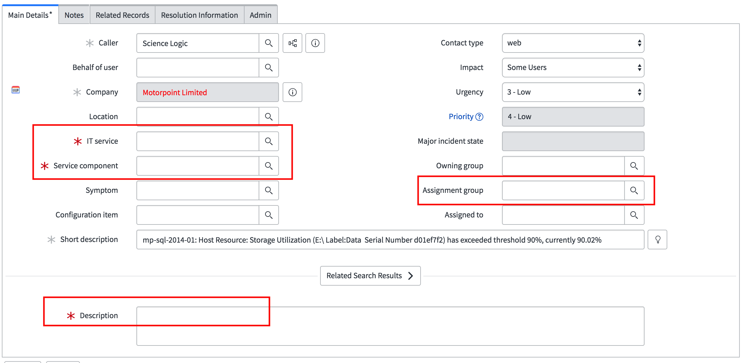

    If you require additional mandatory fields to be filled out to resolve an incident, you can add those fields to the transform map in ServiceNow.
    For example, if you require four mandatory fields in the ServiceNow Incident—Assignment Group, IT Service, Service Component, and Description—to be filled out before that incident can be resolved in Skylar One, you would perform the following steps.
    To add an assignment group:
    1. Navigate to User Administration > Groups and select the assignment group you want to add. The Group record appears.
    2. Right-click the gray task bar at the top and select Copy sys_id.
    1. In Skylar One, open to the "ServiceNow: Add/Update/Clear Incident" Run Book Action (Registry > Run Book > Actions).
    2. Edit the Input Parameters of the Run Book Action to add the sys_id to the relevant parameter or parameters to assign the assignment group to one of the new, acknowledged, or cleared incidents that are mapped. After an incident is created, the assignment group value will not be changed by the Run Book Action.
    The IT Service, Service Component, and Description fields in our example must be filled in before an Incident can be closed. To do this, changes must be made in the transform maps that are provided in the form of update sets from ScienceLogic.

    To add the Description field:

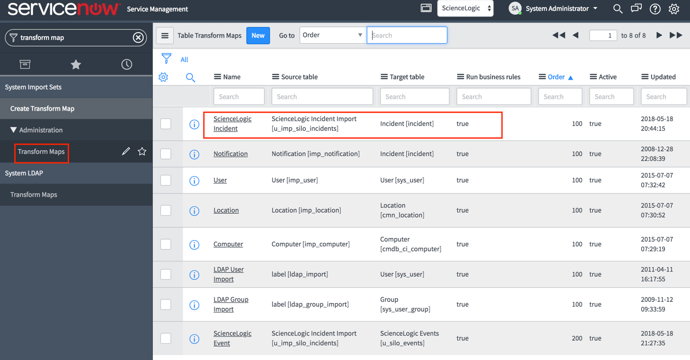

    1. In ServiceNow, search for "transform map" in the filter navigator. Click Transform Maps.
    2. In the list of transform maps, search for "ScienceLogic" in the field above the Name column.
    1. Open the "ScienceLogic Incident" map:
    1. The Field Maps table at the bottom of the page allows you to edit or create mappings from the ScienceLogic Incident Import table to the ServiceNow Incident table. Click New to create a new field mapping.
    2. The Source table field should contain the ScienceLogic Incident Import and the Target table should include the ServiceNow Incident table:
    1. To create a new mapping to copy the contents of the Short description field to the Description field, select Short description from the Source field drop-down menu.
    2. In the Target field drop-down menu, select Description.
    3. Click Update to save your changes.

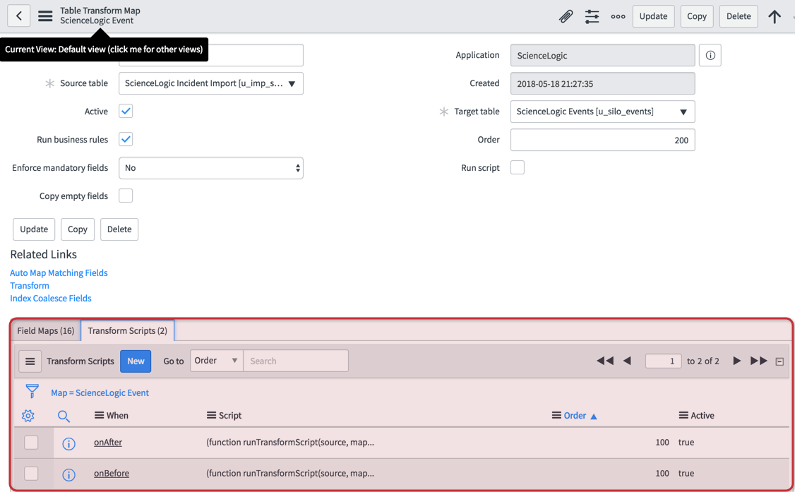

    The IT Service and Service Component fields in our example are set in the Transform Script in the "ScienceLogic Event" transform map. To set the fields:
    1. In ServiceNow, make sure you have the sys_id value for the target fields. If a field contains a magnifying glass, it will require a sys_id. If a field has a drop-down, type in the field you wish to apply from the drop-down. In the case of our example, the sys_id values of the two fields are required.
    2. In your ServiceNow instance, navigate to the Transform Maps table and select "ScienceLogic Event".
    1. In the ScienceLogic Event transform map page, click the Transform Script tab and open the "onAfter" script.
    1. Add the following under the "//Update target record when the Event was cleared from Sciencelogic" text:
    sl_INT.(target field) = '[sys_id of the source field]'; //(IT service field)
    sl_INT.(target field) = '[sys_id of the source field]'; //(Service component)
    1. To find the target field, make a temporary mapping to see what the target field is. This mapping can be deleted once you know the target field.
    1. Click Update to save your changes. The selected fields will be added into an Incident on closure.
