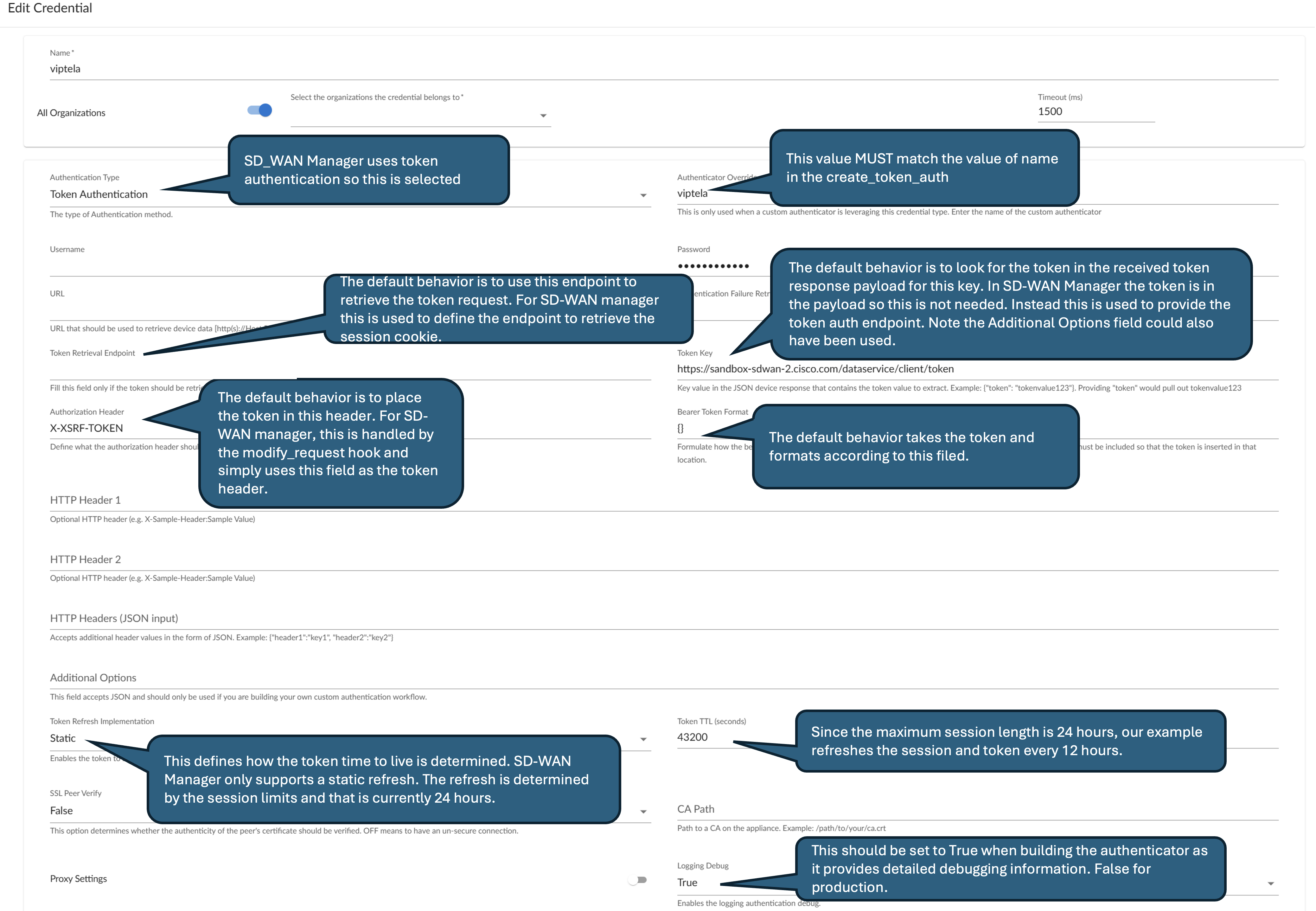

    in this example the credential token_field is not needed since the only thing the payload contains is the token and thus this field is used to contain the url of the token auth endpoint. To retrieve the token an additional request is generated with the JSESSIONID cookie and sent to the token auth endpoint.

The third hook is mapped to the modify_request function. Its job is to insert the JSESSIONID and the token into API requests. The modify_request hook is called for every API request while the first two hooks are only called when the session/token are refreshed (in this example every 12 hours). This hook performs the following:
  1. It adds the cookie JSEESIONID to the session. In this case the token includes both the JSESSIONID and the token so split is used to separate the two.
  2. Next it checks to see if an actual token exists and if so it sets the token in the header specified in the credential.
Is should be noted that auth_info includes the token (which was set in the previous hook) and the token_label which is retrieved from the credential.

Credential
../../../../_images/cisco-sd-wan-cred.png
