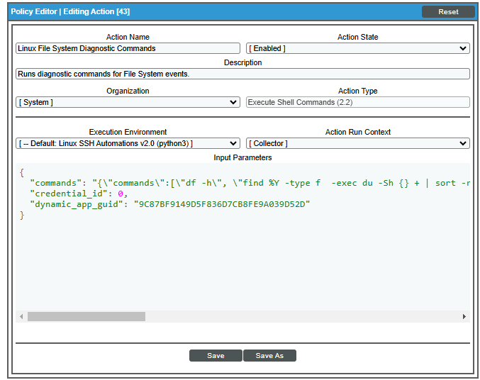

Creating a Custom Run Book Action Policy
You can use the "Execute Shell Commands" action type included with the "Linux SSH Automations" PowerPack to create custom run book actions that you can then use to build custom automation policies.
To create a custom action policy using the "Execute Shell Commands (2.2)" action type:
  2. Click the Create button. The Action Editor page appears.
  3. In the Action Policy Editor page, supply a value in each field.
  • Action State. Specifies whether the policy can be executed by an automation policy (Enabled) or cannot be executed (Disabled).
  • Action Type. Type of action that will be executed. Select the "Execute Shell Commands (2.2)" action type.
  • Input Parameters. A JSON structure that specifies each input parameter. Each parameter definition includes its name, data type, and whether the input is optional or required for this Custom Action Type. For more information about the input parameter fields, see the table in Creating a Linux SSH Run Book Action.
  1. Click [Save]. If you are modifying an existing action policy, click Save As. Supply a new value in the Action Name field, and save the current action policy, including any edits, as a new policy.
You can create a new run book action that runs SSH commands using the "Execute Shell Commands" custom action type. To do this, select "Execute Shell Commands (2.2)" in the Action Type drop-down list when you create a new run book action.
You can also use the existing run book actions in this PowerPack as a template by using the [Save As] option.
The Linux SSH run book actions accept the following parameters in JSON:
commands
string
Specifies a single command or a list of commands, in JSON format, to execute. You can use substitution variables in the commands.
Example:
"commands": "{\"commands\":[\"top -b -n 1\",\"ps -eo pid,ppid,%cpu,%mem,args --sort=-%cpu | head\",\"pidstat\",\"iostat -x 2 5\",\"dmesg | tail\"]}",
ScienceLogic recommends that you make a copy of a run book action with the "Save As" button, and then rename the copy if you are modifying the list of commands in an existing run book action.
credential_id
integer
Default value: 0
Specifies the credential_id to use for the connection.
  • If set to "credential_id": 0 (false), the custom action type will dynamically determine the credential from specific "Linux Base Pack" Dynamic Applications that are aligned to the device. For more information, see Configuring Device Credentials.
  • If set to an ID number, it maps to the credential ID specified. You can find credential IDs by going to the Credentials page (Manage > Credentials).
    Example: "credential_id": 11
dynamic_app_guid
string
Default value: The default value for this parameter corresponds to the globally unique ID number (GUID) value in the "Linux: Configuration Discovery" Dynamic Application.
Specifies the GUID assigned to the Dynamic Application by Skylar One. You can specify multiple Dynamic Application IDs, separated by commas.
If the credential_id parameter is not specified, Skylar One will use the dynamic_app_guid parameter to determine the credential. If this value is not specified, or if it is an empty string, Skylar One runs a query against the database to get the credential details.
