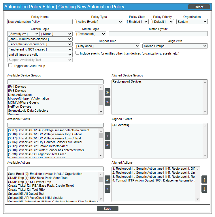

  1. Click Create. The Automation Policy Editor page appears.
    An image of the Creating New Automation Policy page.
  1. Complete the following required fields:
    • Organization. Select one or more organizations to associate with the automation policy. The automation policy will execute only for devices in the selected organizations (that also match the other criteria in the policy). To configure a policy to execute for all organizations , select System without specifying individual devices to align to.
    • Align With. Select Device Groups.
    • Aligned Device Groups. The "Restorepoint Devices" device group needs to be aligned. To add the device group to the Aligned Device Groups field, select the "Restorepoint Devices" device group in the Available Device Groups field and click the right arrow (>>).
    • Aligned Actions. This field includes the actions from the Skylar Compliance AutomationPowerPack. To add an action to the Aligned Actions field, select the action in the Available Actions field and click the right arrow (>>). To re-order the actions in the Aligned Actions field, select an action and use the up arrow or down arrow buttons to change that action's position in the sequence.

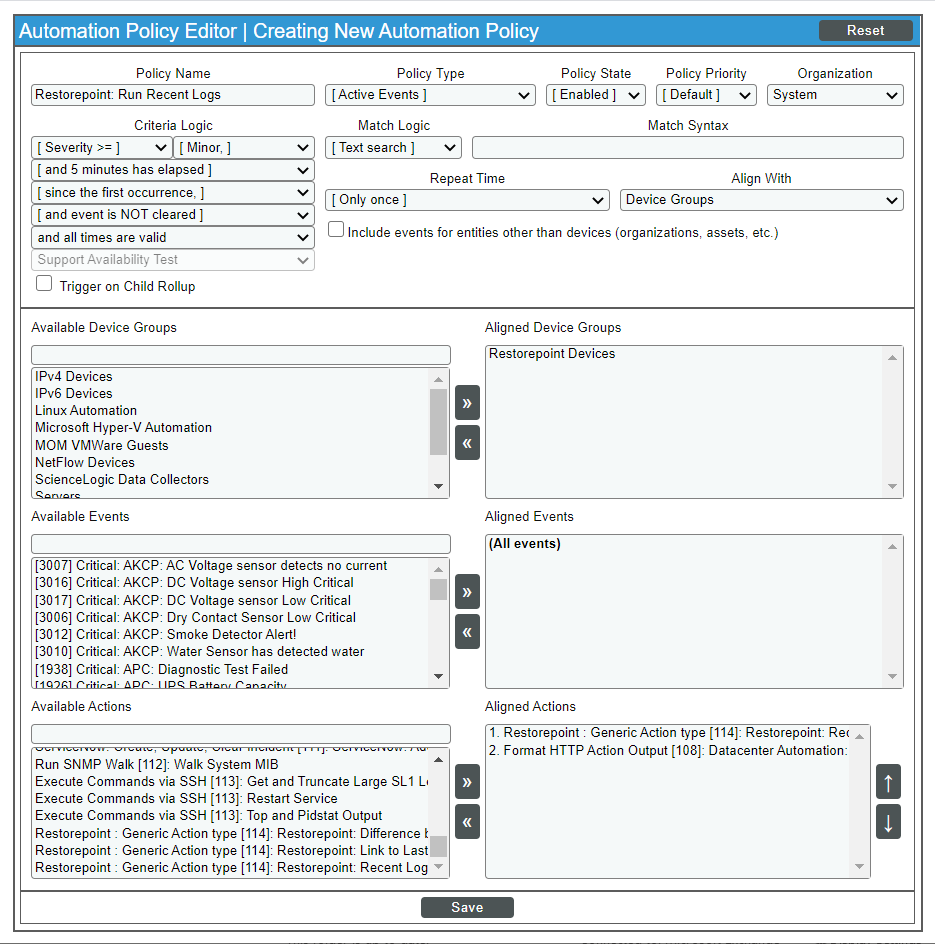

The following is an example of an automation policy that uses the automation actions in the "Skylar Compliance Automation" PowerPack:
An image of the Automation Policy Editor page.
The policy uses the following settings:
  • Policy Name. The policy is named "Restorepoint: Run Recent Logs".
  • Policy Type. The policy runs when an event is in an active state. Active Events is selected in this field.
  • Policy State. Enabled is selected in this field. This policy is active and ready to use.
  • Organization. The policy executes for the System organization.
  • Criteria Logic. The policy is configured to execute immediately when an event matches these criteria: "Severity >= Notice, and no time has elapsed since the first occurrence, and event is NOT cleared, and all times are valid".
  • Aligned With. The policy is configured to align with devices in the selected device group.
  • Aligned Device Groups. The policy is configured to trigger for devices in the "Restorepoint Devices" device group.
  • Aligned Events. The policy is configured to trigger for All events.
  • Aligned Actions. The automation includes the following actions. This action allows you to view the output of the diagnostic commands in the Automation Log, accessed through the Skylar OneEvents page:
    • Restorepoint: Generic Action type [114]: Restorepoint: Recent Logs
    • Format HTTP Action Output [108]: Datacenter Automation: Format JSON as simple HTML

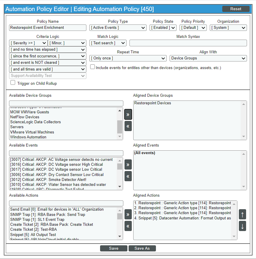

  1. Search for the Skylar Compliance Automation automation policy you want to edit and click the wrench icon (wrench icon) for that policy . The Automation Policy Editor page appears:
An image of the Editing Automation Policy page.
  1. Complete the following fields as needed:
  • Policy Name. Type a new name for the automation policy to avoid overwriting the default policy.
  • Organization. Select the organization that will use this policy.
  • Aligned Actions. This field includes the actions from the Skylar Compliance Automation  PowerPack. You should see "Restorepoint" actions in this field. To add an action to the Aligned Actions field, select the action in the Available Actions field and click the right arrow (>>). To re-order the actions in the Aligned Actions field, select an action and use the up arrow or down arrow buttons to change that action's position in the sequence.
    You must have two Aligned Actions: one that runs the diagnostic or remediation commands and one that provides the output format. The actions providing the output formats are contained in the "Datacenter Automation Utilities" PowerPack, which is a prerequisite for running Restorepoint automations.
    If you are selecting the "Difference Between Last Two Logs" or the "Restorepoint Recent Logs" collection actions, you may want to include the "Format Output as HTML" automation action, found in the "Datacenter Automation Utilities" PowerPack, in your automation policy.
  1. Optionally, supply values in the other fields on the Automation Policy Editor page to refine when the automation will trigger.
  1. Click Save As.
