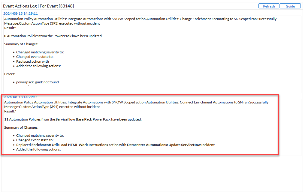

This automation policy modifies the policies in the target Automation PowerPack in the following ways:
  1. In all run book automation policies in the target PowerPack, this policy uses "Automation Utilities: Change Enrichment Formatting to SN Scoped" run book action to replace all instances of the "Datacenter Automation: Format Output as HTML" run book action with the "Datacenter Automation: Format Output for ServiceNow Scoped" run book action. This run book action prepares the output to be used in the enrichment of a ServiceNow incident.
  2. In all automation policies in the target PowerPack, the "Automation Utilities: Connect Enrichment Automations to SN" run book action replaces instances of the "Enrichment: Util: Load HTML Work Instructions" run book action with the "Datacenter Automations: Update ServiceNow Incident" run book action.
  3. For both run book actions, you will need to add the PowerPack ID to the run book action.

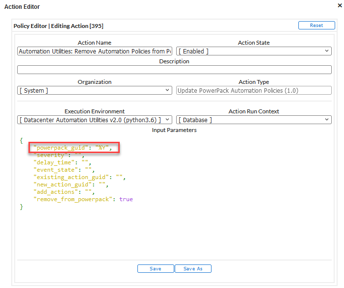

Adding the PowerPack Global ID ("guid") to the Run Book Action
To use these automation policies, you will need to locate the global ID ("guid") of the Automation PowerPack you want to update. You then add the "guid" to the run book actions used by the automation policies so that Skylar One knows which PowerPack to update.
These instructions are for both of the following run book automation policies:
  • Automation Utilities: Integrate Automations with SNOW Scoped
  • Automation Utilities: Remove Automation Policies from PowerPack
To locate and add the PowerPack ID to the run book actions:

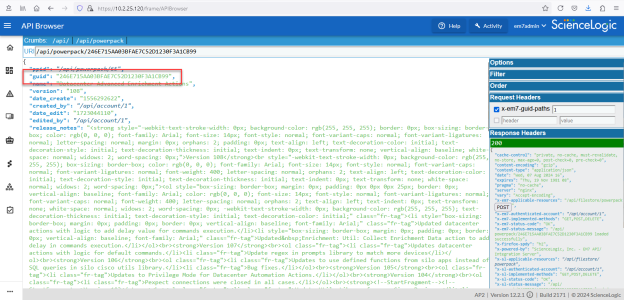

  1. In Skylar One, go to the API Browser page (System > Tools > API Browser).
  2. Update the URI field so it displays /api/powerpack, and then press Enter. A list of the installed PowerPacks appears.
  3. Search for the PowerPack you want to update and click the "URI" value for that PowerPack. The detail page for that PowerPack appears:
  4. Copy the value that displays in the "guid" row.
  5. Go to the Actions page (Registry > Run Book > Actions) and open the corresponding run book action or actions for that automation policy. The Action Editor modal appears:
  6. Paste the "guid" value from step 4 into the "powerpack_guid": "%Y", parameter in the Input Parameters section, replacing the %Y with the "guid" value.
    For example: "powerpack_guid": "246E715AA03BFAE7C52D1230F3A1CB99",
    Other than modifying the target PowerPack "guid", you should not customize the run book actions in the "Datacenter Automation Utilities" PowerPack.
  7. Click Save and continue with the next procedure to test the automation policy.

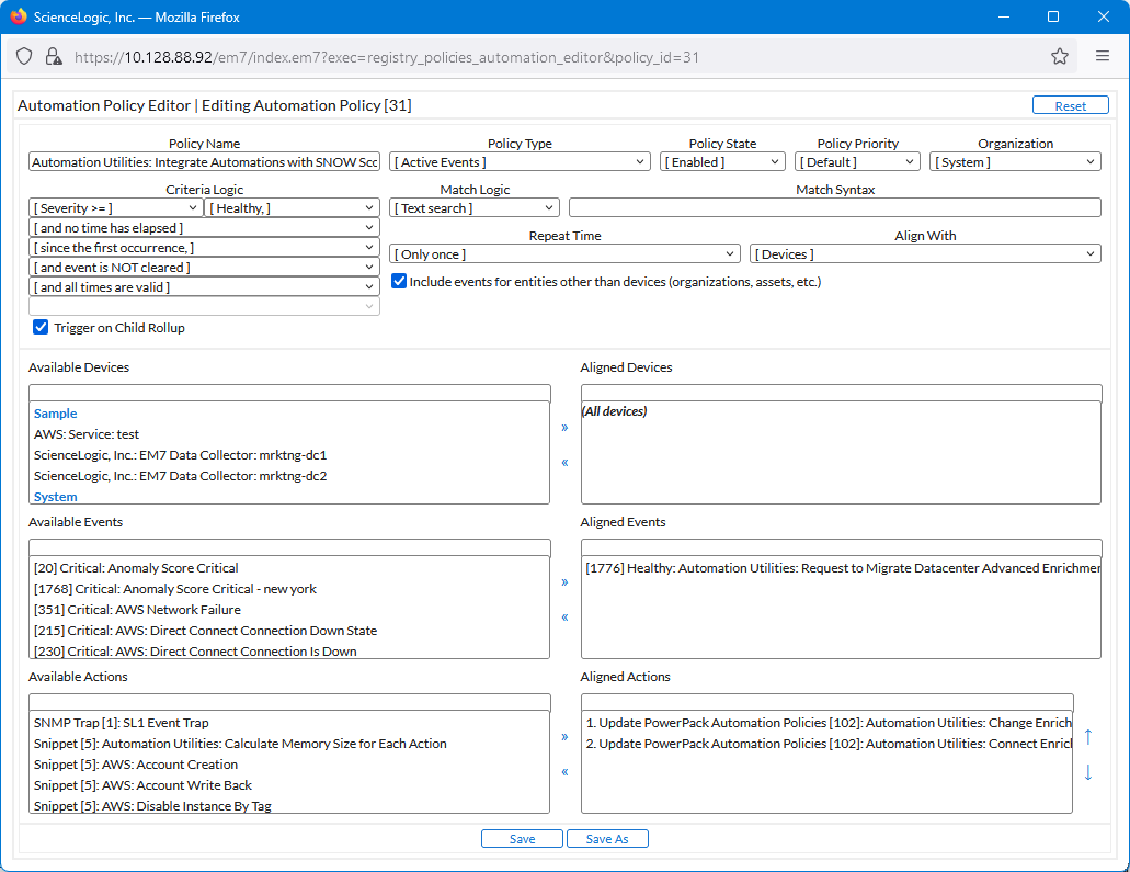

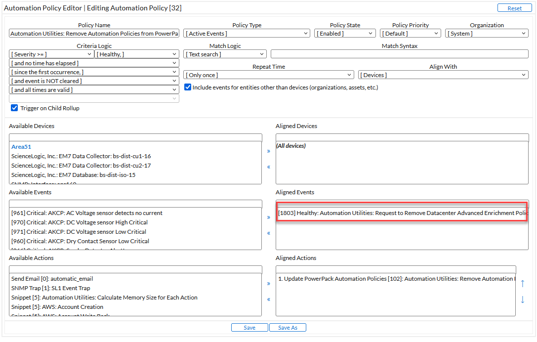

  1. In Skylar One, go to the Automation page (Registry > Run Book > Automation) and open the run book automation policy that you want to run. The Automation Policy Editor page appears:
  2. In the Aligned Events section, make a note of the aligned event. In this example, the aligned event is "Automation Utilities: Request to Remove Datacenter Advanced Enrichment Policies from PowerPack".

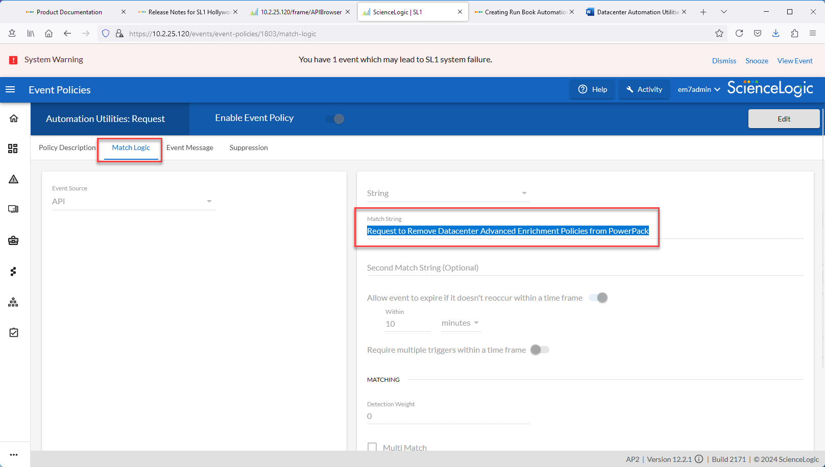

  3. Go to the Event Policies page (Events > Event Policies) and open the event policy from step 2.
  4. On the Match Logic tab, copy the value from the Match String field:

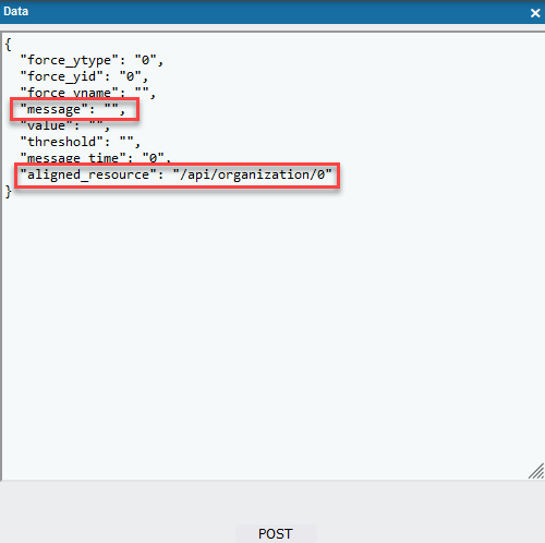

  5. Next, you will POST an alert with the event’s Match String to kick off the automation. Go to the API Browser page (System > Tools > API Browser) and update the URI field so it displays /api/alert.
  6. Scroll down to the Actions section on the right and click POST. A Data modal appears.
  7. Paste the Match String from step 4 into the "message" parameter.
    For example: "message": "Request to Remove Datacenter Advanced Enrichment Policies from PowerPack",
  8. Type /api/device/<target_device_id> in the "aligned_resource" field, where <target_device_id> is the device ID for the target device. The device ID displays in the ID column on the Devices page.
    For example: "aligned_resource": "/api/device/1"
  9. Click POST to kick off the automation.
  10. You can view the event generated by the automation on the Events page () or the Classic Events page (Events > Classic Events).
  11. If a wrench icon () appears in the Automated Actions column on the Events page, you can click the Actions button (actions icon) and select View Automation Actions to see more information about the automation that just ran. The Event Actions Log modal appears for that event:

  2. Click the Create button to create an automation policy, or search for an existing automation policy that you want to edit and click the wrench icon (wrench icon) for that policy . The Automation Policy Editor page appears.
  3. Complete the following fields as needed:
  • Policy Name. Type a new name for the automation policy to avoid overwriting the default policy.
  • Organization. Select the organization that will use this policy. You must use System for the organization for all policies in this PowerPack. The automation policy will execute for all devices regardless of their specific organization.
  • Aligned Actions (bottom right). To create a valid automation policy that uses the run book actions in this PowerPack or one of the "Datacenter Advanced Enrichment" or "Automation Policy" PowerPacks, you must configure the Aligned Actions field on this page to include multiple actions in a specific sequence. To add an action to the Aligned Actions field, select the action in the Available Actions field and click the right arrow (>>). To re-order the actions in the Aligned Actions field, select an action and use the up arrow or down arrow buttons to change that action's position in the sequence.
