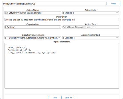

Each run book action has the following parameters in the Input Parameters field in the Action Policy Editor modal:
  • num_lines. Specifies the number of log lines to retrieve from the logs. The combined total of log lines across all log files in one action is limited to 120 lines before the response output begins to be truncated. As a result, if you use the log_files parameter to specify multiple log files in one action and you try to get more lines from each than is supported, you might see the outputs for each log file get truncated. If you need more lines from a specific log file, you can create a new run book action that specifies only that log file to get the maximum 120 log lines.
  • credential_id. Lets you align a specific SOAP/XML credential or Universal Credential on the Skylar One stack with this run book action. You can find the credential ID on the Credentials page (Manage > Credentials), in the ID column. The default value of this field is 0. If you want the action to get credential information from the "VMware: Inventory Cache" Dynamic Application aligned to the device, leave the value as 0.
  • log_files. Specifies the log files you want to collect.
The following run book actions that use the "Get VMware Diagnostic Logs" action type are included in the "VMware Automation" PowerPack. Compare the commands run with the example in the image above. For more information about input parameter fields, see the table in Creating a VMware Run Book Action.
You can create a new run book action that collects certain logs using the "Get VMware Diagnostic Logs" custom action type. You can also use one of the existing run book actions in the PowerPack as a template by using the Save As option.
To create a custom run book action using the "Get VMware Diagnostic Logs" action type:
  • Navigate to the Action Policy Manager page (Registry > Run Book > Actions).

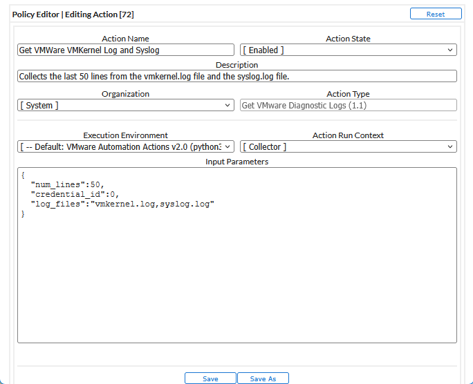

  • In the Action Policy Manager page, click the Create button. The Action Policy Editor modal appears:
  • In the Action Policy Editor page, supply a value in each field.
  • Action Type. Type of action that will be executed. Select the "Get VMware Diagnostic Logs" action type.
  • Input Parameters. A JSON structure that specifies each input parameter. Each parameter definition includes its name, data type, and whether the input is optional or required for this Custom Action Type. In the example shown above, the run book action policy request the last 50 lines of the logs from vCenter. Input parameters must be defined as a JSON structure, even if only one parameter is defined.
