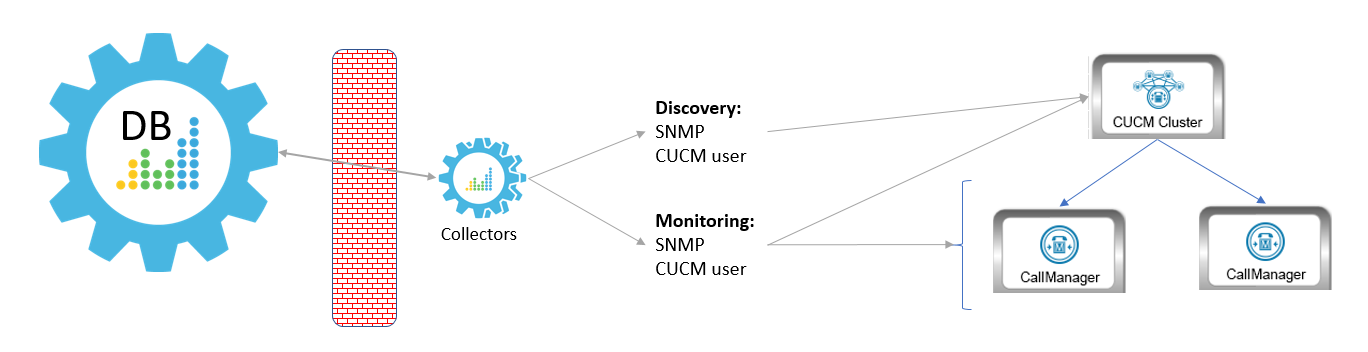

Method 1
In the first scenario, the Data Collector sits in front of the firewall and you define the CallManagers by hostname:
In this scenario, you must have the following ports open for the firewall:
Direction Port Protocol
ScienceLogic Database Server to the Data Collector 7707 TCP
PhoneHome Collector to the Database Server 7705 TCP

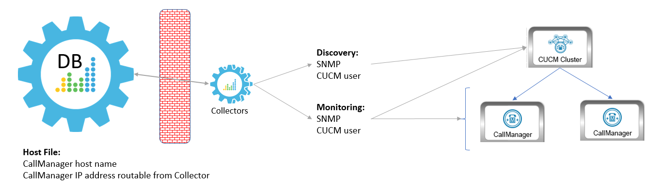

Method 2
In the second scenario, the Data Collector sits in front of the firewall and you define the CallManagers by IP address. This method requires you to create a host file that includes the CallManager hostname and IP address:

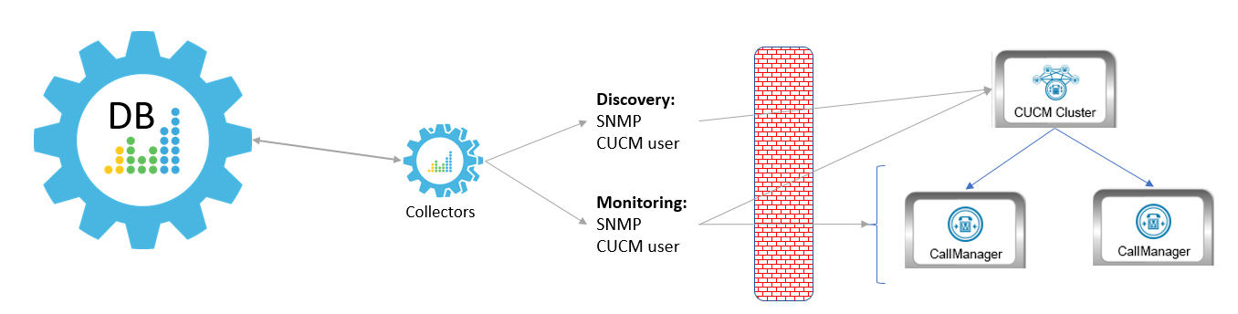

Method 3
In the third scenario, the Data Collector sits behind the firewall and you define the CallManagers by hostname:
Direction Credential Port Protocol
ScienceLogic Data Collector to the Cisco Unified CM Cluster and CallManagers SNMP 161 UDP
Cisco Unified CM user 8443 TCP

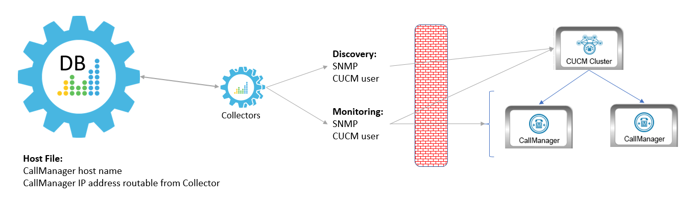

Method 4
In the fourth scenario, the Data Collector sits behind the firewall and you define the CallManagers by hostname, with NAT. This method requires you to create a host file that includes the CallManager hostname and the IP address the Data Collector can use to access the device:

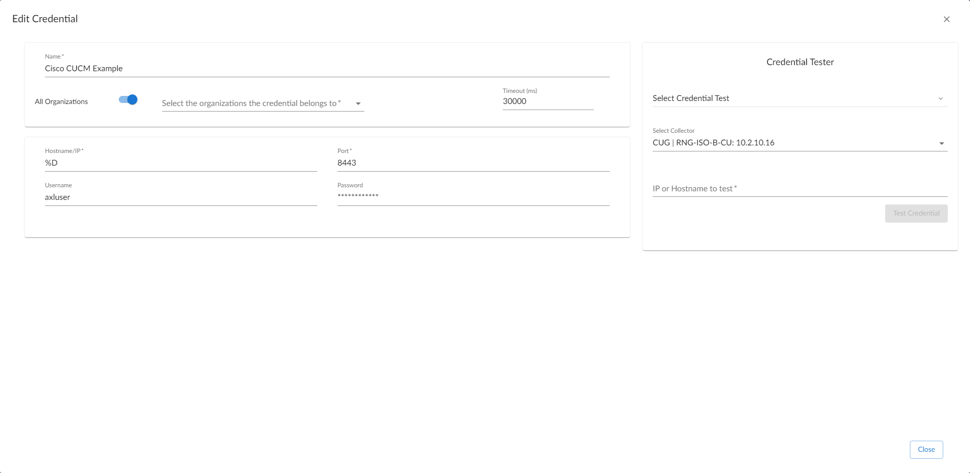

Creating a CUCM Credential
To use the Dynamic Applications in the "Cisco: CUCM Unified Communications Manager" PowerPack, you must first define a Basic/Snippet Cisco Unified CM credential in Skylar One. This credential allows Skylar One to communicate with the Cisco Unified CM cluster. The "Cisco: CUCM Unified Communications Manager" PowerPack includes a template you can use to create this Basic/Snippet credential.
To modify the Cisco Unified CM Basic/Snippet Credential template for use with your Cisco Unified CM cluster:
  2. Locate the "Cisco CUCM Example" sample credential. Click its Actions icon (actions icon) and select Duplicate. A copy of the credential, called Cisco CUCM Example copy appears.
  3. Click the Actions icon (actions icon) for the Cisco CUCM Example copy credential and select Edit. The Edit Credential page appears:
An image of the VMware Create Credential page.
  • Timeout (ms). Type the timeout value of each request, in milliseconds. The default value is "30000".
  • Hostname/IP.  Type the hostname or IP address, or you can type the variable "%D".
  • Port.  Type the port number.
The example credential included in older versions of the "Cisco: CUCM Unified Communications Manager" PowerPack used "80" as the default Port number. If your Cisco Unified CM credential specifies port 80, Skylar One will automatically override that value and use port 8443 instead. If your Cisco Unified CM credential specifies any port other than 80, Skylar One will use that specified port.
  • Username. Type the username for the Cisco Unified CM user account that you created to access the AXL web service. For details, see the Configuring a Cisco Unified CM User Account section.
  • Password. Type the password for the username you entered in the Username field.
