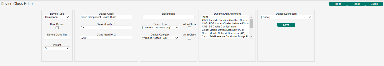

Assigning a Device Class to a Discovered Device
As of version 111 of the "Cisco: Meraki [API]" PowerPack, the device's model name is split into two parts when Skylar One assigns a device class:
  • The first two characters of the model name are assigned to the Class Identifier 1 component identifier on the Class Identifier collection object. If the Cisco: Meraki device's model name starts with a "v", the next two characters after the "v" are assigned to this collection object instead.
  • The rest of the characters in the model name are assigned to the Class Identifier 2 component identifier on the Class Identifier 2 collection object.
Skylar One will assign a device class based on the information in the Class Identifier 1 and 2 fields:
  • If the information in the Class Identifier 1 and 2 fields matches the Class Identifier 1 and 2 of a device class in the PowerPack exactly, that device class is assigned to the device.
  • If the information in the Class Identifier 1 field matches, but no match occurs on the Class Identifier 2 collection object, one of 15 fallback device classes is assigned. The fallback device class matching Class Identifier 1 with the lowest weight will be assigned.
  • If no match occurs in either of the Class Identifier fields, the "Cisco Systems | Meraki Device" default device class is assigned to the device.
This process is standard Skylar One functionality that is documented in the Configuring Collection Objects as Component Identifiers section.

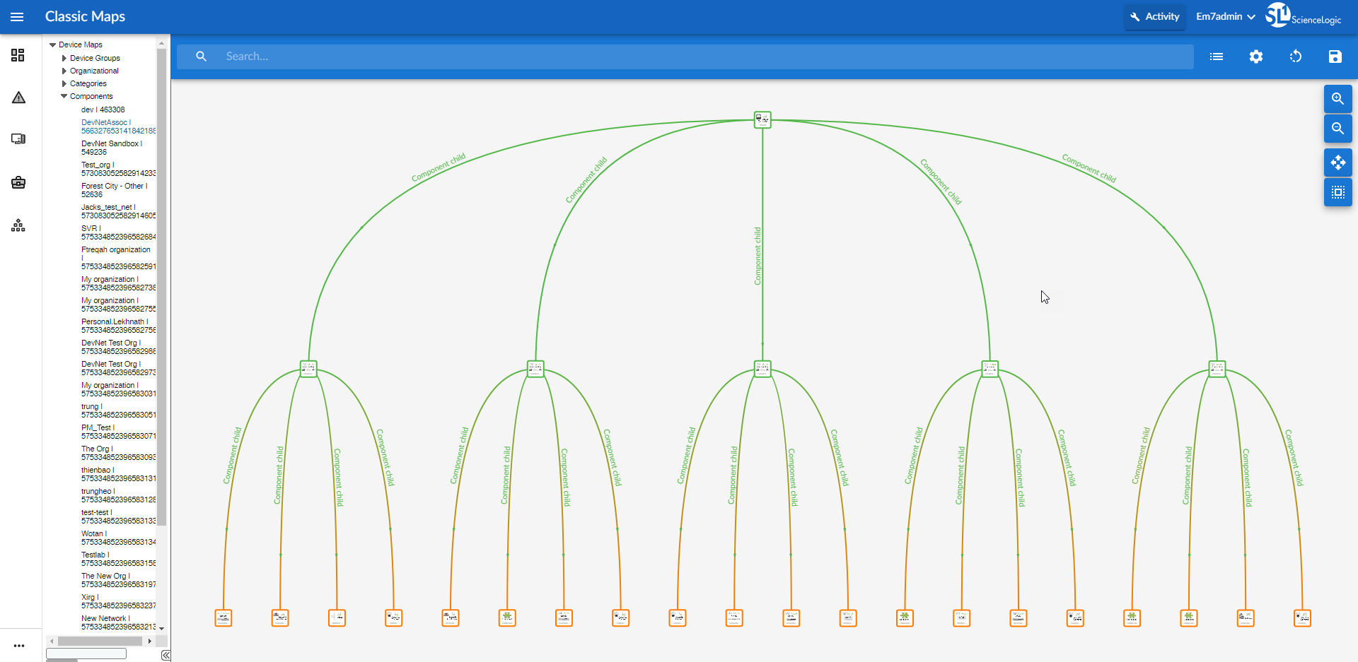

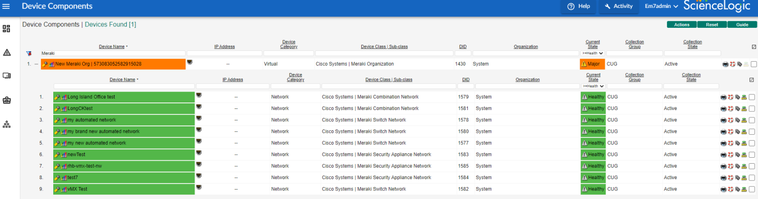

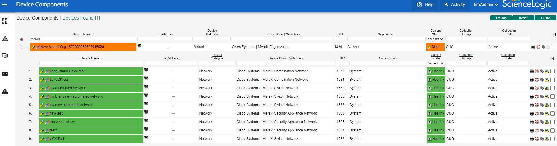

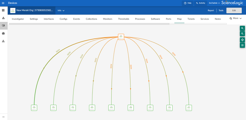

In addition to the Devices page, you can view your Cisco Meraki devices in the following places in the user interface:
  • The Device Components page (Devices > Device Components) displays a list of all root devices and component devices discovered by Skylar One. The Device Components page displays all root devices and component devices in an indented view, so you can easily view the hierarchy and relationships between child devices, parent devices, and root devices. To view the component devices associated with a Cisco Meraki device, find the device and click its plus icon (+).
  • The Component Map page (Classic Maps > Device Maps > Components) allows you to view devices by root node and view the relationships between root nodes, parent components, and child components in a map. This makes it easy to visualize and manage root nodes and their components. Skylar One automatically updates the Component Map as new component devices are discovered. The platform also updates each map with the latest status and event information. To view the map for a Cisco Meraki device, go to the Component Map page and select the map from the list in the left NavBar. To learn more about the Component Map page, see the section on Maps.

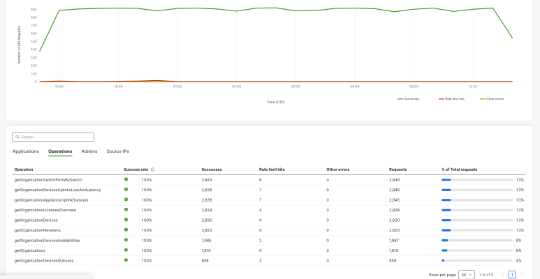

Certain Dynamic Applications can be disabled to save API calls, as indicated in the table below. Others in the "Cisco: Meraki [API]" PowerPack can be enabled or disabled by toggling the specific API calls on either a universal or SOAP/XML credential, which will affect all devices using the credential.
Additionally, Dynamic Applications that are enabled or disabled in the snippet for the Request Manager are toggled globally across all credentials.

Updating the Polling Interval for the Cisco: Meraki Uplink Usage Performance [API] Dynamic Application
The Cisco: Meraki API does not currently expose uplink utilization directly. The "Cisco: Meraki Uplink Usage Performance [API]" Dynamic Application retrieves the limits set for the uplinks, reads the usage data from the "Cisco: Meraki Uplink Performance [API]" Dynamic Application, and then calculates the utilization based on the polling interval and the division of bits over that polling interval into average kbps (kilobits per second). Due to this complex relationship, updating the polling interval of either Dynamic Application can affect the accuracy of the data in those Dynamic Applications.
If you want to adjust the polling interval of the "Cisco: Meraki Uplink Usage Performance [API]" Dynamic Application, you must:

Creating a Custom Component Device Class
The "Cisco: Meraki [API]" PowerPack includes device classes for many Cisco Meraki devices, but you can create custom device classes for devices that do not meet the criteria of the device classes in the PowerPack.
To create a custom component device class:
  1. Go to the Device Class Editor page (System > Customize > Device Classes).
  2. Click [Reset] to clear the fields in the Device Class Editor pane.
  3. Configure the device class as follows:
    • Device Type. Select Component.
    • Device Class. Enter the name of the device class.
    • Class Identifier 1. Enter the first two characters of the model name in lowercase letters. For example, if the model name is "zx-d2", enter "zx".
    • Class Identifier 2. Enter the rest of the characters of the model name in lowercase letters here. Do not begin this field with a "-" character. For example, if the model name is "zx-d2", enter "d2".
    • Device Category. Select the appropriate category from the drop-down list. This field specifies a logical categorization of devices by primary function, which allows Skylar One to group related devices in reports and views.
    • Root Device. Select this checkbox if you will have additional tiers under this component device.
    • Weight. Select a value from the drop-down menu. A lower number should be assigned to a device class with a specific model (for example, c9200-MXPOX). A higher number should be assigned to fallback or catch-all device classes.
    • Description. Enter a description for the device class.
    • Device Icon. Select an icon that you created or a generic icon for the device class.
  4. Click Save to save your changes to the device class.

Receiving 429 Response Codes from the Cisco Meraki API
Cisco Meraki uses rate limiting to define how many API calls an API client can make in a set time frame. They limit API calls per organization, per source IP per organization, and per source IP across organizations, among others. You might receive 429 response codes from the Cisco Meraki API if the rate limit has been exceeded. This is normal behavior, and you do not necessarily need to be concerned if you receive the 429 response code. ScienceLogic recommends referencing the Cisco Meraki dashboard (on their website) to get insight into how many API calls Skylar One and other tools are using, and which endpoints they are hitting.

Meraki Organizations are Not Modeling
In versions 113.5 and 113.6 of the "Cisco: Meraki [API]" PowerPack, there is a known issue that prevents Meraki organizations from being modeled if another device in Skylar One has the same name. If this situation occurs, Skylar One modifies the existing device's name and does not create a new device. To work around this issue:
  1. Run the "Cisco: Meraki Organization Discovery [API]" Dynamic Application in debug mode.
  2. Identify the organization name where the failure is happening by either looking into the logs in the Skylar One user interface or the /tmp/meraki_organization_creation.log file.
  3. Locate the device with the similar name, and change the name of the device if possible.
  4. Once you have changed the name of the device, Skylar One will no longer try to update the existing device and will continue to create a new Meraki device.
