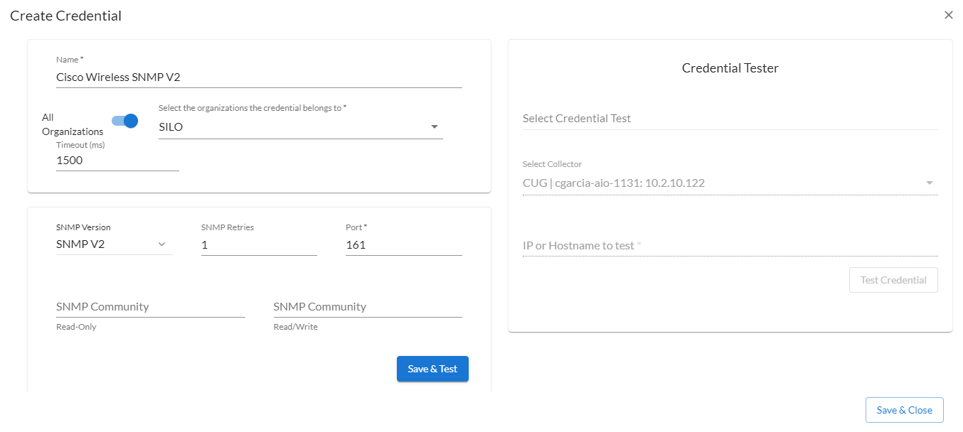

Configuring a Cisco WLC SNMP Credential
To configure Skylar One to monitor a Cisco WLC, you must first create a SNMP V2 or SNMP V3 credential. This credential allows the Dynamic Applications in the "Cisco: Wireless" PowerPack to communicate with the WLC.
To create an SNMP credential for monitoring a WLC:
  1. Go to the Credential Manager page (Manage > Credentials).
  2. Click Create New, and then select SNMP Credential. The Create Credential page appears:
  • SNMP Version. Select SNMP V2 (default) or SNMP V3 for enhanced security.
NOTE: Do not use an SNMP V1 credential for monitoring a WLC. Using an SNMP V1 credential will decrease the performance of the data collection process.
  • If you selected SNMP V2, type the community string for the WLC in the SNMP Community (Read Only) field.
  • If you selected SNMP V3, supply values in the following fields:
  • Security Name. Type the SNMP username for the WLC.
  • Security Passphrase. Type the passphrase for the SNMP user.
  • Authentication Protocol. If applicable, select the authentication protocol for the SNMP user.
  • Security Level. If applicable, select the security level that is applicable to the SNMP user.
  • Engine ID. If applicable, type the SNMP V3 Engine ID for the SNMP user.
  • Context. If applicable, type the SNMP Context.
  • Privacy Protocol. If applicable, select the privacy protocol for the SNMP user.
  • Privacy Protocol Pass Phrase. If applicable, type the privacy protocol passphrase for the SNMP user.
  • Port. Leave this field by default.
  • SNMP Retries. Leave this field by default.

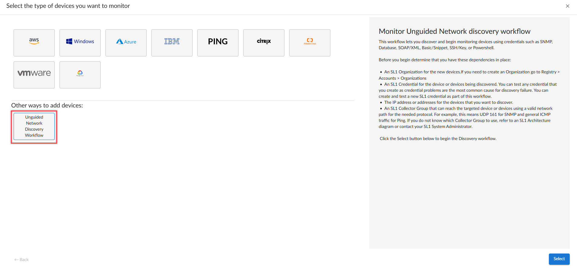

Discovering Cisco WLC Devices
To discover Cisco WLC devices:

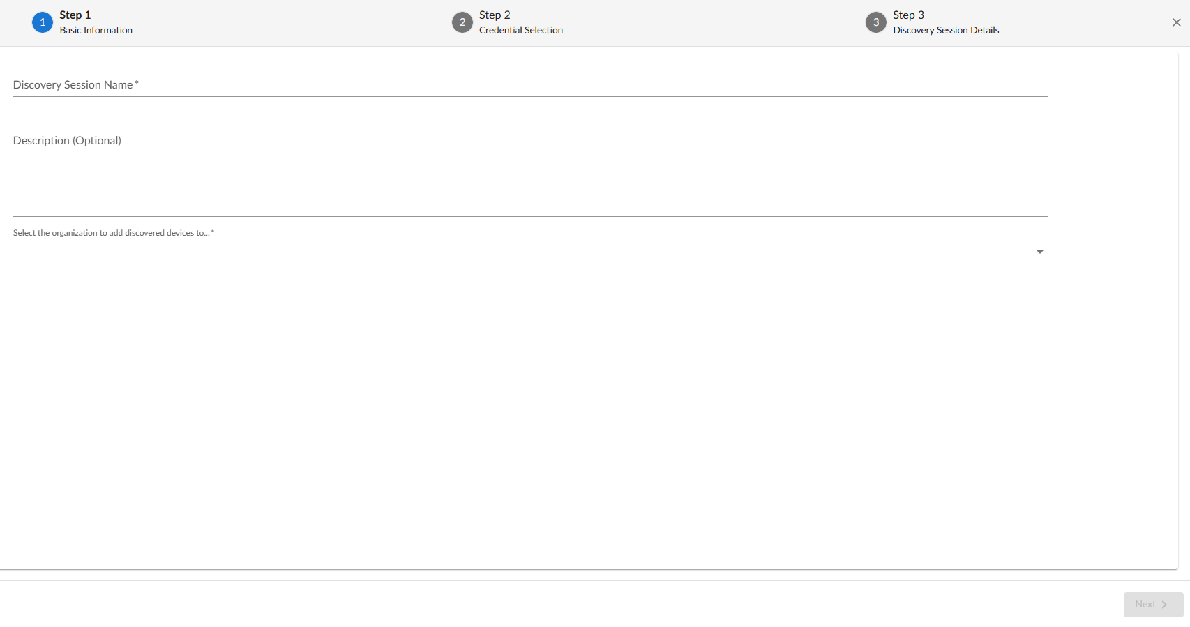

  1. Click the Unguided Network discovery workflow button. Additional information about the requirements for discovery appear in the General Information pane to the right.
  2. Click Select. The Add Devices page appears:

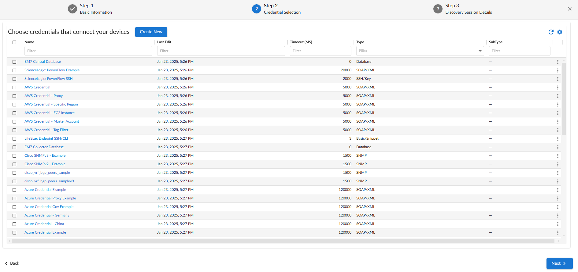

  1. On the Credentials page, locate and select the SNMP credential you created.

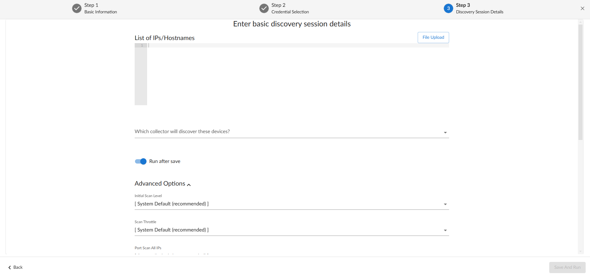

  2. Click Next. The Discovery Session Details page of the Add Devices wizard appears:
  • List of IPs/Hostnames. Type the IP address for the WLC.
  • In the Advanced options section, click the down arrow icon ( ) to complete the following fields:
  1. Click Save and Close to save the discovery session. The Discovery Sessions page (Devices > Discovery Session ) displays the new discovery session.

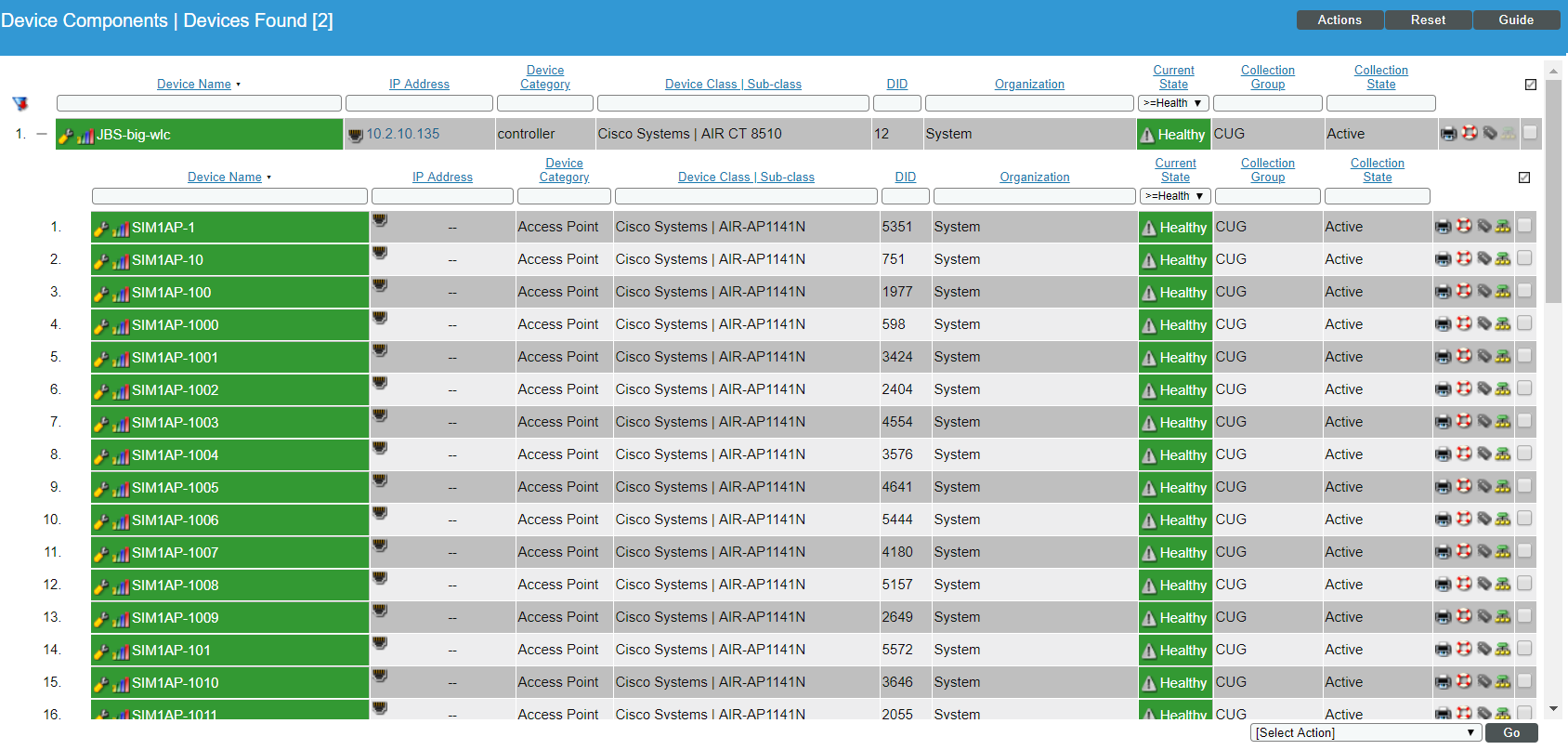

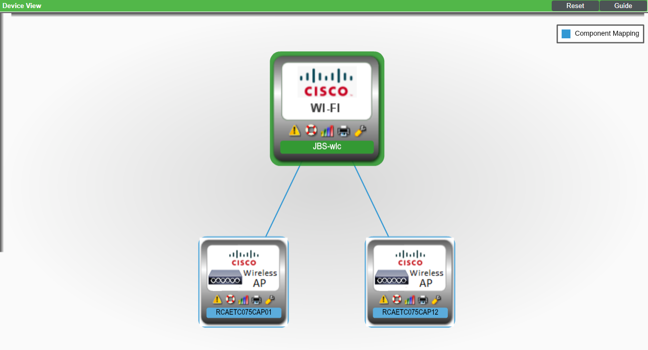

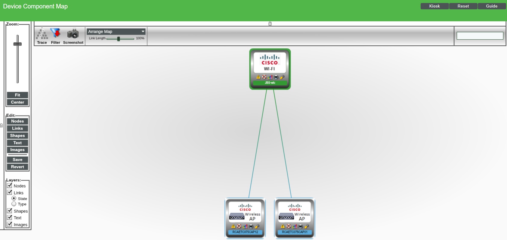

Viewing Cisco WLC Component Devices
In addition to the Device Manager page (Devices > Classic Devices, or Registry > Devices > Device Manager in the classic user interface), you can view the Cisco WLC device and all associated component devices in the following places in the user interface:
  • The Device View page displays a map of a particular device and all of the devices with which it has parent-child relationships. Double-clicking any of the devices listed reloads the page to make the selected device the primary device:
  • The Device Components page (Devices > Device Components) displays a list of all root devices and component devices discovered by Skylar One in an indented view, so you can easily view the hierarchy and relationships between child devices, parent devices, and root devices. To view the component devices associated with a Cisco WLC, click its plus icon (+):
  • The Component Map page (Classic Maps > Device Maps > Components) allows you to view devices by root node and view the relationships between root nodes, parent components, and child components in a map. This makes it easy to visualize and manage root nodes and their components. Skylar One automatically updates the Component Map as new component devices are discovered. The platform also updates each map with the latest status and event information. To view the map for a Cisco WLC, go to the Component Map page and select the map from the list in the left NavBar. To learn more about the Component Map page, see the section on Views.
