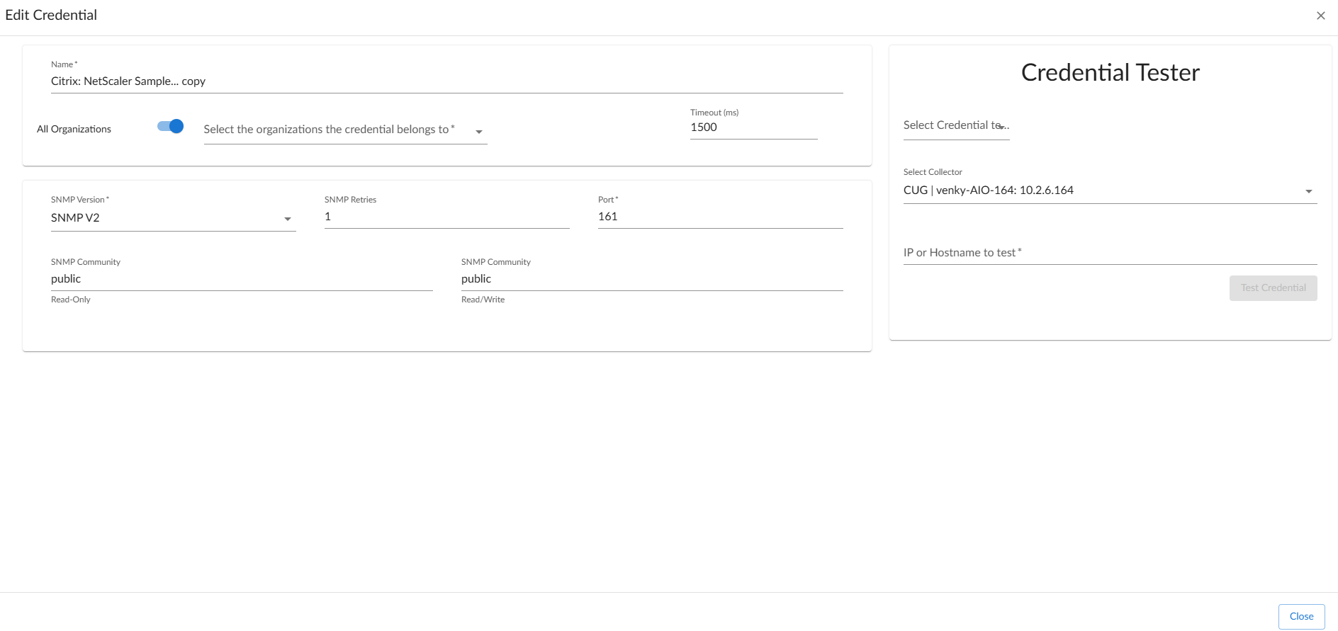

Configuring an SNMP Credential for Citrix: NetScaler ADC
To configure Skylar One to monitor Citrix: NetScaler ADC devices, you must first create a credential. This credential allows the Dynamic Applications in the "Citrix: NetScaler ADC Base Pack" PowerPack to communicate with Citrix: NetScaler devices.The "Citrix: NetScaler ADC Base Pack" PowerPack includes an example SNMP credential that you can edit for your own use.
To create an SNMP credential:
  1. Go to the Credential Management page (Manage > Credentials).
  2. Locate the "Citrix: NetScaler Sample Credential" credential, then click its Actions icon (actions icon). Select Duplicate from the drop-down field. The "Citrix: NetScaler Sample Credential...copy" credential appears.
  3. Click the actions icon (actions icon) for the "Citrix: NetScaler Sample Credential...copy" credential and select Edit. The Edit Credential modal appears.
  4. Edit SNMPv2 credential for Citrix NetScaler ADC Base Pack
  • Name. Type a new name for the credential. This field is required.
  • Timeout. The time, in milliseconds, after which Skylar One will stop trying to communicate with the Isilondevice. The default value is 1500. This field is required.
  • SNMP Version. SNMP version. Choices are SNMP V1, SNMP V2, and SNMP V3. The default value is SNMP V2. This field is required.
  • Retries. Number of times Skylar One will try to authenticate and communicate with the external device. The default value is 1. This field is required.
  1. Click Save & Close.

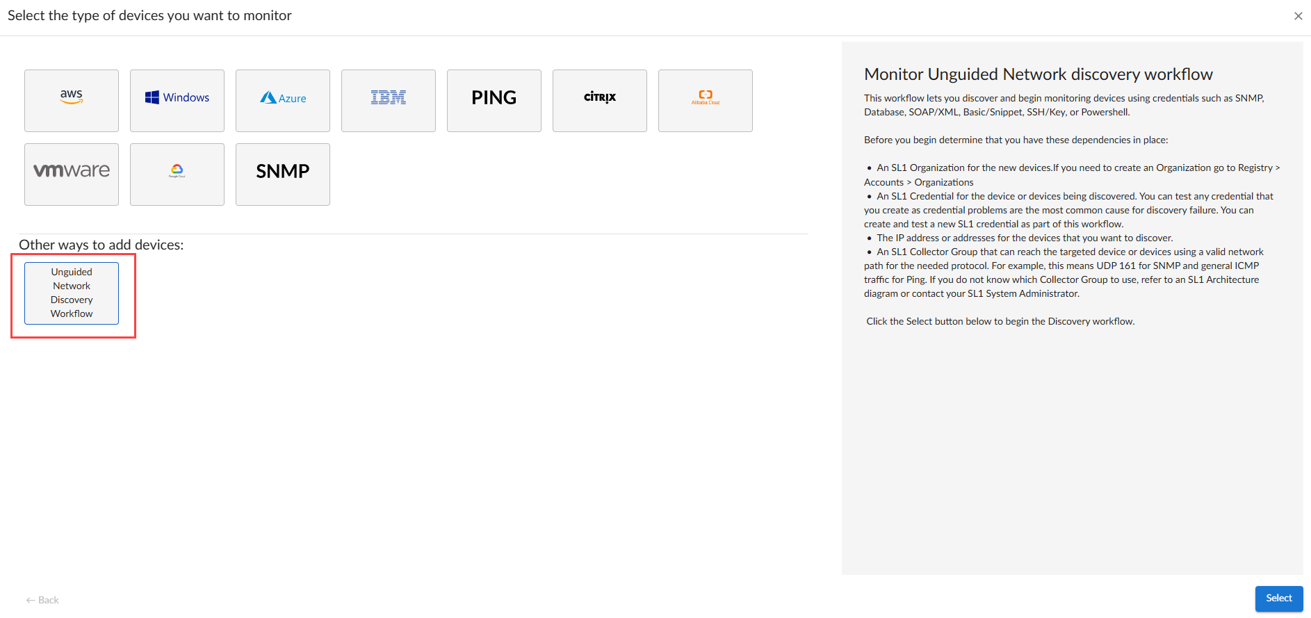

To create and run a discovery session that will discover a Citrix: NetScaler Device:
  4. Click Select. The Basic Information page appears.
  1. Click Next. The Credential Selection page of the Add Devices wizard appears.
  2. On the Credential Selection page, locate and select the SNMP credential you created for NetScaler devices.
  3. Click Next. The Discovery Session Detailspage of the Add Devices wizard appears.
  • List of IP/Hostnames. Type the IP address for the NetScaler device.
    • Select Device Template. If you configured a NetScaler device template, select it here. Otherwise, leave the default selection.
