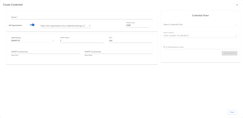

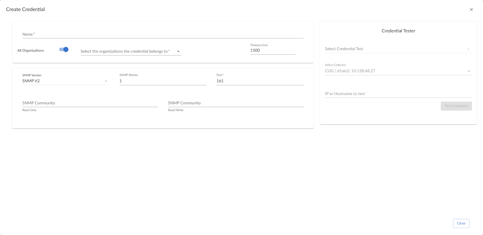

To use the Dynamic Applications in the "F5 BIG-IP" PowerPack, you must first define an SNMP credential in Skylar One. This credential allows Skylar One to communicate with the BIG-IP system.
To configure an SNMP credential for F5 BIG-IP:
  2. Click the Create New button.
  3. In the drop-down list that appears, select Create SNMP Credential. The Credential Editor page appears:
  4. In the SNMP Version field, select SNMP V2.
  5. In the Name field, enter a name for the credential.
  6. In the All Organizations drop-down field, select the organizations the credential belongs to.
  7. In the SNMP Community (Read Only) field, enter the community string for the BIG-IP system.
  8. Optionally, supply values in the other fields in this page. In most cases, you can use the default values for the other fields.
  9. Click the Save & Close button.

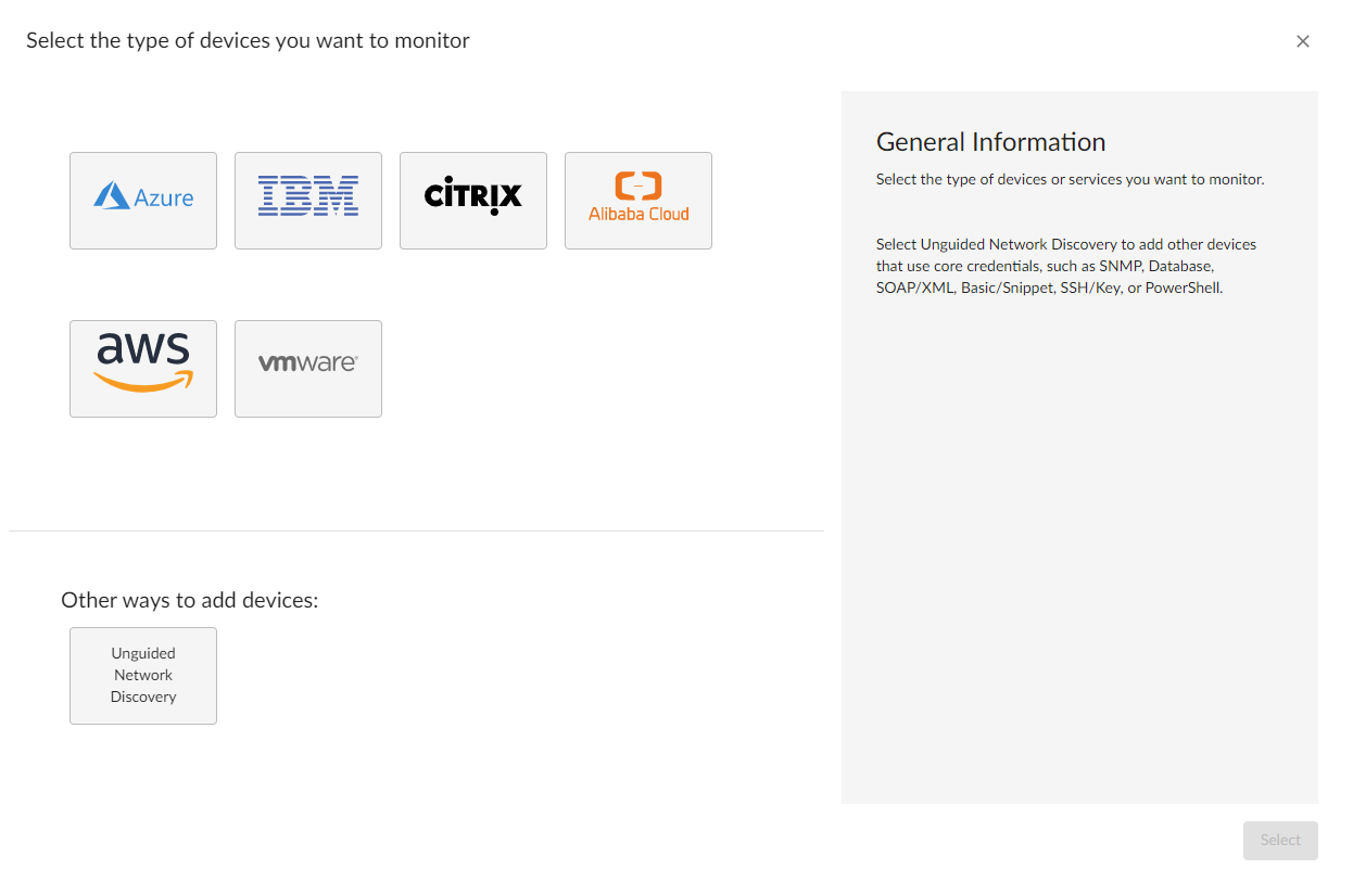

  1. Go to the Discovery Session page (Devices > Discovery Sessions).
  2. Click the Add Devices button to create a new discovery session. You will be redirected to a self-guided service where you can add devices.
  3. Select Unguided Network Discovery, then click the Select button. You will be redirected to a page where you can create and create a Discovery Session that will discover the BIG-IP system and automatically align Dynamic Applications with the BIG-IP system. This is a three-step process.

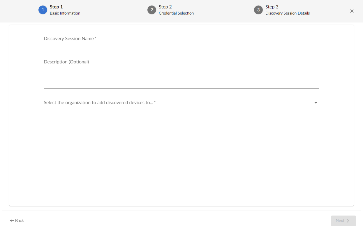

  4. Enter a name for your Discovery Session in the Discovery Session Name field and select an organization from the Select the organization to add discovered devices to drop-down field.
  5. Select the SNMP credential(s) that connected your devices, then click the Next button.
  6. Select an IP or Hostname, then click the Save and Run button. The Discovery Logs window will appear.
  7. When the BIG-IP system is discovered, you can click the device name to view the system device's properties.
