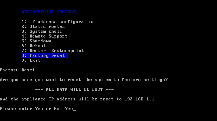

Factory Reset
If you need to reset your Restorepoint appliance to factory settings, you can follow the factory reset procedure. Note that the factory reset will permanently erase ALL of the information stored on the appliance, not just the system settings. In particular:
  • The encryption key will be deleted.
  • All the device data (configuration and backups) will be erased.
  • All the administrators (except admin) will be deleted.
  • All plugins will be deleted.
  • System settings will be reset to their default values.
  • The password for the admin user will be reset to admin.
Note : To reset the appliance, you must have the admin password. If you need to reset Restorepoint and you do not know the admin password, contact Technical Support.
To start the factory reset procedure:
  1. Log in as admin on the Restorepoint console.
  2. Choose the Factory reset option.
  3. Confirm that you understand and accept that your data will be lost and enter Yes, otherwise enter No to abort:
Image of the Restorepoint Agent Console
The system will then erase the database and reset the system settings to their default values. This can take some time, depending on how much data is stored on the appliance. Do not shut down or power off the system before the reset has completed or you may damage the appliance. Restorepoint will automatically shut down at the end of the procedure.
