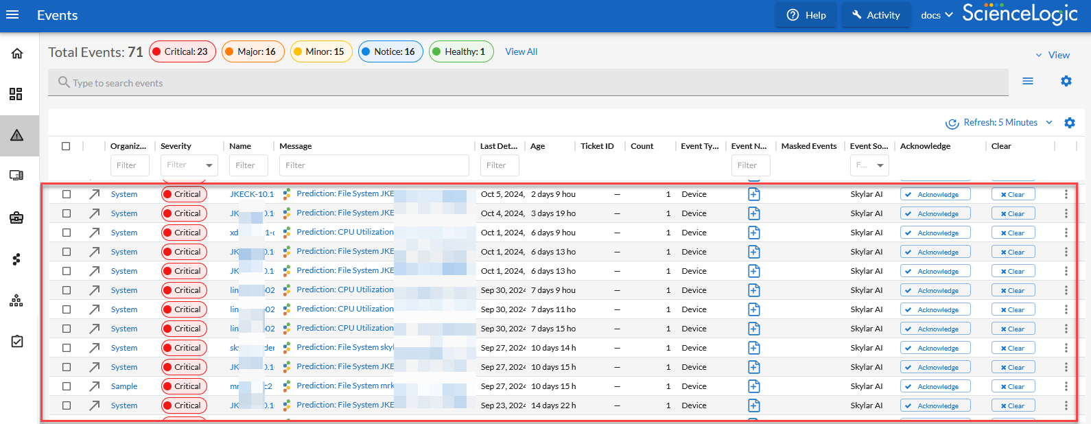

When your Skylar One system is connected to Skylar Analytics, you can start viewing predictive alerts in Skylar One. The alerts appear as enriched events in Skylar One, and they are generated in advance of the problem. No additional configuration is needed.
Predictive alerts display the Skylar icon () to the left of the event message in the Message column of the Events page. The filter text in the Message column and thetext of the message contains the word "Prediction":
Image of the Events page.
The filtered list will appear blank until an active predictive alert triggers an event.
To view details about a predictive alert:
  1. In Skylar One, go to the Skylar AI page () and click the View Predictive Events button for Skylar Predictive Alerting. A filtered Events page displays a list of predictive alerts.
    The word "Prediction" appears in the filter field for the Message column. To clear the list of predictive alerts to view all events, click the X button in the filter.

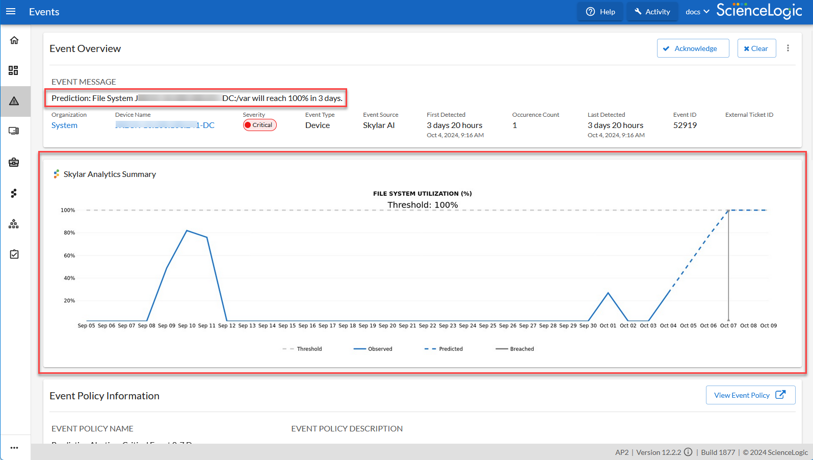

  1. On the Events page, click the message for a predictive alert with the Skylar icon (). The Event Investigator page for that alert appears.
  2. On the Event Investigator page, the Skylar Analytics Summary panel displays a timeline of data from Skylar AI about a specific metric:
    Image of the Event Investigator page with Skylar Analytics.
    The dotted line on the graph in the Skylar Analytics Summary panel represents a time frame in the future that Skylar Analytics is forecasting, based on pattern recognition.
    The blue line represents the activity observed so far by Skylar One, and the gray dotted line represents the threshold set in Skylar One.The blue dotted line represents where Skylar Analytics is predicting a potential alert in the future, with the gray line representing a potential problem in the future, also predicted by Skylar Analytics.
    In the example above, Skylar Analytics predicts that the file system utilization will hit the threshold of 100% in three days, on October 7th. By tracking the timeline on the graph, you can see when a potential event might happen, and you can take action now to prevent it.
    In addition, if you have an event policy monitoring a metric that is now being tracked by Predictive Alerting, you can disable that event policy.
Because the data for the chart on the Skylar Analytics Summary panel is coming from Skylar Analytics, you will not be able to use that data in a Skylar One dashboard. Also, this chart is rendered at prediction time and is static, so that when opening an event, you can see the state and prediction at the time of prediction.

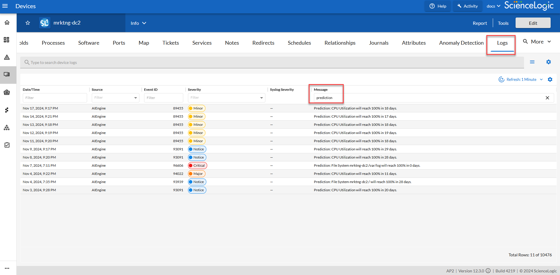

You can also review the logs for a specific device to view the history of the predictions:
  1. On the Devices page or the Events page, select the device with the predictive alerts. The Device Investigator page for that device appears.
  2. Click the Logs tab. A list of recent logs displays:
    Image of the Logs tab of the Device Investigator, showing predictive alerts.
  3. If needed, type "prediction" in the Message column to view only the predictive alerts.
