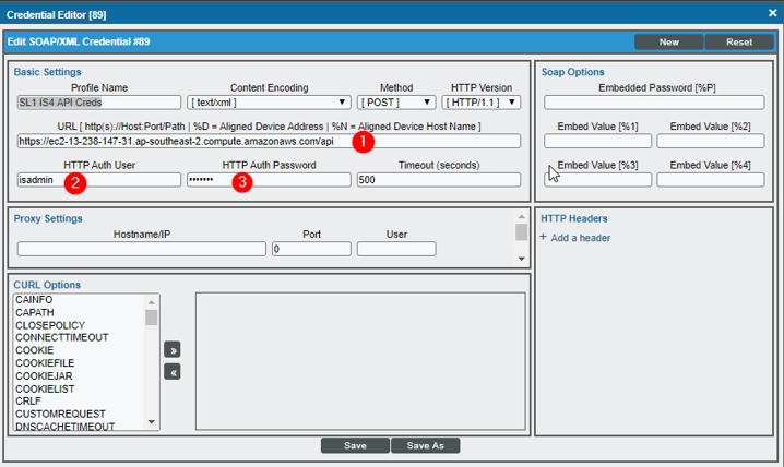

You will need to create a credential in Skylar One that allows Skylar One to communicate with CSM. The "Cherwell Integration" PowerPack includes the Skylar One IS4 API Creds credential, which you can use as a template to create this credential.

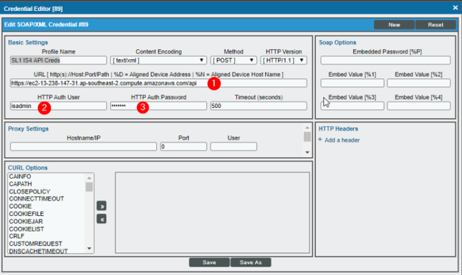

To create the Skylar One credential:
  2. Click the wrench icon for the Skylar One IS4 API Creds credential. The Credential Editor modal window appears:
  1. Supply values in the following fields, and the leave the remaining fields at their default settings:
  • URL. Type the URL for the Skylar Automation API, which is the same URL that you used to create the Skylar Automation Credential in the Federation Registration record. You will need to add "/api" to the end of this URL.
  • HTTP Auth User. Type the Skylar Automation username that will authenticate to the Skylar Automation API. This is the same username that you created and configured in the Federation Registration credential.
  • HTTP Auth Password. Type the Skylar Automation password for the Skylar Automation user that will authenticate to the Skylar Automation API. This is the same username that you created and configured in the Federation Registration credential.
  1. Click the Save As button and type a new name for this credential.

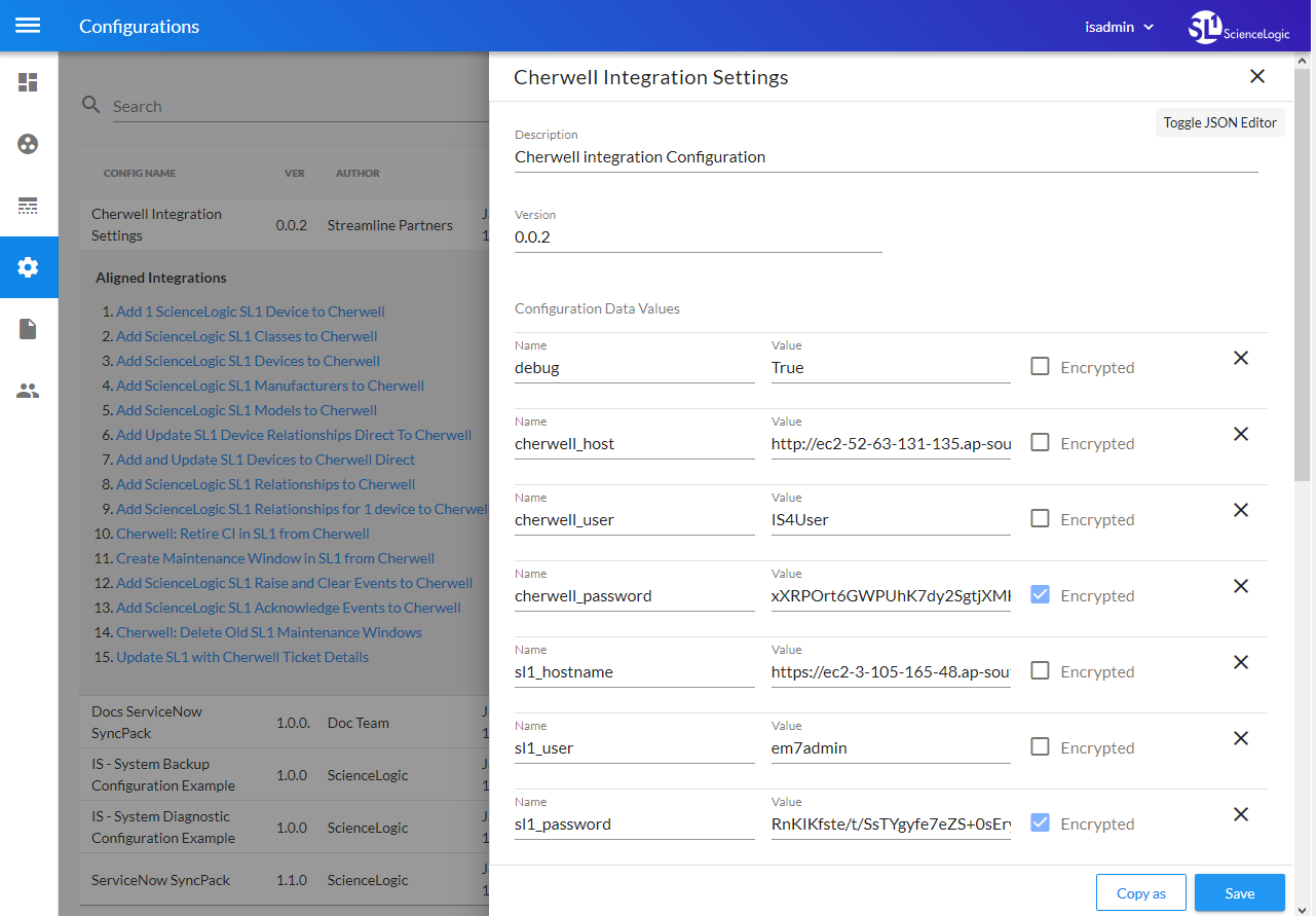

The "Cherwell" SyncPack includes the "Cherwell Integration Settings" (cherwell_config) configuration object, which you can access in the Skylar Automation user interface.
This configuration file contains default name-value pairs for the CSM and Skylar One hosts, the CSM and Skylar One users and passwords, the Skylar Automation host, user, and password, and other keys and values. You can use this configuration file as a template for the configuration objects you need to create and align with the relevant Cherwell applications.
To view the contents of the "Cherwell Integration Settings" (cherwell_config) configuration object, go to the Configurations page of the Skylar Automation user interface and click the Actions button next to the "Cherwell Integration Settings" configuration. The Configuration pane appears:
Adding and Editing Credentials in a Configuration Object
From the Configurations page of the Skylar Automation user interface, you can edit an existing configuration object or create a new configuration object.
For example, you can edit the variables in the "Cherwell Integration Settings" configuration object that came with the SyncPack and then align that configuration object with one or more CSM-related applications. You can also use the Copy As button to make a copy of that configuration object so you can align it with other applications.
The following configuration object variables are required for the "Cherwell" SyncPack:
  • cherwell_host. Type the URL you use to access the Cherwell host. This is the same URL that you used in Creating the Cherwell API Credential.
  • cherwell_user. Type the CSM Login ID that will be used to authenticate to the CSM API. This is the same username that you created in Creating a New User.

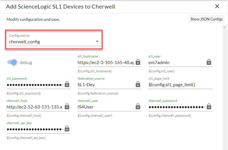

Aligning a Configuration Object with a Skylar Automation Application
For every application in Skylar Automation, you will need to "align" a configuration object to that application to ensure that the application can properly authenticate to CSM. You can align the same configuration object with multiple applications.
To align a configuration object with an application:
  1. In the Skylar Automation user interface, go to the Applications page.
  2. Select the application that you want to align with the configuration object, such as "Add ScienceLogic Skylar One Devices to Cherwell". The Application page for that application appears.
  3. Click Configure. The Configuration pane opens on the right side of the Application page:
    To view a pop-up description of a field on the Configuration pane for an application, hover over the label name for that field.
  4. Select a configuration from the Configuration drop-down to "align" to this application. This step is required for all applications.
    Click Show JSON Configs to view the JSON configuration data for the configuration object. Click Hide JSON Editor again to view the fields instead.
  5. As needed, edit the other configuration values for the application. Press Enter after editing an item to make sure your changes are saved.

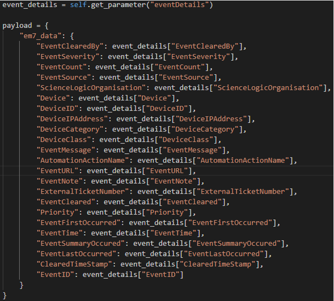

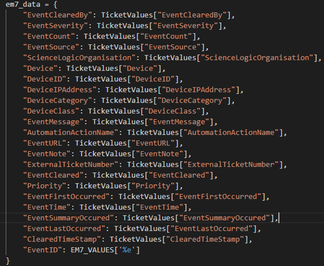

  1. In Skylar One, navigate to the Action Policy Manager page (Registry > Run Book > Action ) and edit the "Cherwell Event IS4 Integration" run book action to enable it to collect the data from Skylar One using the API or some other source.
  2. In the snippet section, update the em7_data dictionary with the key you want the value to be addressed by and the value. For example: "ClassName": EM7_VALUES[%_class_name]:
  3. In the Skylar Automation user interface, navigate to the SyncPacks page, select Cherwell SyncPack, and on the Steps tab select the "Collect and Transform Skylar One RBA Data" step. This step collects the data sent by the run book action and passes it to the "Cherwell: Create Event" step, which processes the Skylar One Event into a Cherwell Event.
  4. Update the payload dictionary in the step with the key and value you added. For example: "ClassName": event_details["ClassName"]

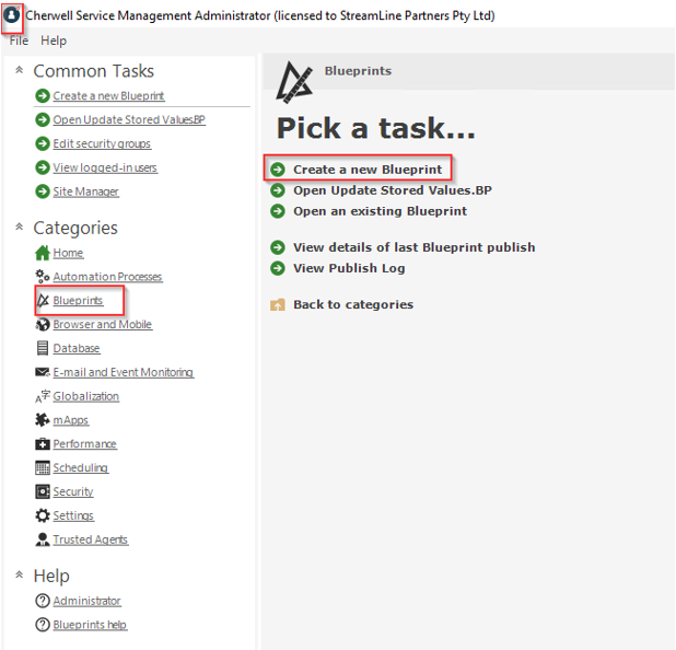

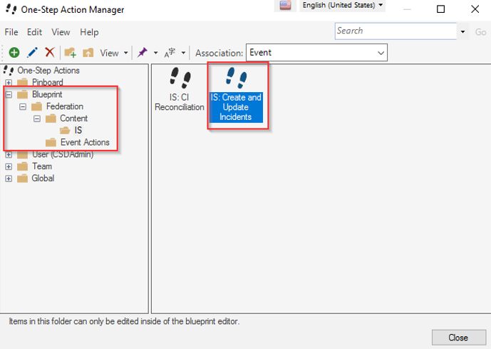

  5. Log in to the CSM Administrator client as an administrator, select Blueprints in the Categories sub-menu on the left, and select Create a new Blueprint:
  6. In the New Blueprint window, select the Managers > One-Step . The One-Step Action Manager window appears:
  7. In the Association drop-down, select Event.

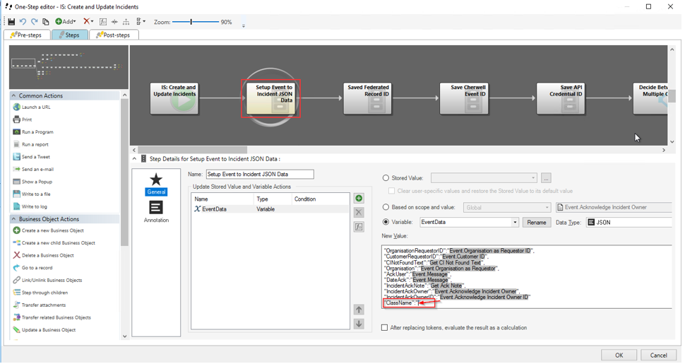

  8. Navigate to the "Blueprint/Federation/Content/IS" folder, right-click the "IS: Create and Update Incidents" One-Step file, and select Edit. The One-Step Editor page appears:
  9. Select the "Setup Event to Incident JSON Data" step so you can append the value you added to the dictionary in step 4 as a key-value pair at the end of the dictionary on this step. For example: "ClassName": event_details["ClassName"]

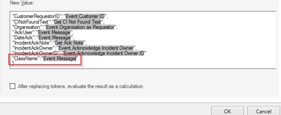

  10. To append the value, type the key for the new value in the New Value field, such as "ClassName".
  11. To add a value to associate with the new key, right-click between the two quotation marks in the entry you made in step 10 in the New Value field and select Message from the pop-up dialog.
  12. Type the value after the new key, such as "ClassName":"Event.Message":
    Event.Message is a reference to the Cherwell Message field in the event. The Message field holds all the information about the Skylar One event in it via the payload you modified in step 4.

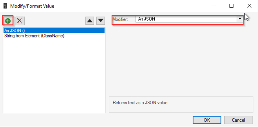

  14. Click + at top left and select As JSON from the Modifier drop-down.
  15. Click + again, select String from Element from the Modifier drop-down, and type the name of the key for the new value you put in the dictionary in step 4, such as ClassName.
  16. Click OK. The relevant value in the dictionary contains the variable next to ClassName.

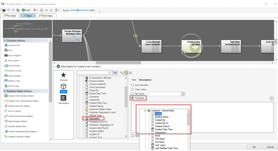

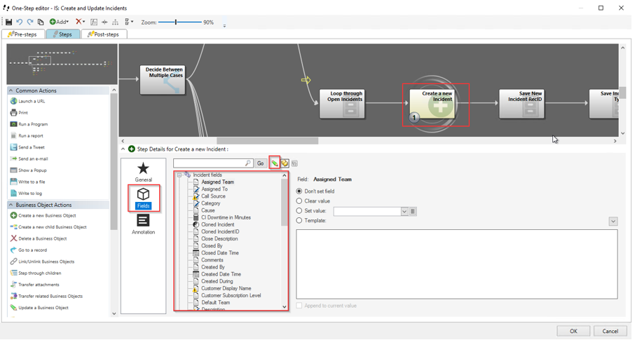

  17. On the One-Step Editor page, select the "Create a new Incident" step and click the Fields tab:
  18. Make sure that the pencil icon is unchecked so you can assign the ClassName variable to any of the fields available in the incident:
  19. For example, if you wanted to add ClassName to the Description field, select Description in the list of fields, select Template, and right-click on the empty text area below to bring up the variable selector.

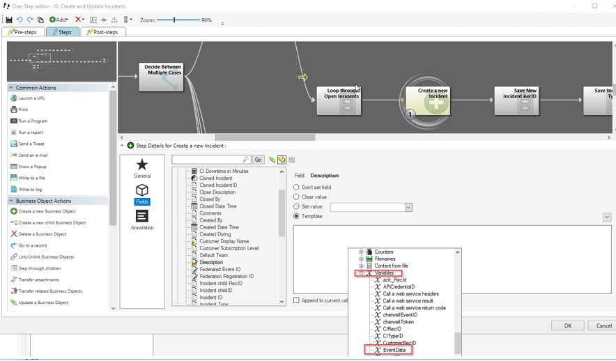

  20. From the variable selector, scroll down to the Variables drop-down and select EventData as this is the variable we assigned to the payload in the "Setup Event to Incident JSON Data" step:
  21. Apply filters to the EventData" variable to assign the relevant value to it from the payload by right-clicking EventData and selecting Modifiers. The Modify/Format Value window appears.
  22. Click +, select String from Element from the Modifier drop-down, and type the name of the key for the new value you appended in the dictionary in the step "Setup Event to Incident JSON Data".
  23. Click OK. The Manage objects page appears.
