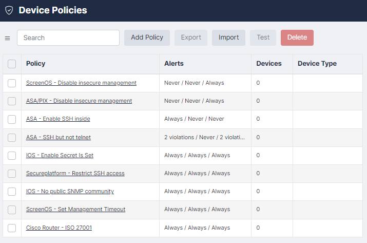

Device Policies
Use the Device Policies page (Compliance > Device Policies) to create configuration compliance policies and assign the policies to devices. Policies are groups of one or more rules. A rule is a pattern that is applied to configurations or device firmware version to test whether the configurations or firmware contain a certain phrase or Regular Expressions, or if they match an existing device template. If the tests fail, a compliance violation is triggered and an email alert is sent to the device owner.
Configuration Policies can be configured for devices that have a text configuration file or a TGZ archive of text configuration files.

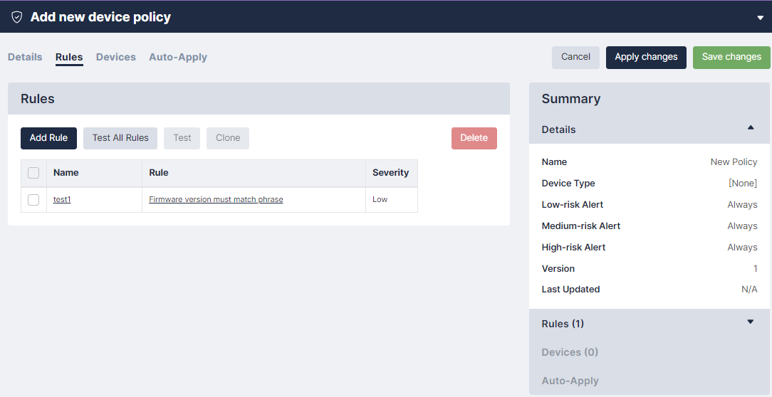

Rules Tab

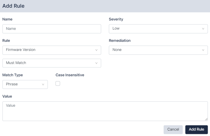

Click Add rule located in the Rules tab of the Add new device policy page to define and add a rule to a policy. Once a rule is defined, it can be edited, removed, cloned, or tested against an existing backup using the appropriate buttons. When finished, click Save Changes.
Supply values in the following fields:
  • Rule Name. A label that is used to identify a rule in a report or email.
  • Rule Type. Whether the rule applies to a configuration, software version, runtime command, or the output of a scheduled action.
  • Requirement. Select whether the rule Must Match or Must Not Match from the drop-down field.
  • Match Type. Phrase, Regular Expressions, Lua function, device, or device templates. The Phrase match type matches any (case sensitive) number of characters, including multi-line. The Regex match type (see Regular Expressions) takes a Perl-flavoured regular expression, and applies it to the whole configuration, or firmware string.
  • Severity. Select an alert level of None, Low, Medium, High, or Critical.
  • Remediation Type. Select a remediation type of None, Manual, Automatic, or Command. For more information, see Remediation.

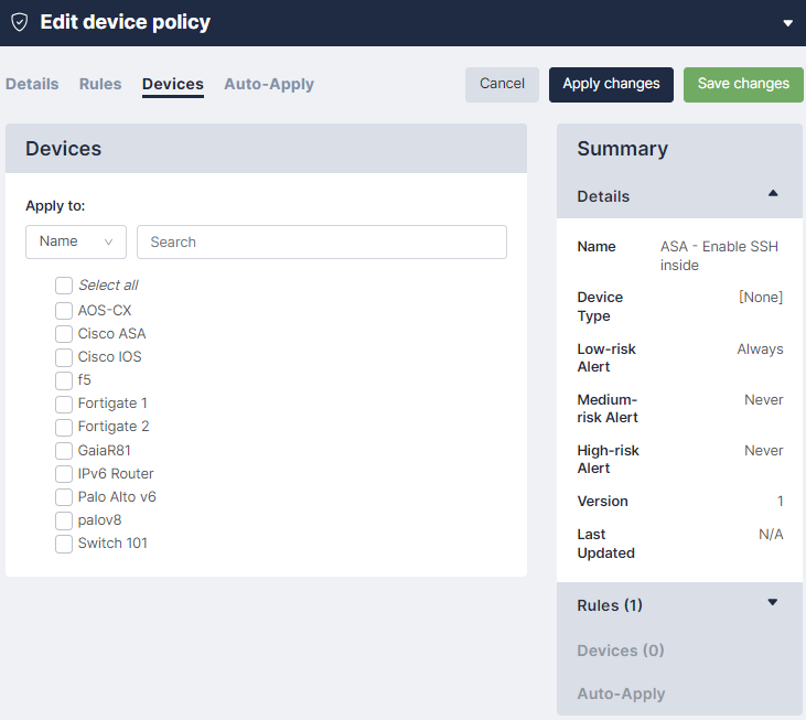

Devices Tab
Each policy can be assigned to, or removed from devices by selecting the relevant checkbox. Alternatively, this can be done from individual devices in the Devices tab on the Edit Device policy page.

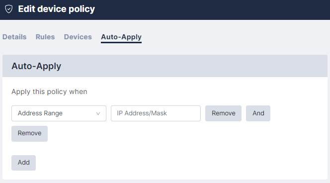

When your policy is assigned to, or removed from, its devices, you can choose when their policies should be applied. To apply the policies:
  1. Go to the Auto-Apply tab (Compliance > Device Policies > your policy) . Choose an option from the Apply this policy when drop-down field to refine when a policy should be applied to a device that was created with Use Auto-Applied Rules

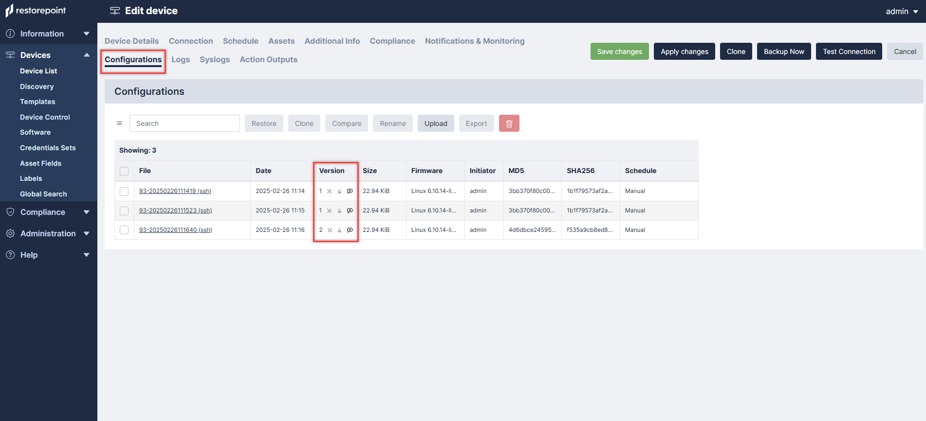

Configuration Baselines
Configuration versions can be marked as Baseline by the checkmark symbol in the Version column of the Configurations tab. When you perform subsequent backups, an email notification is sent if the configuration differs from a baseline version. This allows you to quickly check if the current configuration is an approved version.
  1. Go to the Devices page and select your device. The Edit Device page appears.
  2. Click the Configurations tab and set theBaseline toggle (), Retention toggle (), or Comment () for your device in the Version column.
    • Baseline toggle on. If you use the (), your configuration version will be marked as Baseline.
    • Baseline toggle off. If you toggle to (), your configuration is not Baseline.
Configuration Baseline on the Configurations tab.
