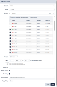

Scheduled Actions
Actions can be scheduled and run automatically.
To add a new schedule to your device:
  1. Go to the Device Control (Devices > Device Control) page and click on the Schedule tab. Next, click the New Schedule button. The New Schedule modal appears.
    Device Schedule  New Schedule modal
  • Action. Choose a option from the Actions drop-down field.
  • Devices. Select the device or devices on which to perform the action
  • Perform. Select a frequency, either Scheduled or Once At and a time interval or date.
  • Keep Last. Set the number of recent output runs you want to retain. Type "1" to keep all outputs from the most recent run. Type "2" to keep the outputs from the last two runs, and so on.
  • Merge Output. Select the Merge Output checkbox if you want to merge the output.
  • Email Log. Select the Email Log check box and enter an email address if you want to email the output of an action after execution.
  • Apply Policy. (Optional) Select a compliance policy to apply to the output of the action. For more information, see Device Policies.
All logs are now stored in Skylar Compliance.
  1. Click Save and the updated Scheduled Action page appears.

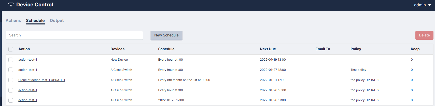

Image of the Skylar Compliance Device Control page
Scheduled Actions cannot contain parameters.
